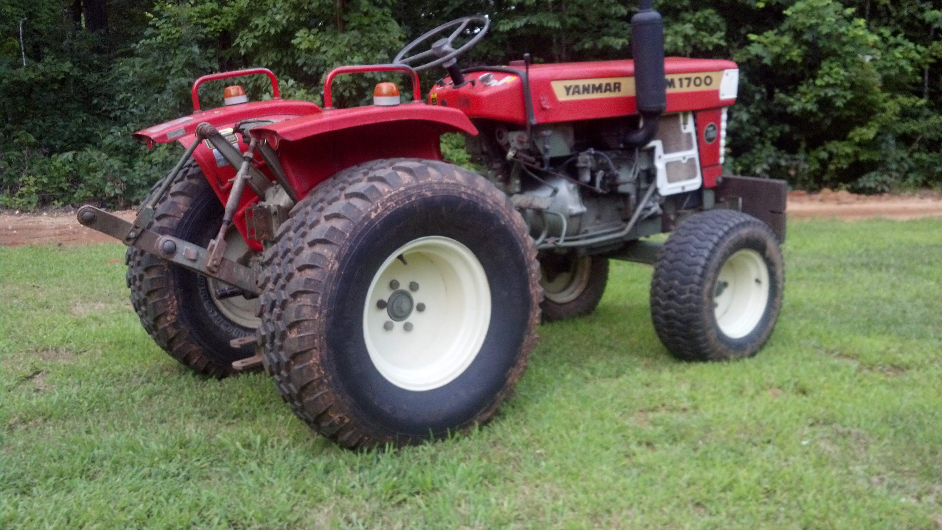

Well I bought myself ym1700 today, has brand new set of turfs from hoye on it. Thing looks mint condition, 1042 hours..I like it a lot.
One thing..running it around the yard not working it the temp reads 205 degrees with temp gun..isn't that a bit high, it looks like its all antifreeze in it. I plan to replace with mostly water. I read the ones without water pump run a bit hotter?

Here's temp observations I posted long ago for my YM240 (YM2000). Readings were made with a HF infrared thermometer just after the engine had been working hard:
This was right after mowing:
140 degrees on the bottom of the oil pan, 165 at the lower block, and 195 near the injectors, at the upper radiator hose fitting, and at the radiator upper tank. The radiator lower tank was below 100.
I think Thermosyphon runs hotter than pumped but still, your sounds hot. Maybe a clogged radiator?

I don't know if that temperature is too warm or not. The specification for the coolant to water ratio is different than usual, 1:3, so if the coolant has more antifreeze in it than should be there, that may explain a little higher temperature.

Nice Ym1700 :thumbsup: The rear tires are not exactly full turf, But do look like would be easier on the grass yet still aggressive enough for traction in soil ;)
The temp is a bit high for normal, mine has a temp gauge that shows 190* under heavy load use, about 185* for normal use,
Short of having to drain the complete system, Try reducing the antifreeze ratio and add in a bit more water,
and always keep the radiator clean,

My YM1700 would run about that hot under heavy load, even with the recommended antifreeze mix. The nice thing about the thermosiphon system is that it pumps faster as the temperature gets higher (because the difference between hot and cold sides is greater.) I was concerned about it running so hot, but I never had a problem related to that.

If you can get the temp to lower, if by only a few degree by adding the water, but still not down to 190* or so, You might need a new rad cap, I remember when a combination of partly clogged radiator and Old Cap caused the radiator of my 1700 to swell and blow at the upper seam, The cap wasn't opening to allow the water to overflow into the catch-bottle,
I don't think 205* will ruin an engine, But It should be running a bit cooler,
Not sure about the logic in having the water being hotter helps to pump quicker is better,:confused: It needs to pump/perk slow enough to be cooled by air pulled through the radiator, right!
I think this can become a confusing theory, By one theory if water moves Too slowly it will allow it to become hotter,
The longer it stays in an engine the hotter the water becomes,.... However! by another theory if the water moves too quickly through the cooling system, Via: "Radiator" the radiator cannot do its job to cool the water down,
So it becomes a bit more science to get the adequate circulation on our Thermosyphon-systems.

Back flushed radiator and cleaned out the fins on radiator. Put mostly distilled water back in and tractor is running 170 at top near injectora after about 20 minutes running. Lower block temps are in 145 range. Guess that is OK..a lot of muddy water ran out during back flush.

Well I thought I fixed the temp issue but apparently not. Pulling a 4' bush hog the 1700 ran up to 235 degrees..I idled down and it cooled off..I cleaned and flushed the radiator good last weekend..probably only used 10% antifreeze and 90% distilled water..ran it at 2000 rpm in L gear 3...what's going on here !
Should I do the water pump mod? If so what pump fits, ym2000?
/ couldnt resist, ym1700 #19
I think you need not only a standard YM2000 pump but also a special adapter kit to attach it to. Hoye etc should have everything.
But - patching around a problem won't solve it. That tractor is rated to run at full load indefinitely without overheating or other sign of stress. If it won't, something still doesn't meet spec.
