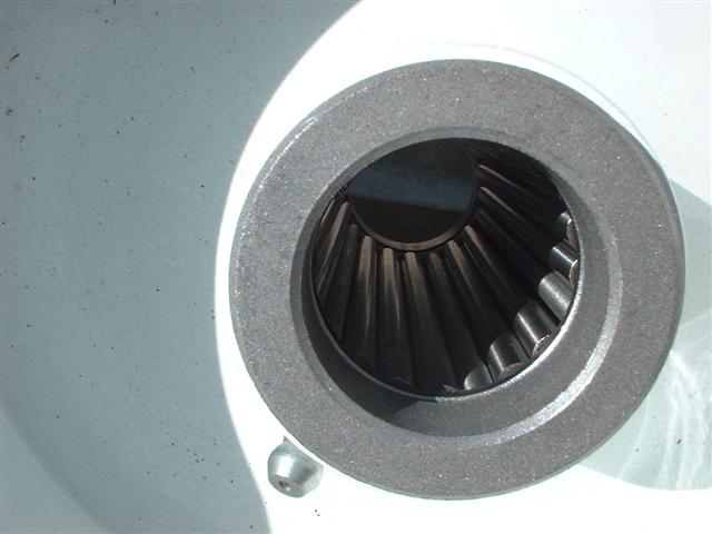

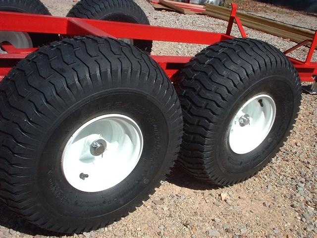

The wheels that were supplied have roller bearings on the inside that are greaseable with a zerk fitting. The interesting thing about this type of bearing is that the rollers are directly on the axle shaft. The axle shaft is just soft colled rolled steel. They should have a least been case hardened.
It waits to be seen, but I do not think that it will take long before the soft axles will have grooves in them.

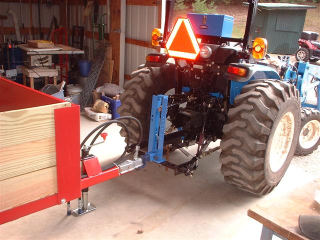

I removed the plates for the pin hitch and added a 2.0 inch ball coupler. It makes the trailer more versatile for me. The pic shows the back of my LS-3040 with hitch setup.
