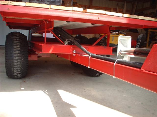

One thing I did was to install a piece of metal roofing under the center floor boards. Just barely visible in this pic. I wanted to help keep sand/dirt from falling thru the floor board cracks onto the extended cylinder shaft.

After you replaced your wheel bearings, what was the condition of the soft axles?

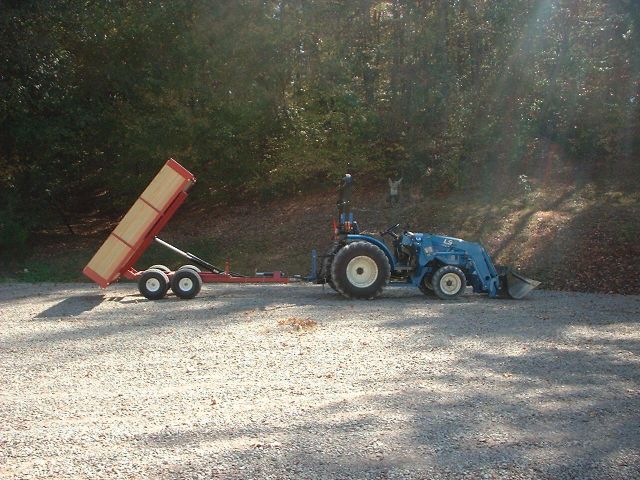

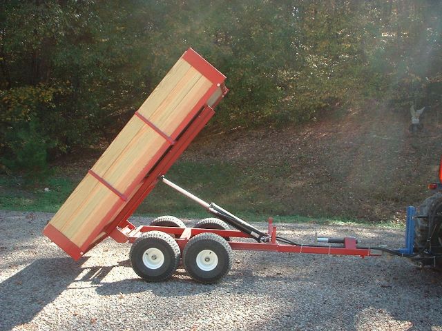

I moved 20 tons of chert this weekend and the trailer worked out good. Eventually I will change the sliding back gate to a swing style for better dump and run control. I did manage to get one flat tire, plugged it and continued hauling.
Since I had the tire off for plugging, I was able to inspect the soft axle for wear. The bottom of the axle showed some polishing but no grooves were present. I greased the axles twice a day to help keep out any grit since there are no seals.
