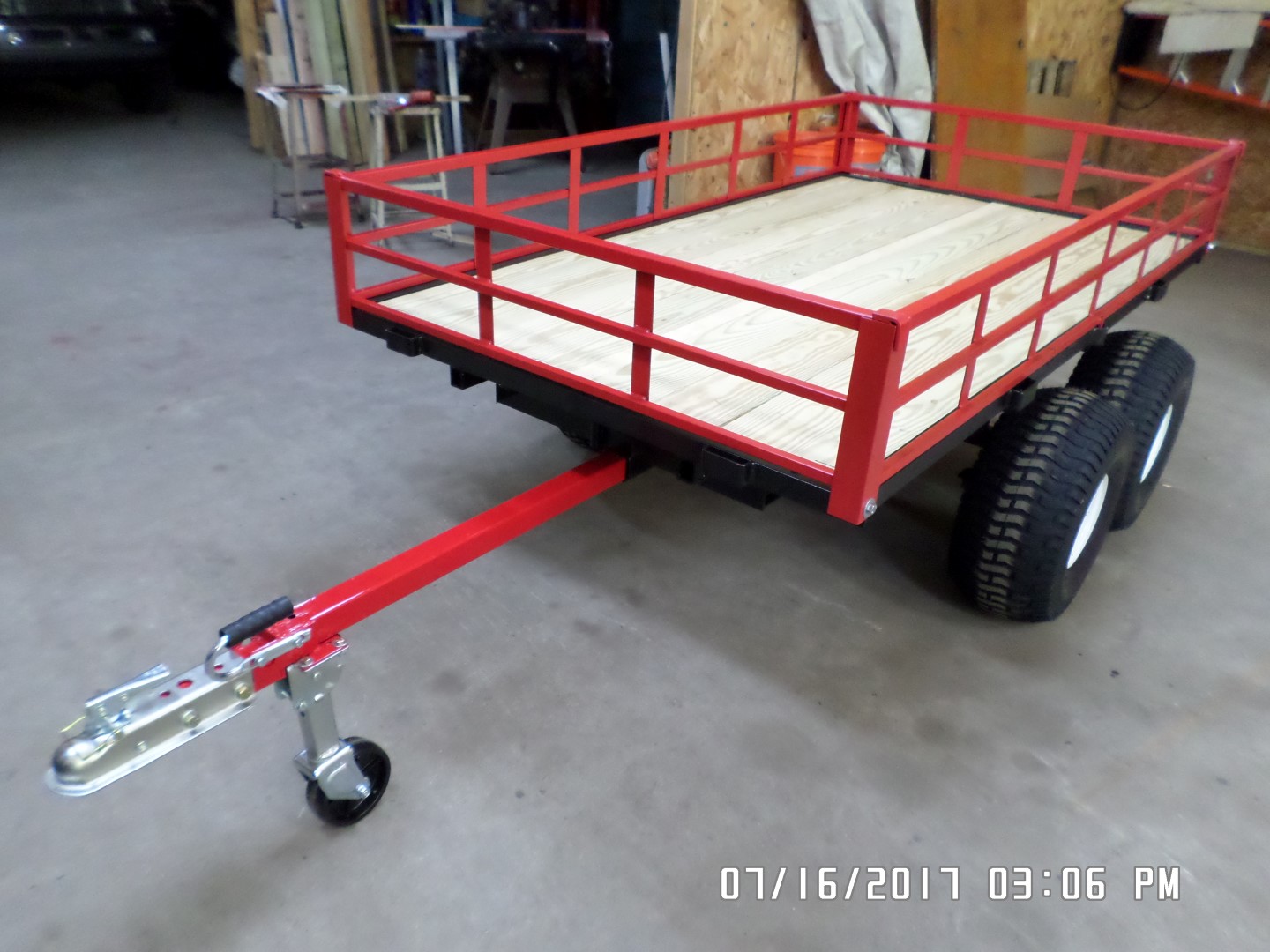

Jerry, Seems you are asking about the 2x2x.250 angle we added just behind the walking beam support plates. This runs 90 degrees from the trailers front/back. This was to help the sub-frame for bowing while under heavy loads and no relation to us using the trailers dump feature.
This trailer was really under built in my book.
Howdy..!!! I just ordered a trailer similar to yours, but has a 7' X 4' bed with metal sides [ 7740UTV-BR ]. I stumbled onto your rebuild, and will mod mine / paint it before I assemble it, My one question is why you added the brace on the side of the channel iron between the walking beam plate and the vertical angle the bed pivot on??? [ picture #1 of the frame upside down ] I do not plan on making mine tilt and will fix the bed in place. Basically going to use mine for firewood/out in the woods behind a tractor....
That's why I thought i would do your mods before putting mine together when I bought it. I don't need it to carry dirt/gravel, just firewood. I have been looking at these type trailers on and off for several years when I stumbled on your rebuild posts. Bought me one to help gather/haul wood/ etc... All YOUR fault...... :) I might put a hyd cyl in mine to dump someday, but don't see me needing it right now.

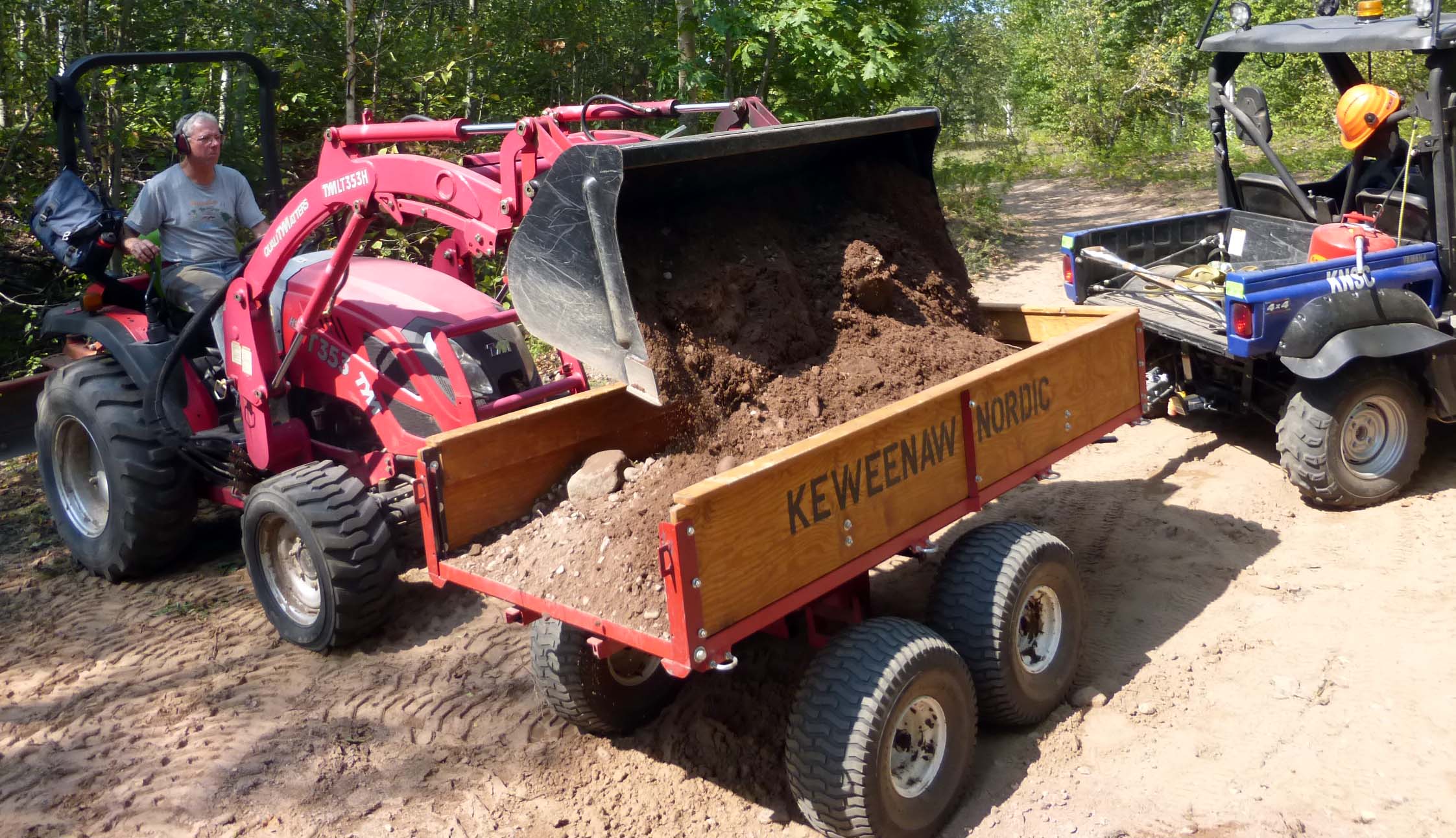

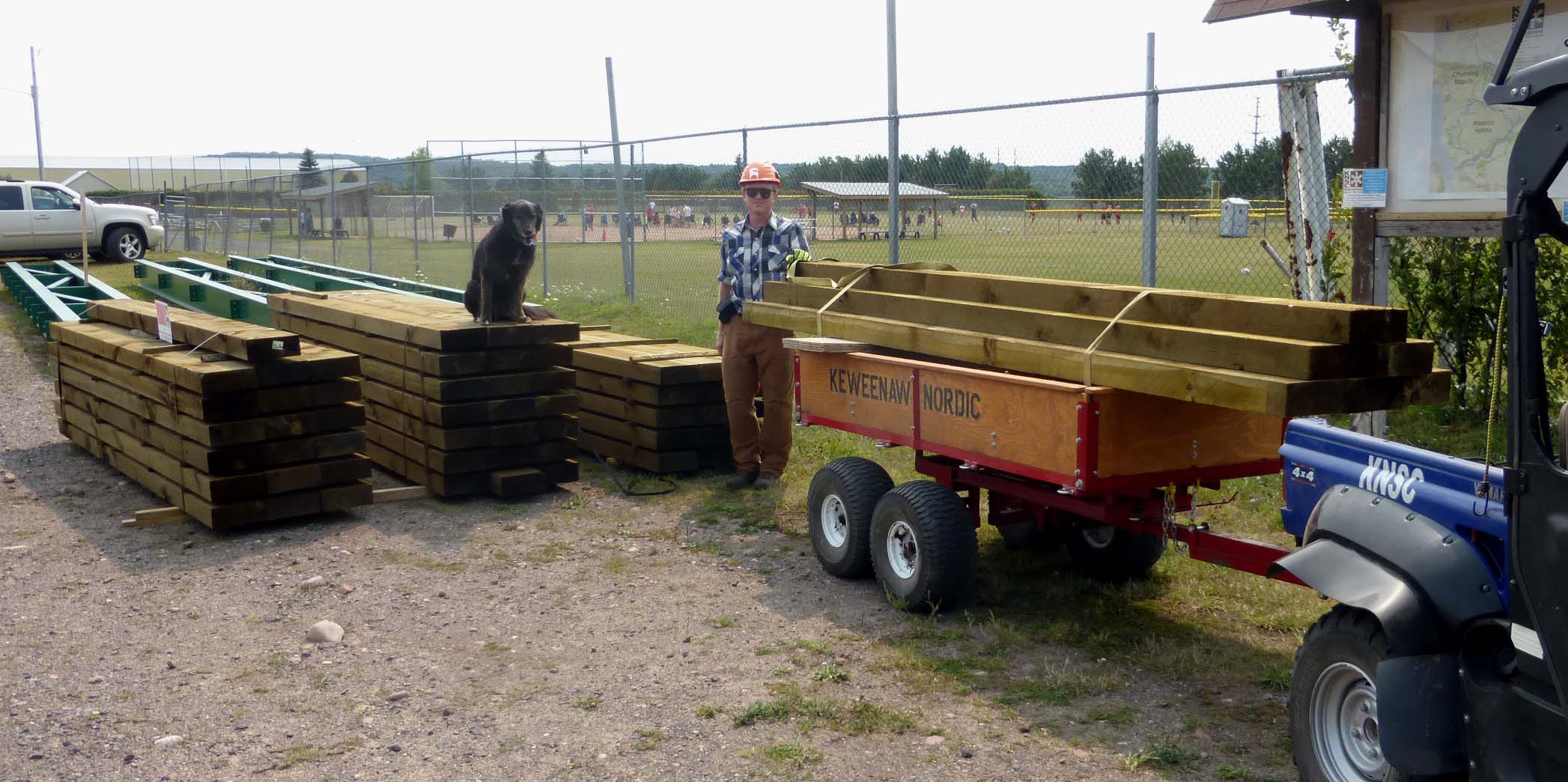

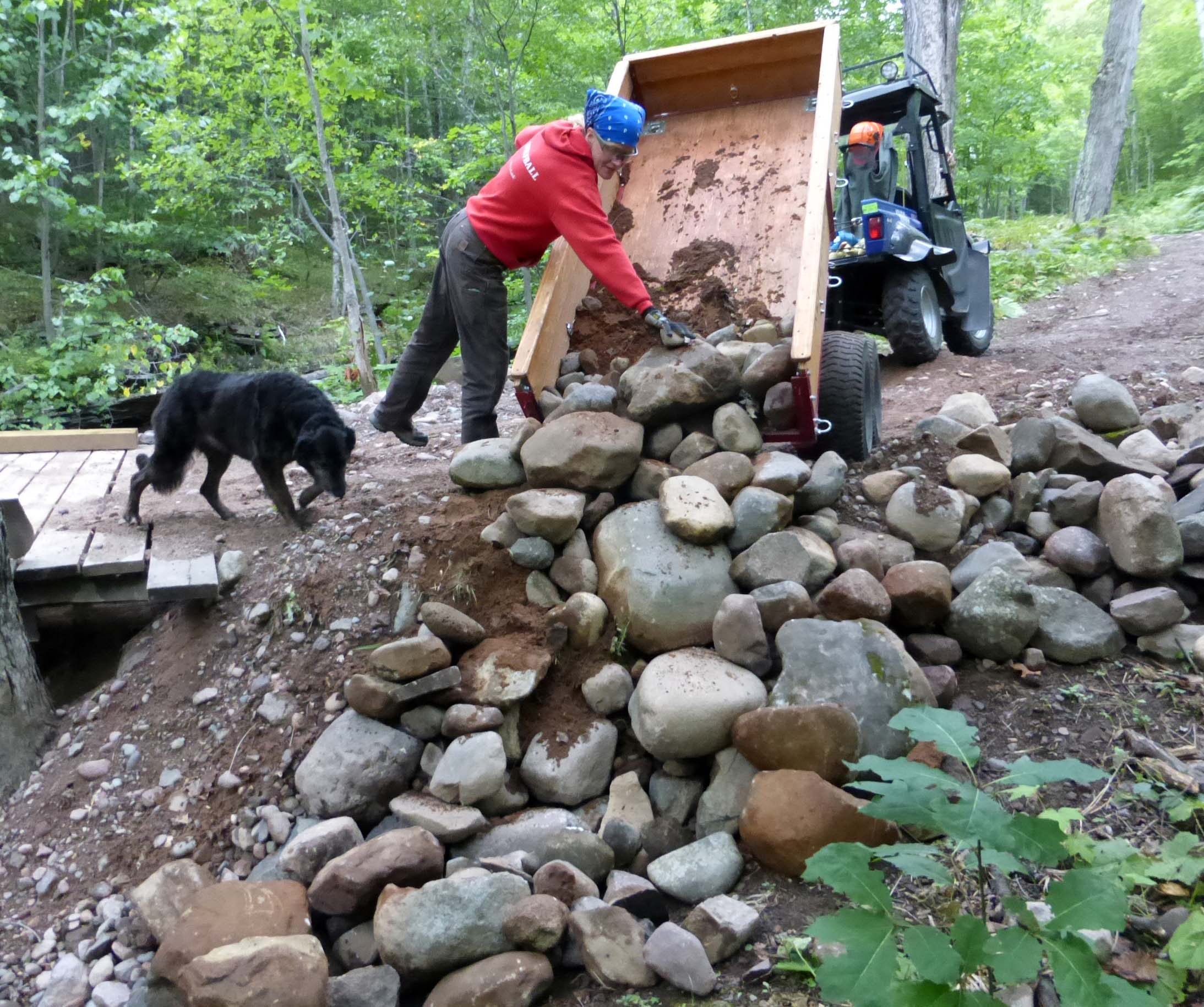

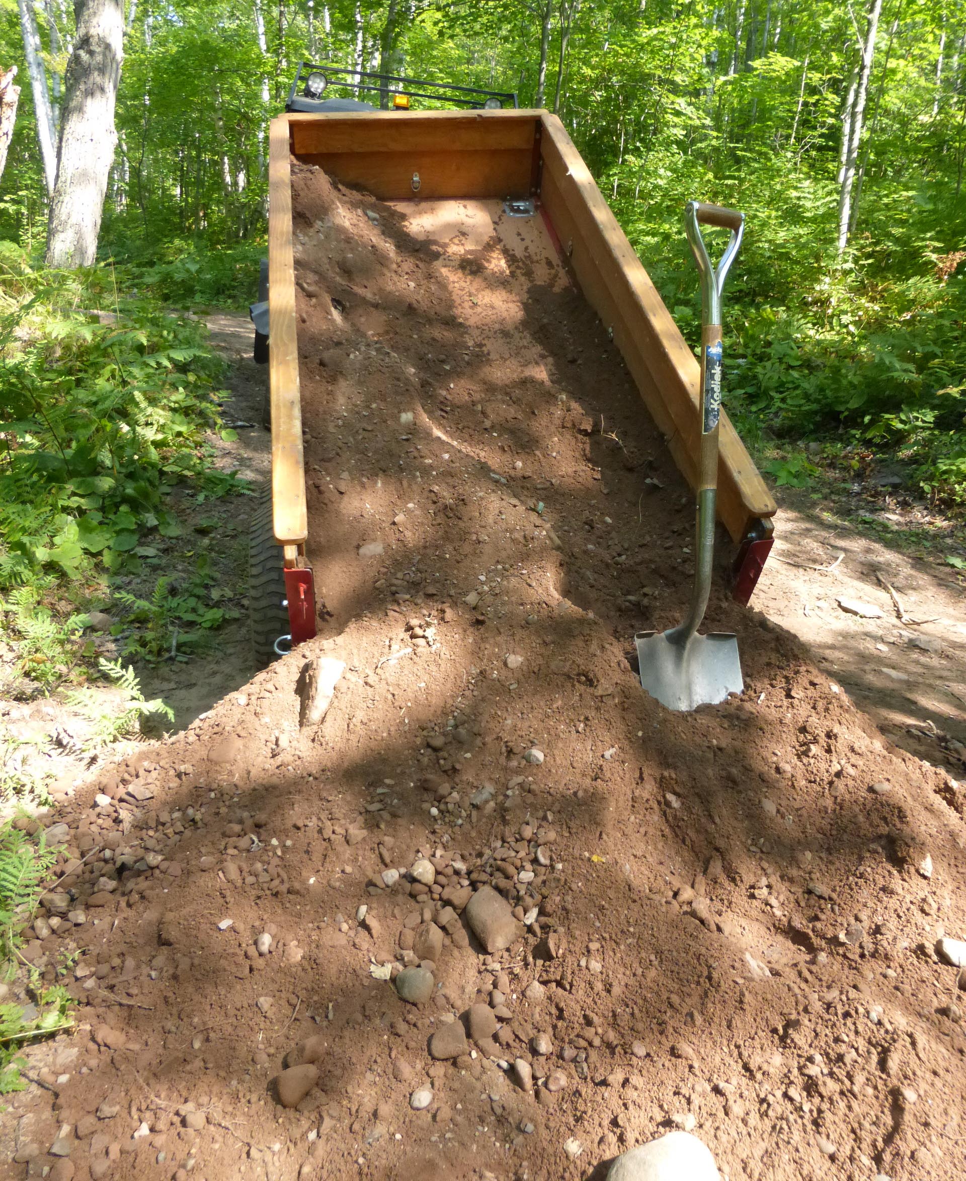

We used a tractor, but the problem is the tractor loads at the pit, so its not at the dump location. I'll attach a few photos of no real value.:)

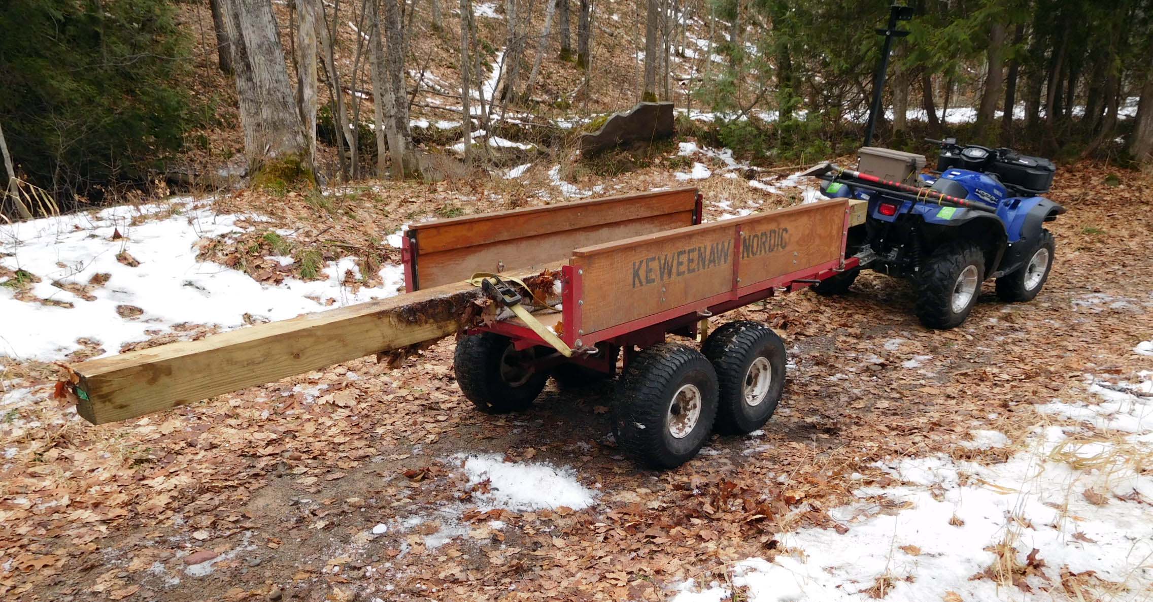

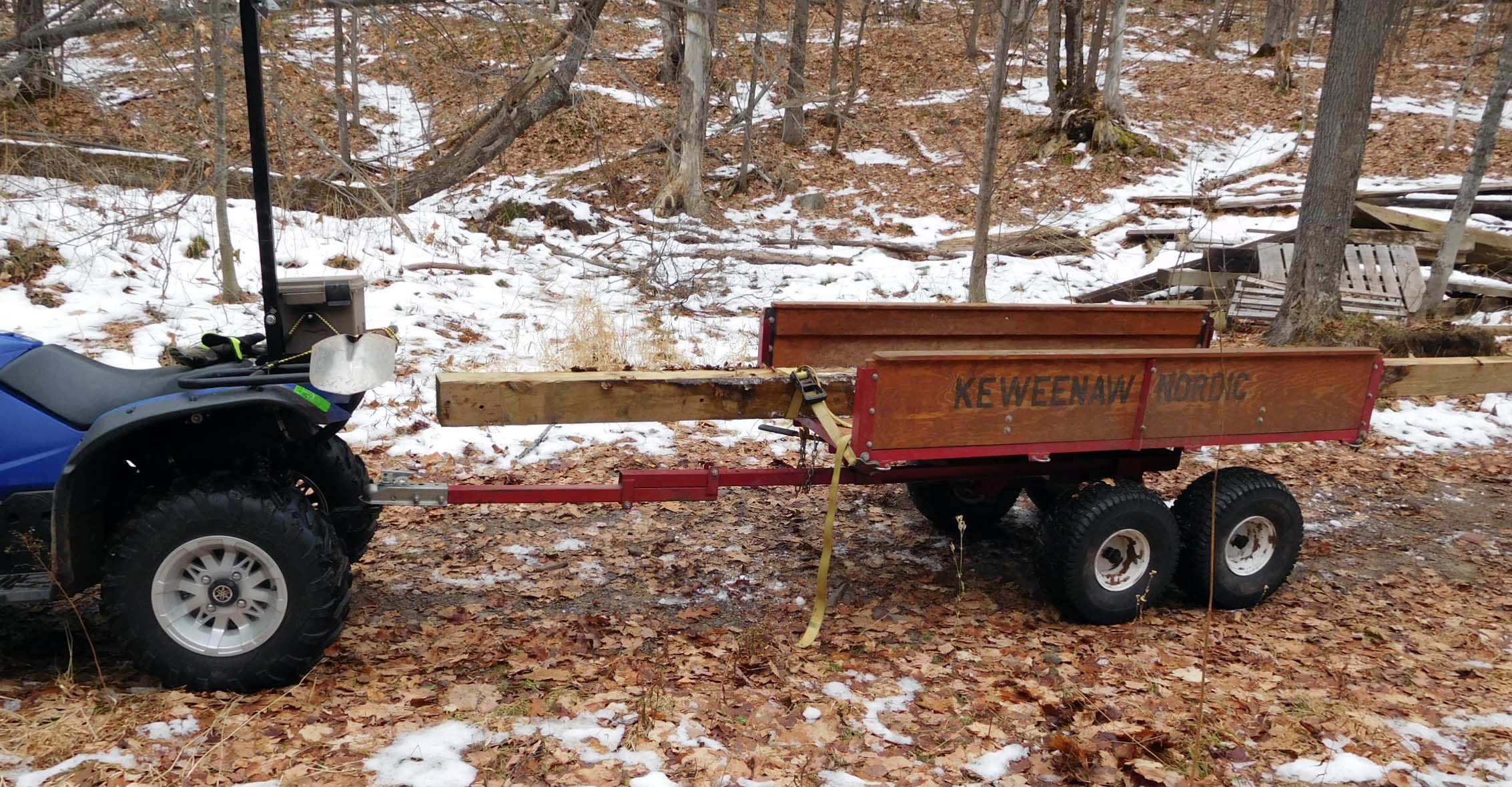

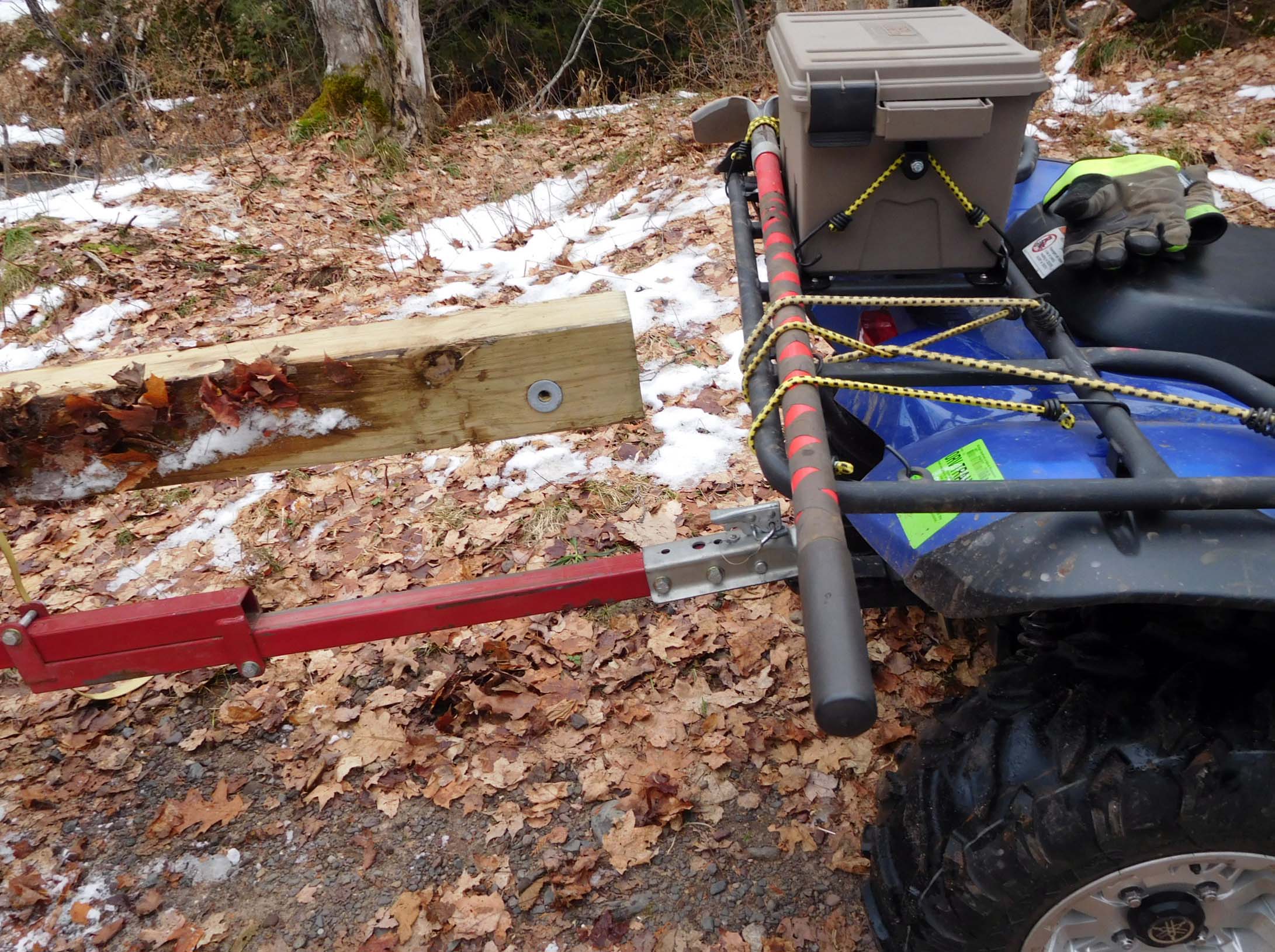

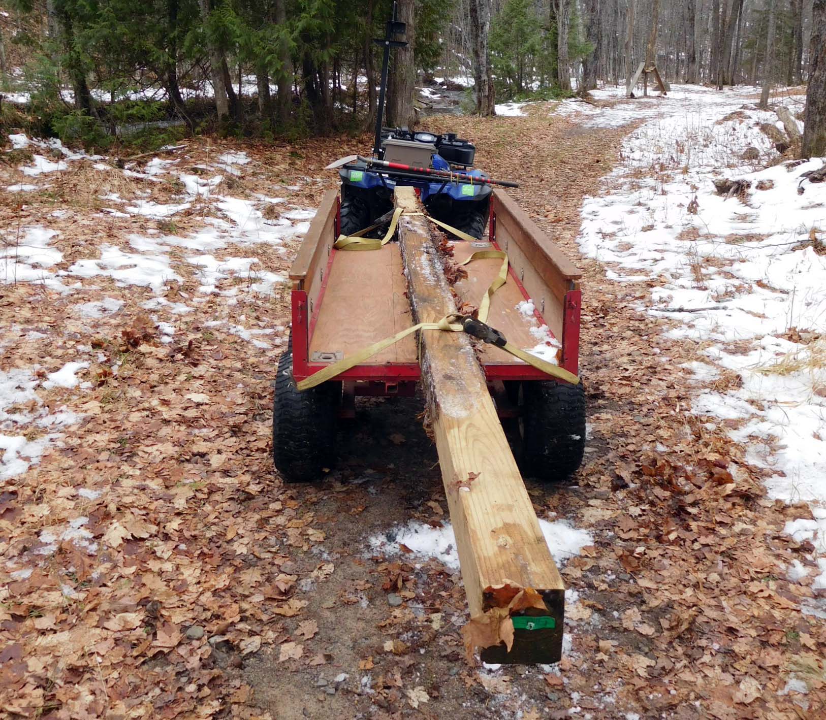

Here is a few recent photos of this trailer in action. This is a 16ft 6x6 we retrieved today and you may note, the trailer hitch was modified so as to be lengthened for hauling longer pieces like this.
