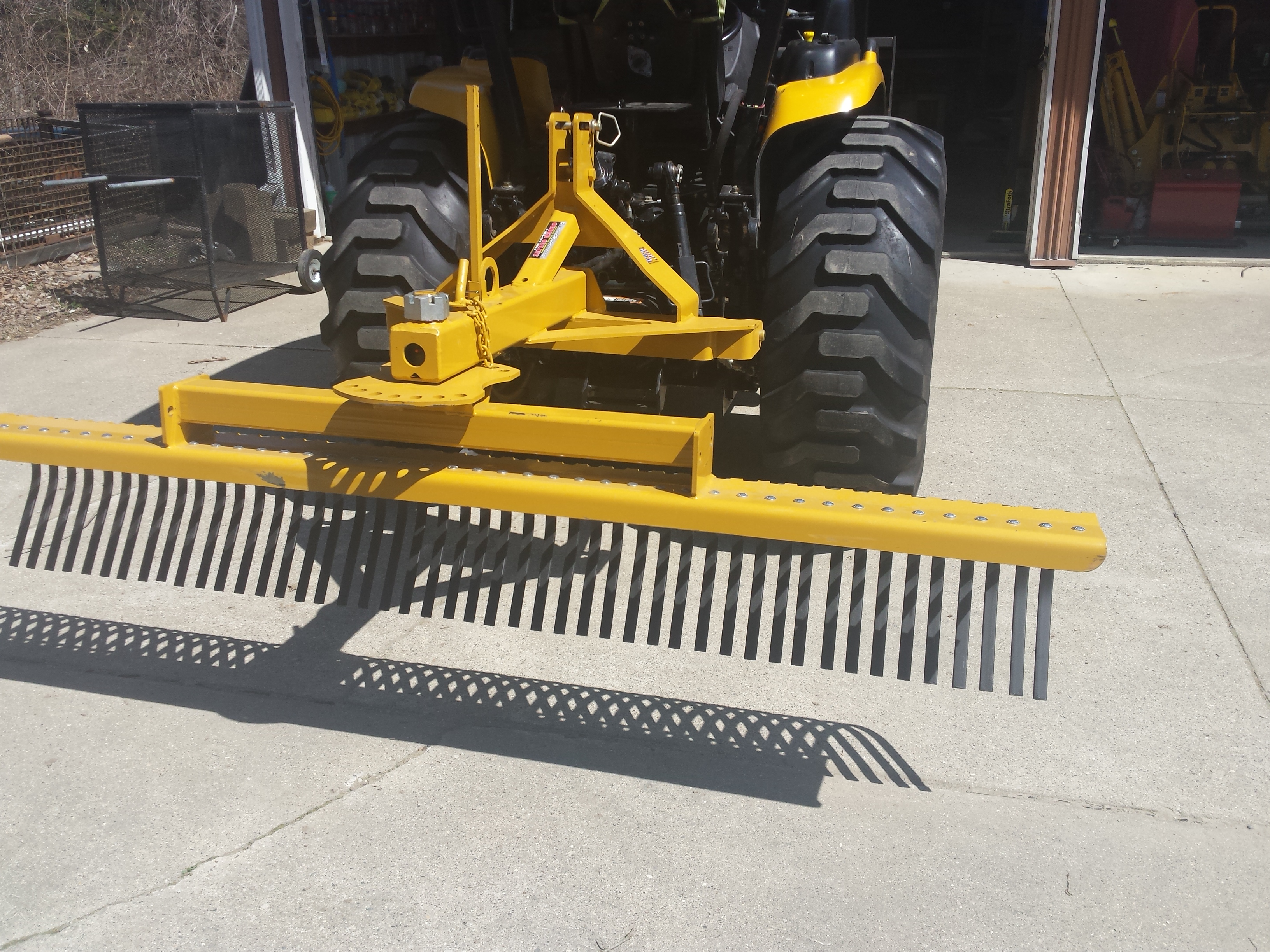

I made the choice.I just ordered from Travis at ETA an 84" extreme duty landscape rake. Buy right, buy once.
   / County Line(TSC) Landscape rake #27

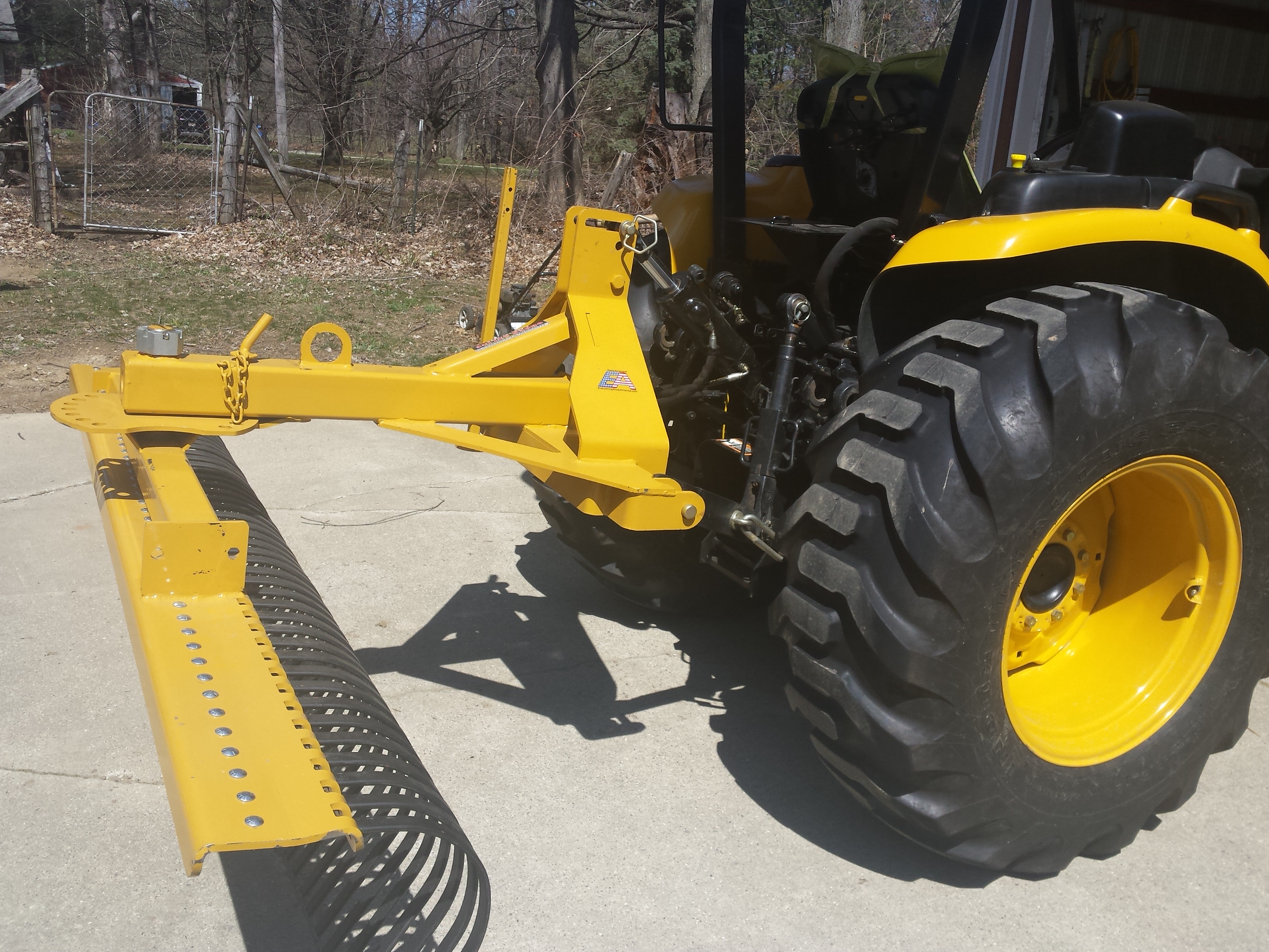

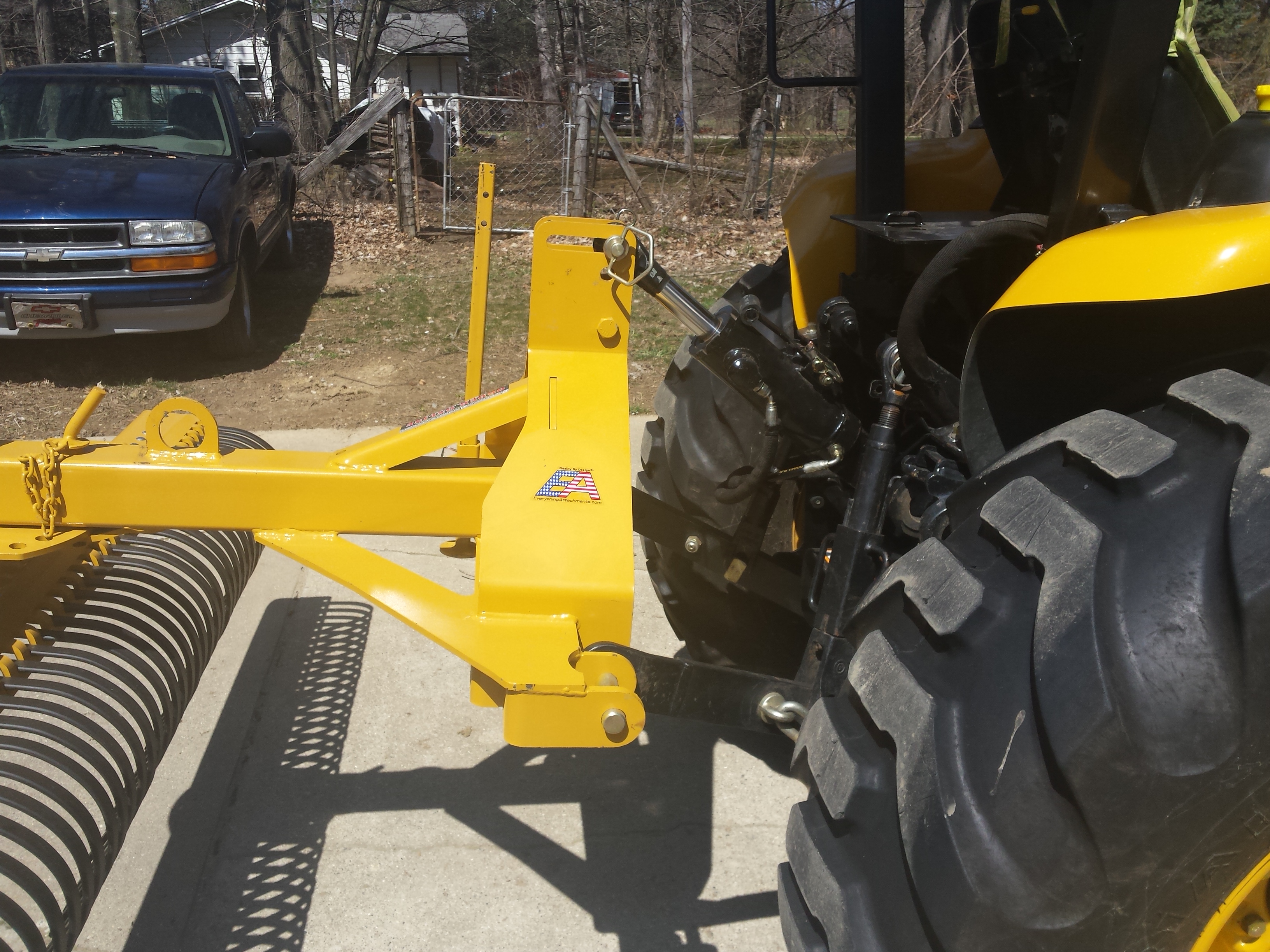

I'm waiting for the ground to dry up, so I can give my ETA Landscape Rake a work-out

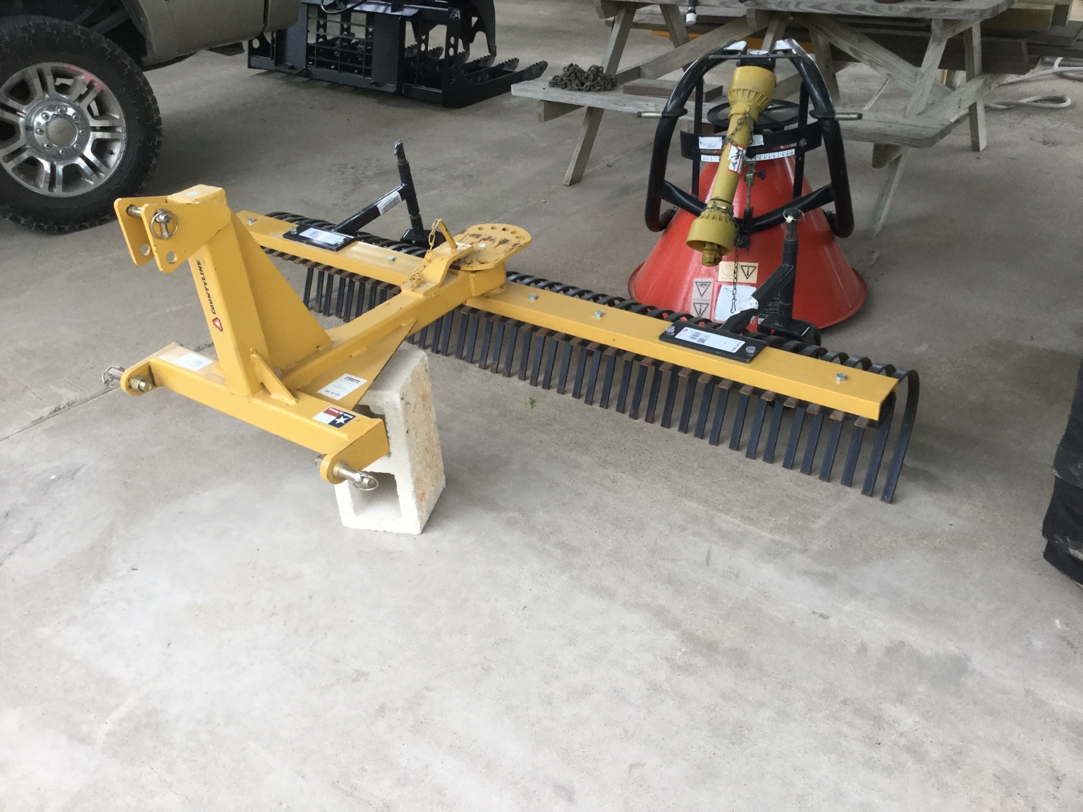

   / County Line(TSC) Landscape rake #29
I should of took the advice of those who know. I used my County line landscape rake today the first time. 3 passes in and it tweaked. The metal fatigued and cracked right at the pivot point. I was moving very slow and gentle in med gear so not to apply too much force. I just returned it to TSC and the manager said she has never seen that and offered to get another. I asked what if it happens again and she said she would take it back again. That is great customer service but I do not want to take the chance again. Either they are junk or the steel was defective. Either way I am looking for a good used one or maybe an ETA new one.

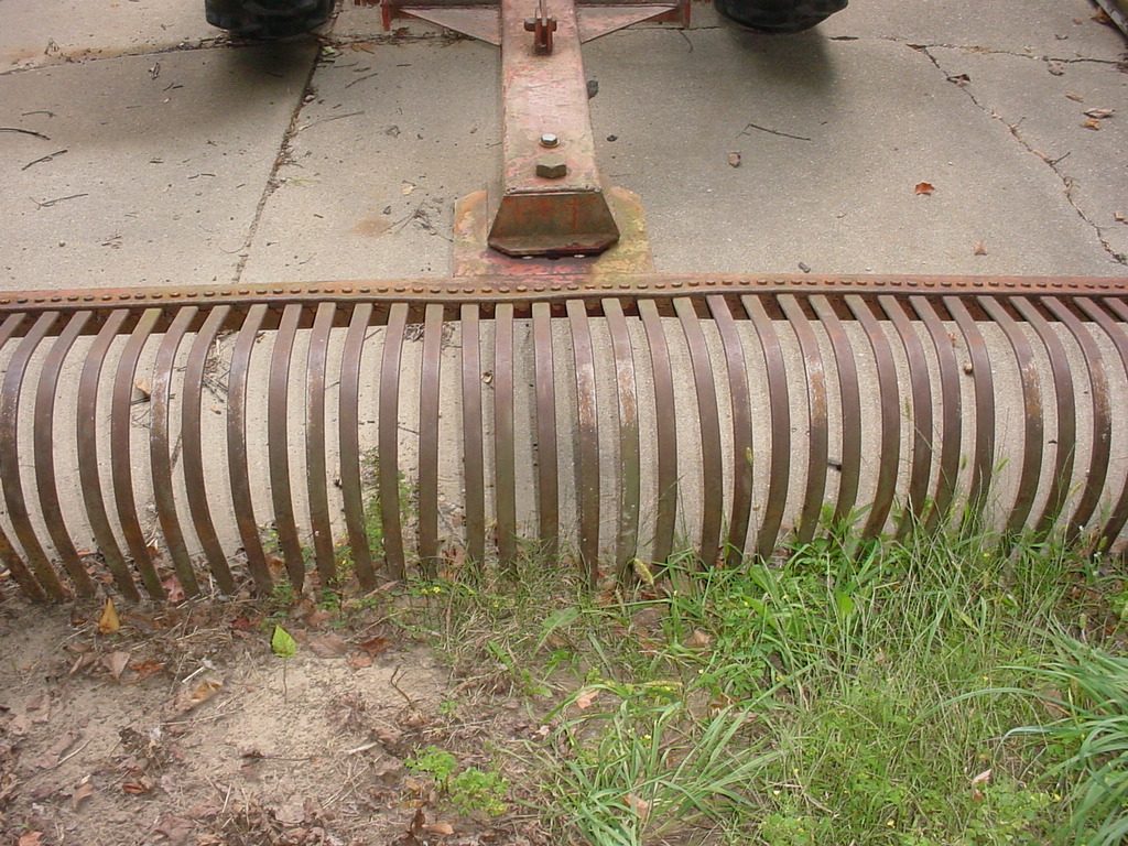

Been there done that. My 1st landscape rake was a used one. No brand or name on the rake it twisted like a pretzel. Here is a photo before I used the landscape rake. Wish I had taken a photo after I used it. I sold it at my yard sale for $50.

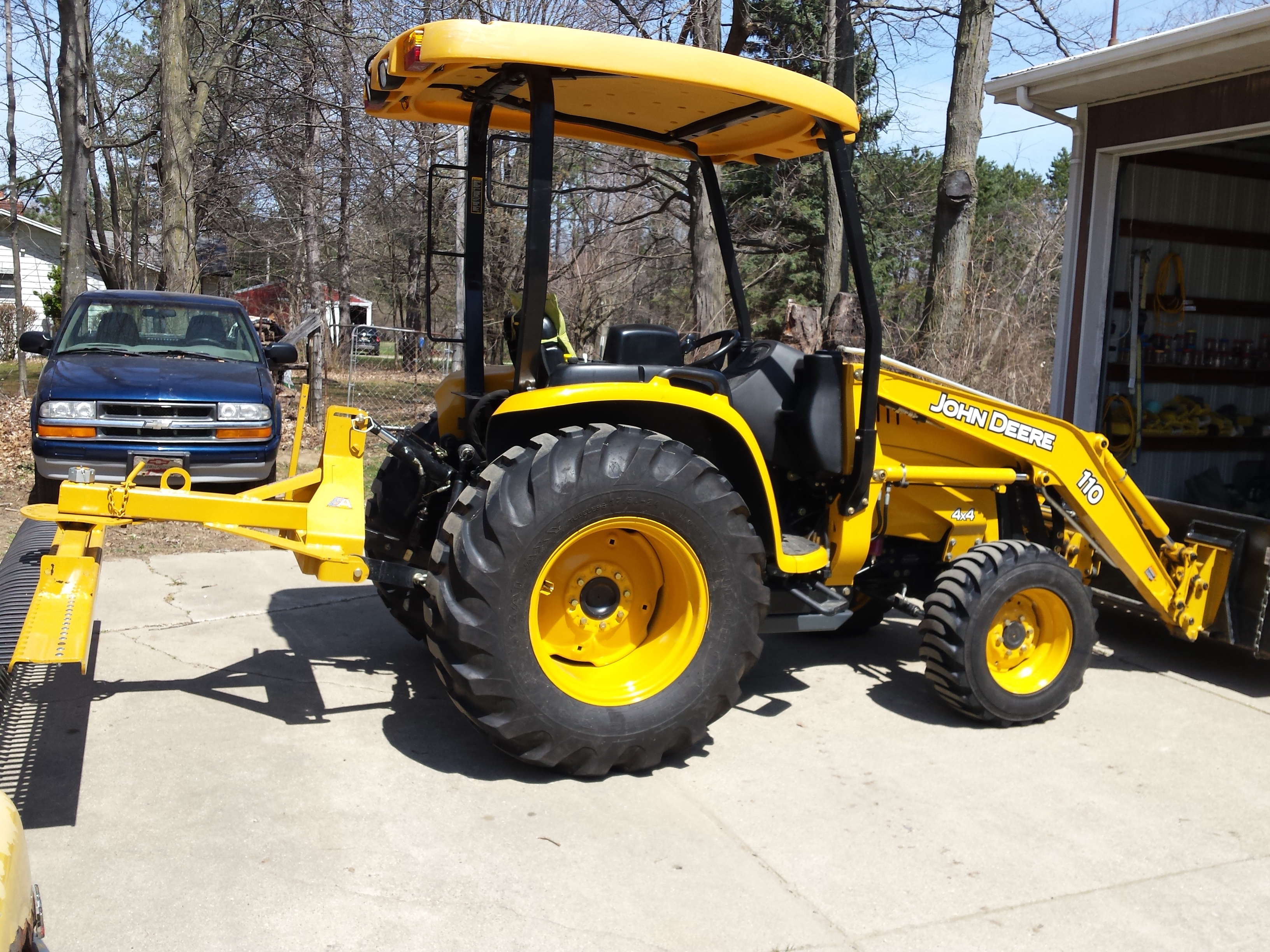

Looks like an almost perfect color match! The landscape rake isn't too shabby either. :thumbsup:
Travis
I agree it's a nice color match.

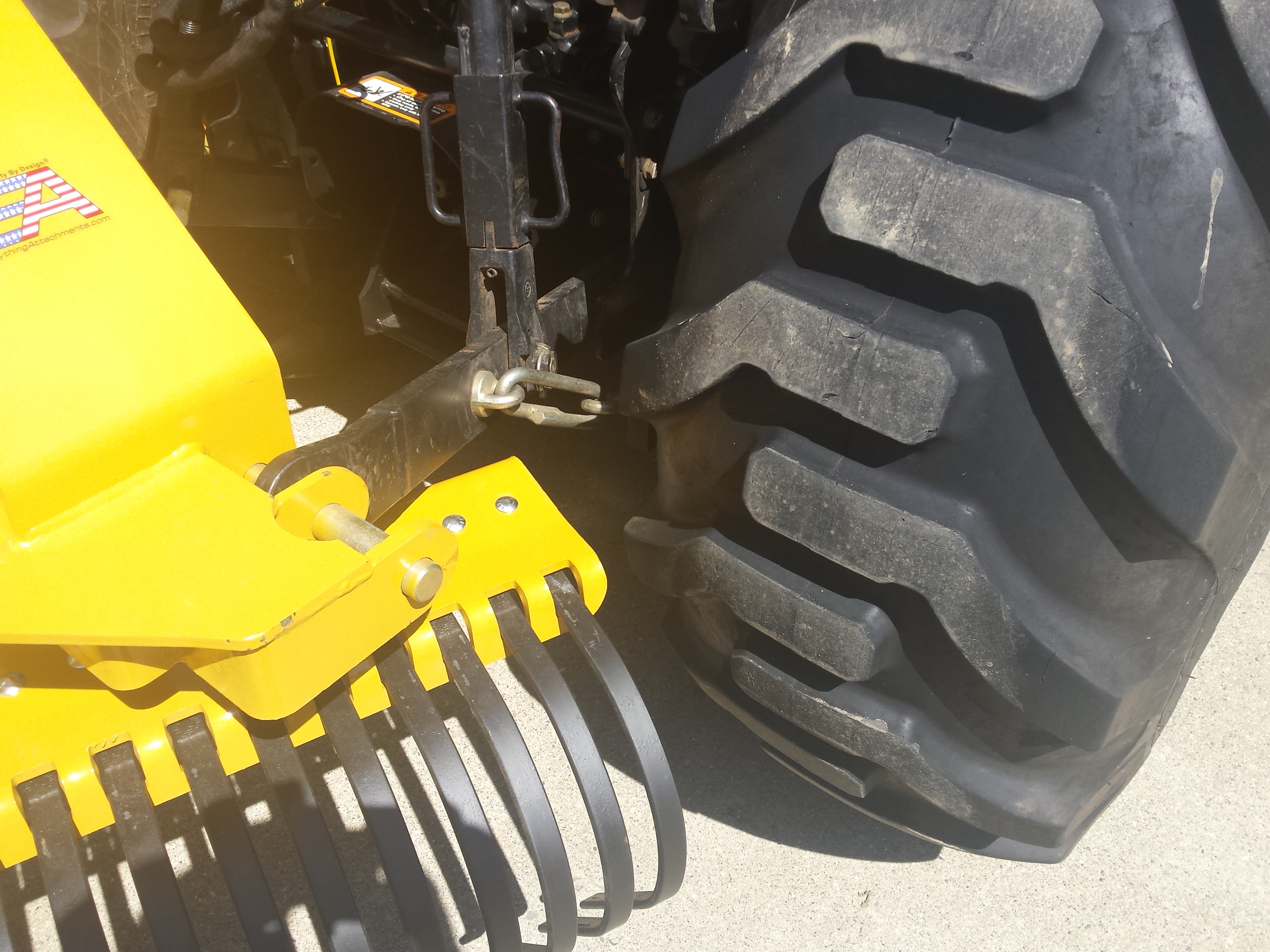

Travis, When I order the rake the sales rep did not think there would be a problem reversing the directions of the rake, he was right I have about a 2'' clearance.
