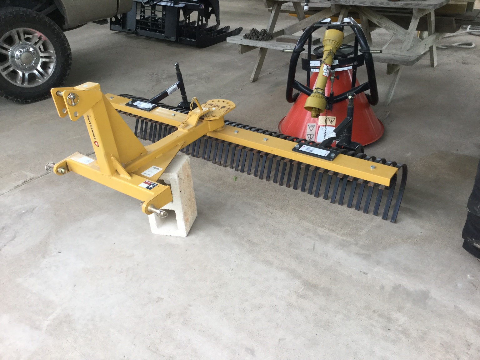

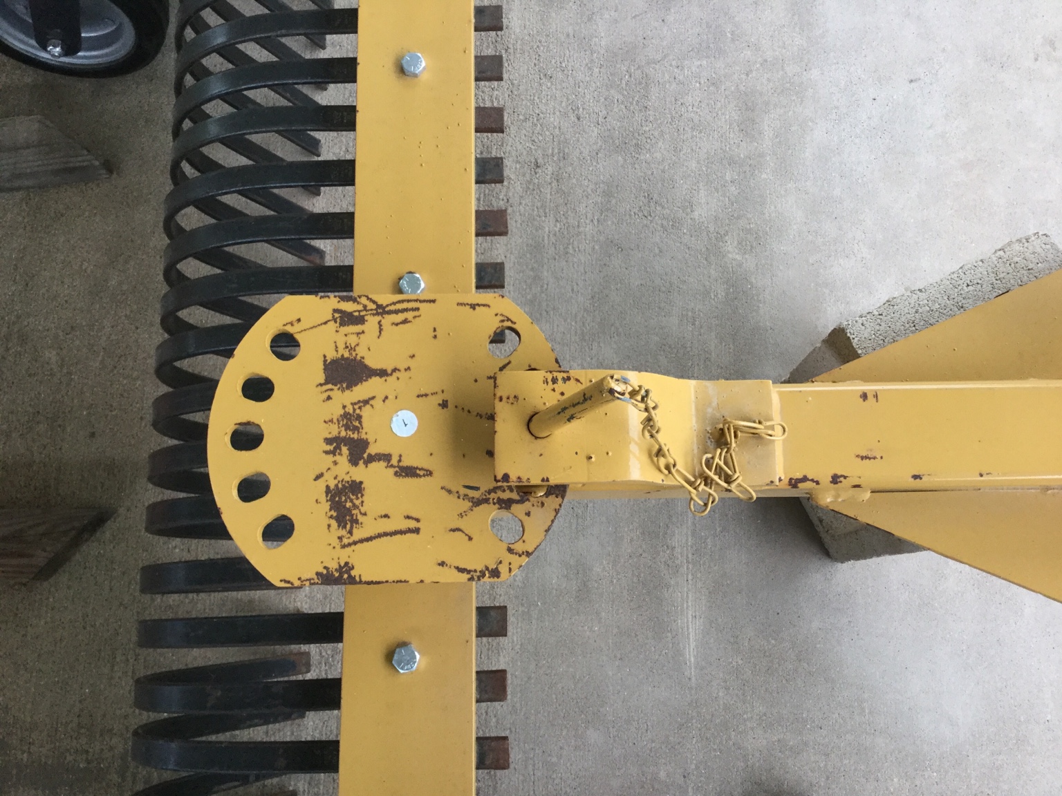

I should of took the advice of those who know. I used my County line landscape rake today the first time. 3 passes in and it tweaked. The metal fatigued and cracked right at the pivot point. I was moving very slow and gentle in med gear so not to apply too much force. I just returned it to TSC and the manager said she has never seen that and offered to get another. I asked what if it happens again and she said she would take it back again. That is great customer service but I do not want to take the chance again. Either they are junk or the steel was defective. Either way I am looking for a good used one or maybe an ETA new one.
I've figured out that if the top link connection is like this one, it built by Tarter.
If it's like mine, it's built by Behlen in Columbus, Nebraska.
I think the Behlen is a bit sturdier?

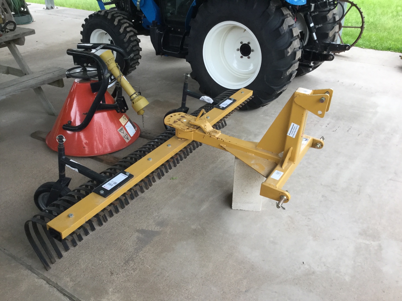

that looks just like my back blade but with a rake on it.
   / County Line(TSC) Landscape rake #47
I own the 1 in the 2nd photo & it has a Tarter label on it. Seems Tarter has a few different designs of rakes. There is definitely a difference in durability. I purchased mine from Southern States & it is a beast.
