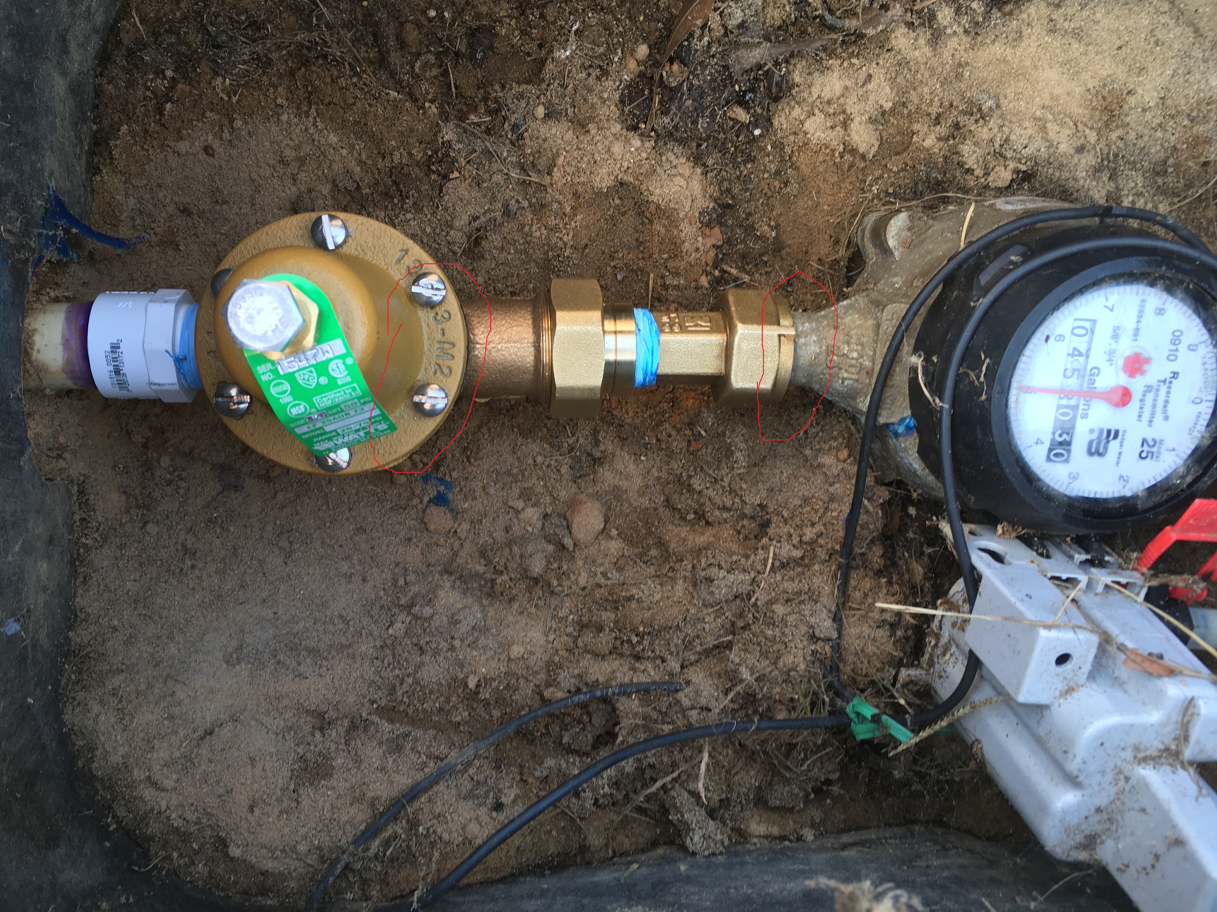

I have lived in the house for 15 years, initially pressure was around 75psi, based on my new found knowledge, I guess the increase occurred when they built a new water tower a few years back. I like high water pressure, if I don't feel sand-blasted after a shower I'm disappointed. Recent events including the main line that supplies water for the whole community busting 3 times this year and more time on my hands made me decide to try and find a resolution.
It will be easy enough to install a regulator however I also wanted to replace the thin walled pvc off the meter the knuckle-headed builder installed which makes it a much bigger project. Always amazes me what contractors will do to save a few dollars.
Thanks for all the great information!
Gravity from the upper level of a water tower is what determines the static pressure in a system. But the pump or pump(s) still have to produce that much pressure, as the water doesn't magically appear in the water tower. When the pump(s) start there is usually a tremendous pressure surge in the line, and then the pressure is usually considerably higher until the tower is full and the pump turns off. When the pump turns off there is usually another surge of pressure as the check valve(s) slam and bounce the pressure back to the system. Only when the supply pumps are off and the transient pressure waves have died down will you finally see the static pressure from the tower(s).
A pressure reducing valve and an expansion tank will take care of the surges on the house side. But the public water supply people will have to figure out how to eliminate water hammer from the pumps cycling on and off to stop breaking the mains. Pumps cycling on and off to fill water towers is one of the biggest causes of water hammer and main line breaks.
A 1" PRV will probably be fine, but you don't want to oversize a PRV very much. While a PRV that is too small can restrict the flow and pressure when you are using a lot of water, a PRV that is too large is not open very much (not working in it's sweet spot) when you are using very little water. This will lead to wearing off the seat in the valve and letting it leak high pressure through again.

IMHO, just a Watts regulator is fine. Aren't all the Watts in-line rebuildable and all-brass (or bronze)? The semi-buried one I'm using (3/4") has been perfect in about 6-7 years of service, and it was used when I installed it.
