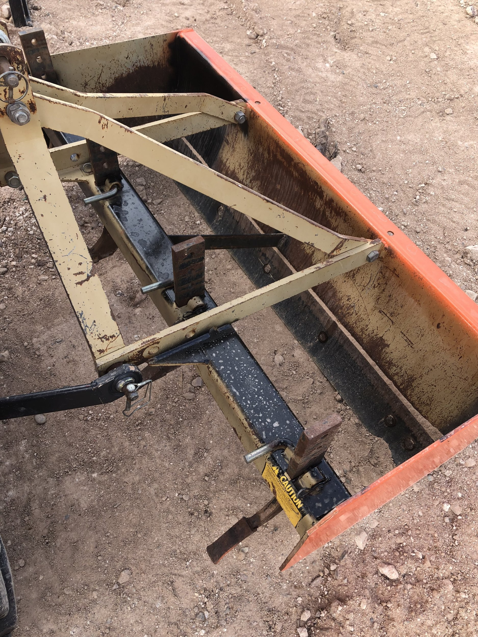

pics straight edge showing after repair ( before was bowed out 3/4" )
bent back using 2 come alongs and then welded some extra triangles at the blade mounts
and a diagonal brace to the moldboard ( not sure why box blades have no support at the moldboard mid span ?
maybe farmers will understand ?
starting paint it will be Kiotish Orange on non wear areas and black at wear areas

My only guess for the mounts on the back is some sort of gauge wheel
   / CountyLine Box Blade??? #43

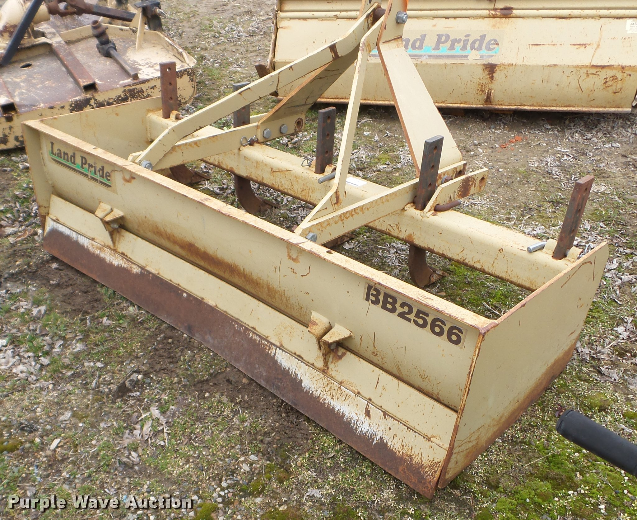

my tabs do not show up well , here is a web image of the only other BoxBlade I have seen with the tabs

   / CountyLine Box Blade??? #44
No I have no clue what they are for, A little larger image.

   / CountyLine Box Blade??? #45
They are for a swinging style tailgate, guessing it was an option or it was removed at some point and changed to a fixed style

   / CountyLine Box Blade??? #46
ok so thanks for the larger image that's definitely being used for a swing mount blade
but not sure if it is a true swing gate or thats an option to use with the fixed rear blade ?
Thanks again for the input gentleman , I don't plan on using those tabs for anything other than maybe dragging some chain link to smooth the drive after the box blade
