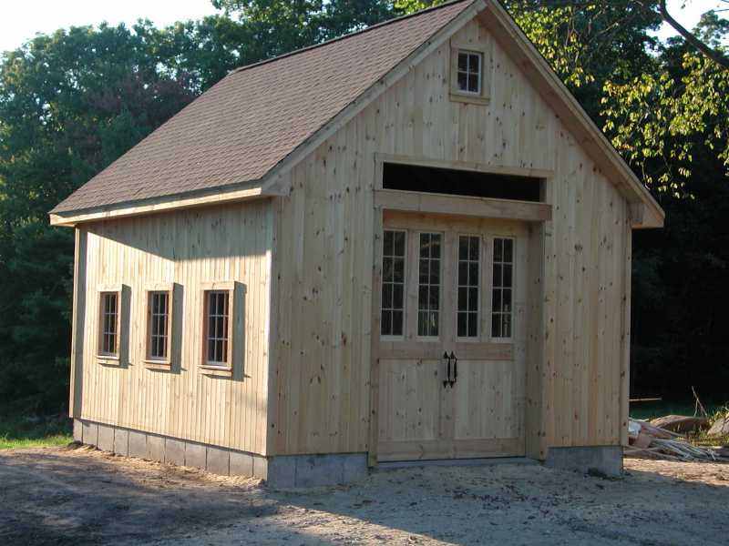

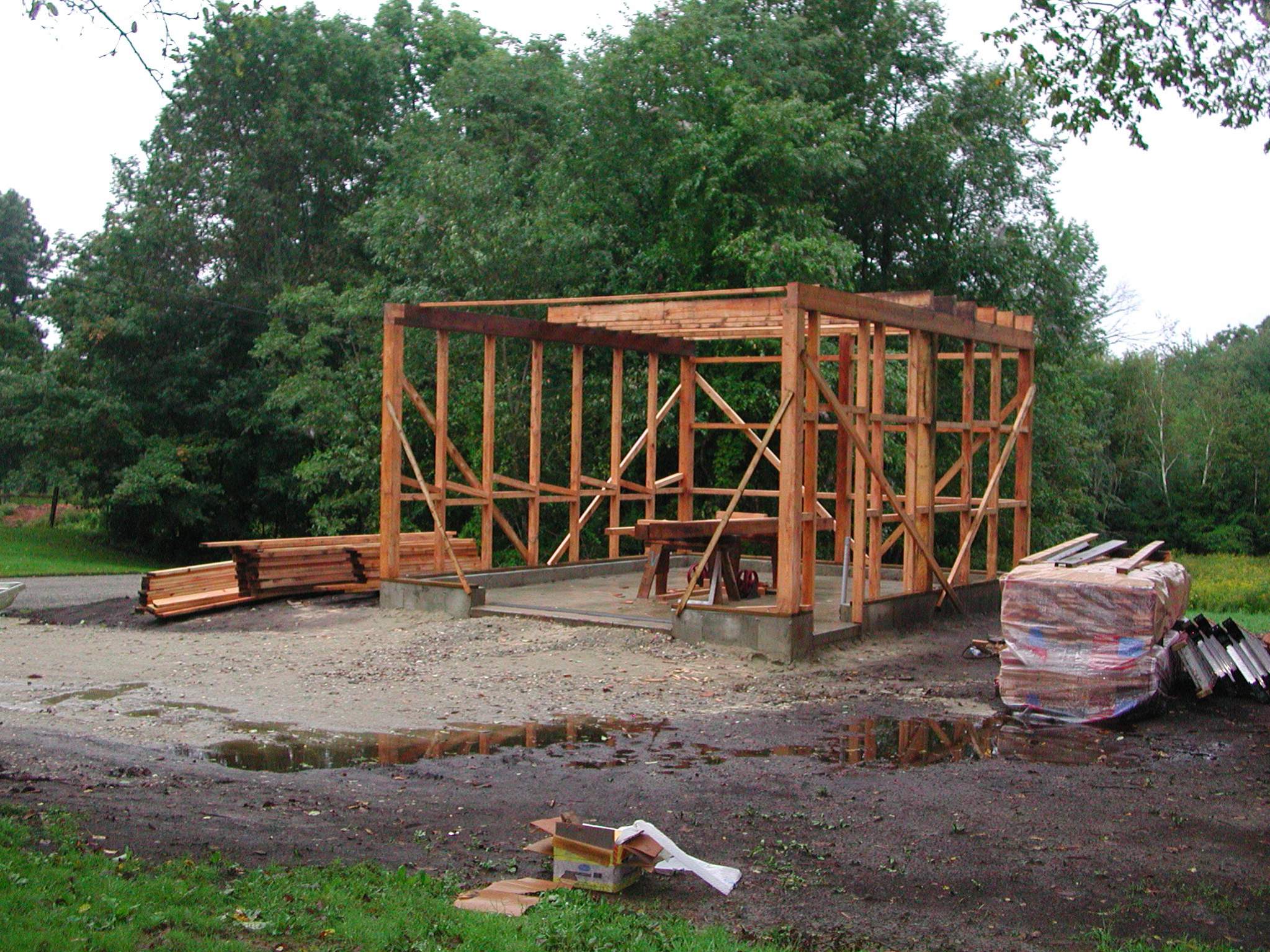

Chris, off the subject a little, but your little red outbuilding is quite nice. Did you build it? Give us a little history on it.
/ Countyline tiller
#14
Woodstock-20121214-00008.jpgWoodstock-20121214-00005.jpgWoodstock-20121214-00006.jpgWoodstock-20121214-00007.jpg
We had the barn built by a local sawmill.... You can PM me at cmhyland@aol.com if you need more info.
I have pics of the plans attached.
