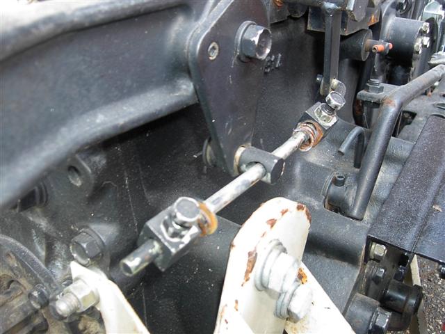

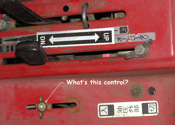

I'm still trying to figure out how the draft control on this tractor works. Got part of it figured out but still have a couple questions.
Do you know what this control is? (see pic) It's almost hidden by the seat and as can be seen it's next to the draft and lift levers. When moved forward and near the end of it's movement, it places a load on the tractor. Suspect it has something to do with the hyd but not sure exactly what.

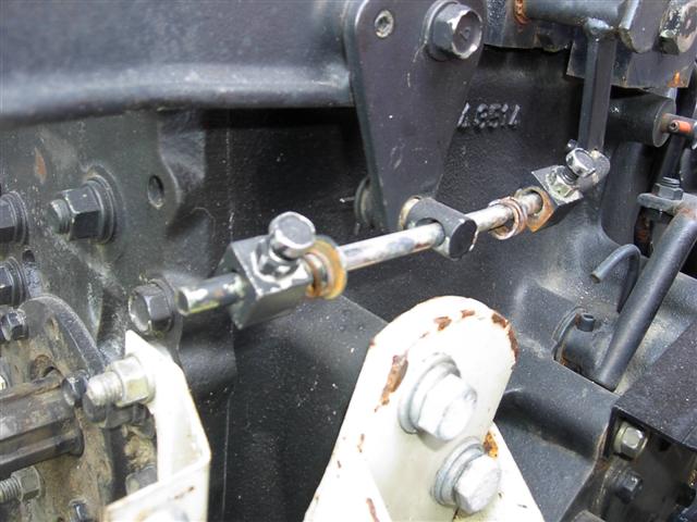

Have got the draft linkage connected to my quick hitch frame and now draft control will raise and lower the 3pt lift. The draft sense control lever next to the top link runs forward to a shaft on the side of the trans. On the same shaft (mounted coaxially) is another control link that goes to the uper lift arm. What this link controls I don't know.
Reading over again in the manual (Murray Publishing) there is not a lot of info on the working of the 3pt lift but it does sound like there should be down pressure on the lift except when position level is all the way forward. Manual also says draft control will raise the lift when implement is placing too much load on the lift. With implement mounted solidly to 3pt I don't see how the draft control via the sense lever can see this load.
So anyone know what the control in the pic is for and if you should see down pressure on the lift arms except for full forward position?

Can't help with the control/thumbscrew, but as I understand it, the 3pt position lever positions the 3pt lift arms at a particular height (angular position) and holds them at that location. However, when the position lever is fully forward, the arms are put in "float" mode with no hydraulic pressure applied in either direction and allows the attachment to follow the grade or ground level.
I'm with you as far as understanding the "draft" (as "force") control. With the setup on my tractor, I can't see how it senses force. Position, yes. Force, no.
Now, if the position lever was in "float" mode and the "draft" control was set up and connected properly, I can see where it (draft control) could control the depth of a plow or some other ground-engaging attachment. If the plow tried to dive too deep, the position change could be sensed and pressure applied to lift and correct the position. But that is strictly a position sensing activity and without some sort of load cell, I don't see how it can sense the amount of "pull".

Looks like I forgot to mention in the original post. On the tractor there is no down pressure. No matter where the lift lever is placed I can lift the arms, i.e. it floats. Was hoping the control with the thumbscrew would have something to do with locking the arm in set position but it doesn't. Don't know what/if there are any problems with the lift. Was hoping if someone could tell me if their machine locked the lift arms via the position lift lever.

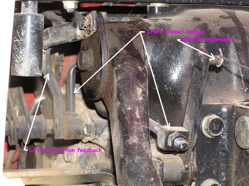

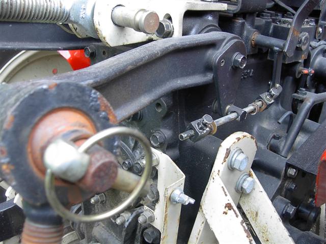

Ductape, our tractors are very different in how the draft control operates.
In this thread I've used the word "sense" when talking about the draft linkage but I don't know if in fact it is to sense the load other than what I read in the manual the the draft control senses the load and controls the implement depth. Who ever wrote the English manual, do they actually know or are they drawing on convientional knowledge?
In the attached pic you can see the bailing wire conncetion I made to the implement. With the connection made the draft control lever will raise and lower the 3pt arms but I don't see any way it can sense the load. Presently I don't see the draft control doing any more than can be done by the position control lever. The draft control will set the lower limit on the arms but that can be done with the stop on the position control lever. Without this bailing wire connection I've temp made, the draft control lever does nothing.
In the pic you can see the linkage that is connected to the lift arm and forward to the same "rod" going into the side of the trans as the draft sense linkage is.
As I'm composing this a thought has come to mind. I wonder if the control I first wrote about (one with thumbscrew) could be some sort of pressure limit control for the lift arm load. If load exceeded the setting, the arm starts to drop, the draft linkage see the movement of the arm and applies pressure to raise the arms. As I previously mentioned when this control is moved forward it applies a load on the engine. Humm?
