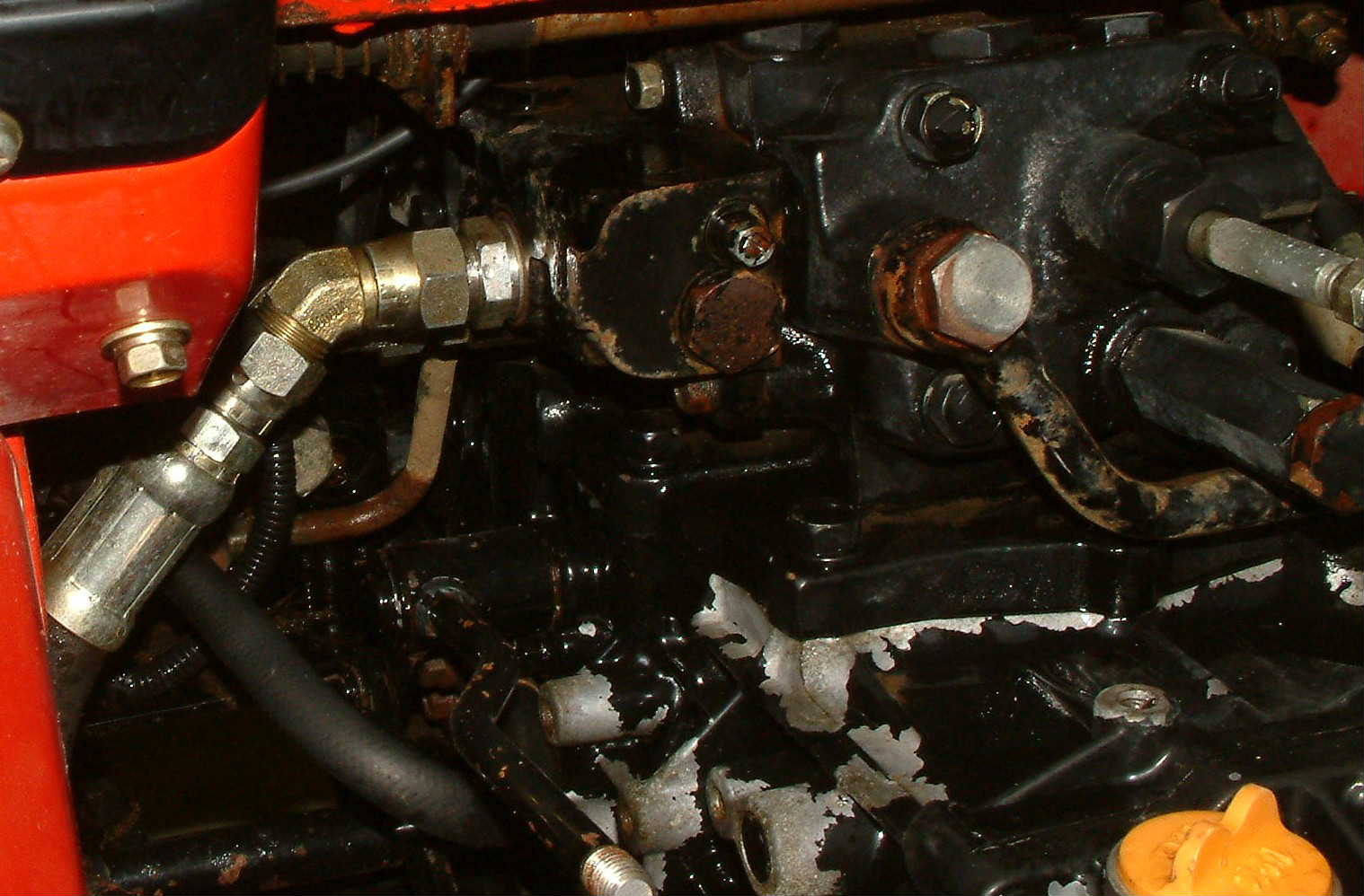

the valve in question controls an auxiliary hydraulic outlet on the side of the transmission. I run a FEL off this outlet.

This must be on your F18D??
I would like to see a picture of your tractor, including the plumbing for the FEL. It is the first time I've heard mention of any implement connected the way you have done. If you (can) post a picture it may help me, Mickey and others.

Mark, I bought the F18D about 4 years with a homebuilt FEL on it, from a privite indivdual , it was plumbed this way when I got it. There 2 hydraulic lines that come out of the right side of the tranmission about 4inchs above where the gear/range selector goes into transmission. I have the plugs that came out, they are 27mm(1 1/16) hex heads. Its very tight in there, I will have to remove some sheet metal to get some pictures. The hoses then quick connect to a Prince 2 spool loader valve. When loader is on the tractor the valve under the set is open, when loader is removed (prince valve stays with loader) the valve under the set must be closed. I will post some pics of the setup when I get them. Hope this helps
Dave
   / Couple ? about 3pt hyd #17
Here is a picture of where the connection is. If you take the sheet metal cover off that is under the seat and look at the side with the shifter you will see this block. The connection you see is the pressure line and the and the return line is directly behind this line.
Dave

Thanks for taking the time and effort for the picture. It goes directly in my mind file for alternatives on future applications. Nothing beats a clean (Tidy) installation that duplicates a factory look.
Mark
