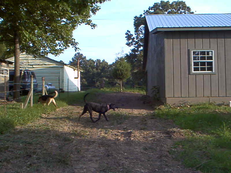

I leveled the area where I build my shop using my tractor with FEL and boxblade and it worked out well. I didn't use a transit but the contractor shot it in prior to forming and it was all level within 2 inches (had a bit of slope) which he said wasn't a problem, he could adjust the forms for that and just put a bit more concrete on the low end. I leveled the slab area but left in some natural slope for the low side so the eaves height would be more which turned out to be good planning (even though I didn't plan it) so my 70HP tractor will go under the shed on the low side but not on the other side
