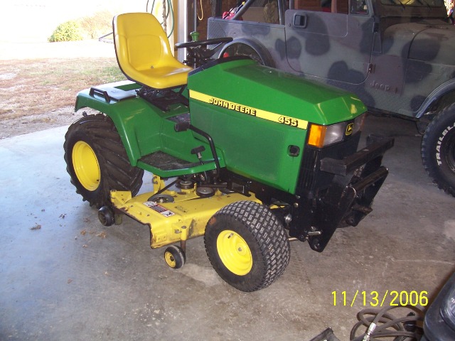

Don't think the shape/size of the 455's changed over their years, so don't know what model your son may have had that you are thinking of.
At least jdparts doesn't show anything different.
There were the AWS (all wheel steer) for each of the 425, 445, and 455 models that came with a bit smaller tires. That may be what you are remembering.
Good comments on the 455 vs 2210.
I'm sorry, I'm not at home right now so can't take additional pictures. But, his 455 is nothing like mine in regards to the steering setup, and his runs a lot smaller tire. I have no idea what year it is though.
   / Couple questions about the JD 455 #12
I believe your son's 455 must have been a 455 with AWS. Like a couple other members said, all of the AWS models came with 23" wheels, compared to the 26" wheels that are found on the 445 and 455 with 2 wheel steer.
I've seen 400 series tractors from the early 1990's all the way until the last year of production and I believe they never changed the chasis/transmission/steering system.
