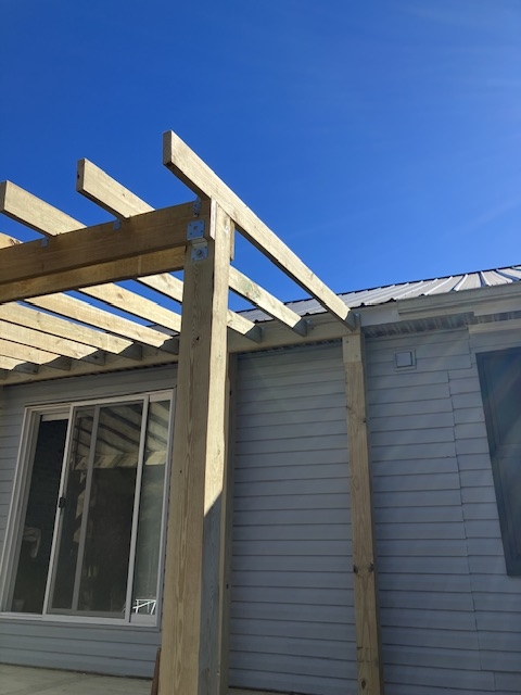

Hi all, I’m build a covered deck and can’t decide if I want to put a 6” overhang on the gable ends.
I have a 12” overhang on the eave. If I decided to add 6” on either side with a ladder extension, it would cost me an extra sheet of metal, since the deck is 24’ wide and each sheet is 3’.
Curious to heard your guys’ opinions, see pictures bellow:

An overhang on the gable end might keep some rain off the post. Maybe not? Jon

Yeah, that was what I was thinking. The problem is, the more I think of it, that I should have extended the header out 8” past the posts. I remember doing gable ladders on my barn (got a lot of good advice for that build here) and they sag slightly.
I build the ladders last night to test fit and they are HEAVY. Treated 2x6 material. I don’t have blocking in between the rafters so effectively it’s the outermost rafter responsible for holding the gable ladders. Another lesson learned in planning out my projects fully before execution….oh well!

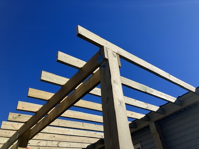

Definitely do the gable over hang. Since, as you point out, you've got to get another sheet of roof anyway, I'd go to a 12" overhang to match the eave.

You shouldn't need to build "ladders". The eave facia board that's being supported by all the other rafters will hold up the overhang rafter. That is if you were planning to do facia. If not, it would be worth considering, just to support the overhang.

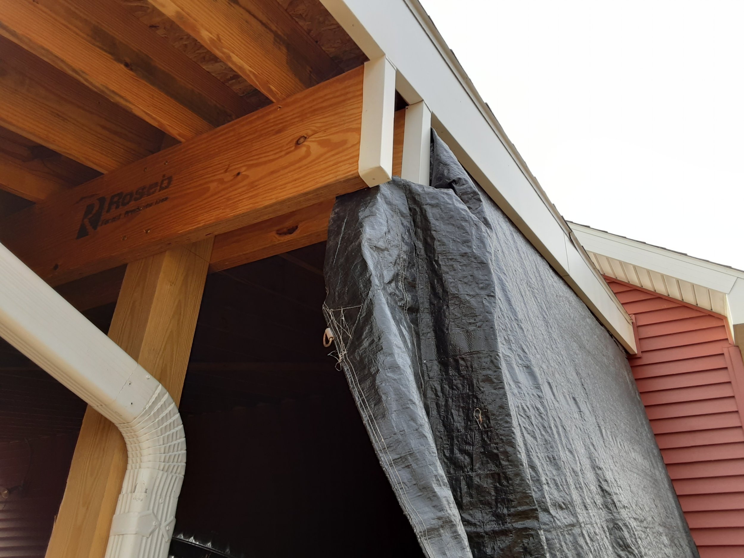

I did a similar lean-to off my garage gable wall. The upper header is 28ft long and is fastened to the bottom cord of the gable truss, supported by the gable wall. The lower eave headers are 2 LVLs (also 28ft long) supported by 3 posts, on 12ft centers, about 25ft outside width. I used the outside rafter as my rake(?) fascia trim board. I covered that with bent up white metal. I also capped the ends of the LVL's with white metal.
Not the dumb comment. Can you move your outer posts into the next rafter and use the outer rafter as your trim board? Might need to but another post, set it, remove outer post and use it at opposite end. Jon

Are you sheeting this roof or doing purlins?

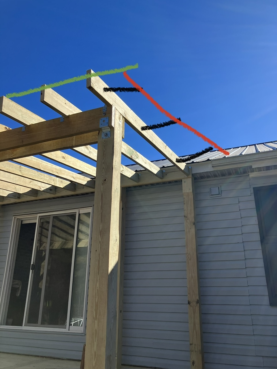

I’m doing purlins with 5/4 decking boards. I am doing fascia, but it’s a flimsy 1x6. Please see the drawing below and let me know what you think.

Would this work, or is there a better way without the ladders:
Toenail some 8” knee braces of 2x6 to the outermost rafter (black), put a 2x6 or 1x6 along the new roof edge (red), then tie it all in with fascia (green)? Not pictured, but I will extend the purlins to the addition. Thanks for all the help guys. See picture below:

Jut overhang the purlins a foot and add a facia board to them if you want. They don't need any additional support for that size overhang.

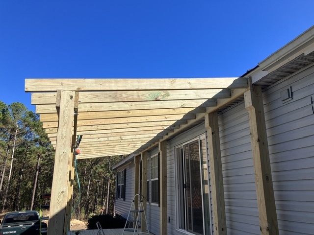

Well, got the roof finally on today. Thanks for all the suggestions. I did a 9” over hang, used a couple 2x6s and just screwed the fascia board to them, tied in with purlins. Not shown in the picture is the rake trim. I’m sure I’ll have a couple more questions for you guys…next stage is pour a small (6’ x 4’ ish) concrete pad and build the stairs.
