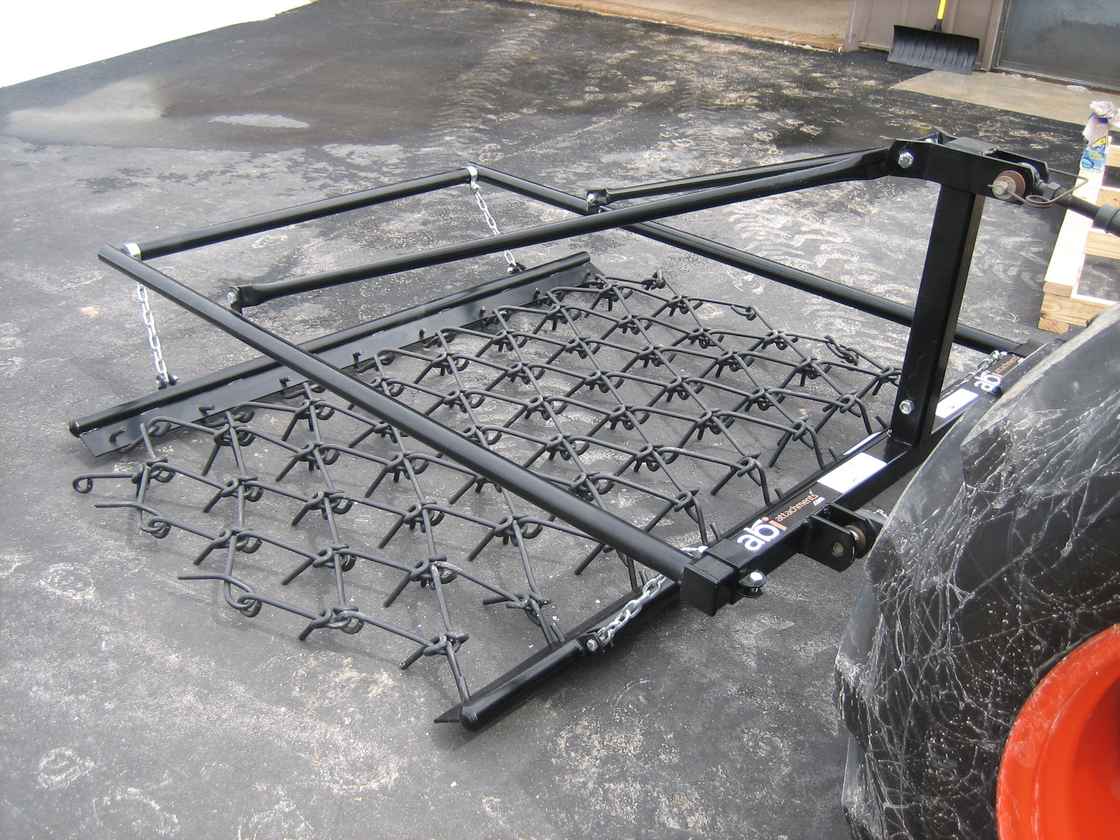

Just wanted to show you my 3pt chain drag. it can be turned upside down for seed cover. Used it for some grass seed that way this spring.
I like that! :thumbsup: Looks like it might factory made?? If you bought it, who is the manufacturer, and how much?
I sure like the looks of this rig James! I dont plan on owning one for my 3 point.....but if I did....this would be the real deal. We just drag ours around with the 4 wheelers.....but I can see this for unloading the trash....and for transport if you use it allot. Nice. :thumbsup:
