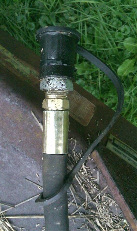

Put a medium (1/4" wide) zip tie around the cover in the first 1/2" (like a belt or the drawstring on a bag) while its on the connector and tighten it till its snug, then cut off the extra "tail" from the zip tie. That will tighten it up and help it stay on.
Was out hooking up the mower conditioner yesterday and thought that I would take a picture of what I am talking about:

Thanks, I'm going with that until I find something made of metal.

Ok, Aaron, you're a genius. I used white zip ties so I could see if they were moving. I found that if I tightened the zip tie as much as I could with the cover over the hydraulic end, remove the cover and then tighten the zip tie by two more clicks, it did a great job coming on and off and transitioned into a positive index. I'm completely happy with this result.

Glad it worked for you. I bought a half dozen new covers and was unhappy then they started falling off in 6 months. The zip ties have been working well for several years now in some cases.

Try putting a small hole in the end with a nail so they let off any pressure. It doesn't take much of a leakage to push them off.

I had the one on my HST trans fill port where the male would always push off the female rubber cap that the dealer installed. I took a paper shop towel and wrapped it around the male fitting and then push the female boot on. it works well and gives me a rag to use to clean off the fittings before connecting and when removing the bhoe from the tractor.
I did eventually find a higher quality dust boot and those are holding up well for about a year now.

I thing it depends on the formulation of the plastic/fubber. Our B7500 and BX2660 have ones that are stiffer and more "plasticy" than "rubbery" and they stay on well without a zip tie.

In true "Horror Fright" fashion, they don't tell you the diameter of these
Magnetic Ring
but it's 30mm - some of their "magnets" barely qualify as one, but these are so strong you almost need a pry bar thru the ring to get 'em off :thumbsup:
Haven't tried it yet, but plan to super glue some vinyl shelf liner material (or maybe thin rubber) to some of these, as they will completely cover the female AG style QD's. The magnets are plenty strong enough to hold thru 3-4 layers of non-canvas tarp, so any material that's thick/soft enough to act as a thin gasket should be fine.
Benefits, if they work at all -
Even if your qd's leak a bit, any slow pressure buildup will just force the magnet open far enough to relieve the pressure, but it won't come off.
Easy to stow, just find any non-aluminum part and get it close :cool:
Cheaper than the crappy plastic ones I've found
Downside - doubt they would work for the male half :(
On using zip ties - if you park your baby outside, I would recommend using BLACK ones - most others have no UV resistance and will crack/disintegrate in one season typically... Steve
