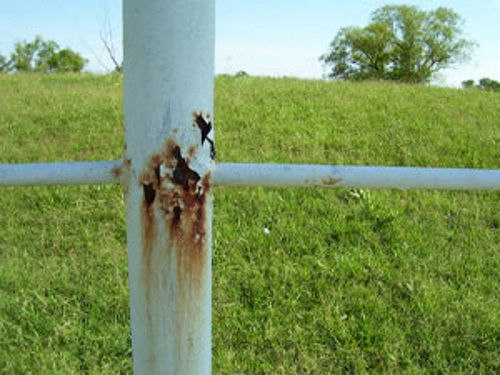

I can get 30 foot lengths of drill pipe for under a buck a foot. That's cheaper then T posts. I'm thinking pipe will also be stronger.
But it won't last long if it had salt water run through it. :eek:
Good info: How to Buy Pipe - A Guide to Pipe Buying - GoBob Pipe and Steel
   / Coyotes and Fencing opinions
#32
Thank you, that's a very interesting article. I'm going to have to rethink using that bargain pipe I've been looking at on Craigslist for a buck a foot.
   / Coyotes and Fencing opinions #33

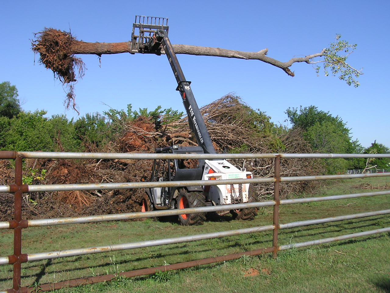

Unfortunately I have first hand experience with pipe fence posts rusting through from the inside. It happened several years after the fence was installed.
Don't have pictures, but it was worse than the picture above from GoBob Pipe.
The repair does show in this V518 picture from 2009, before it got painted.
