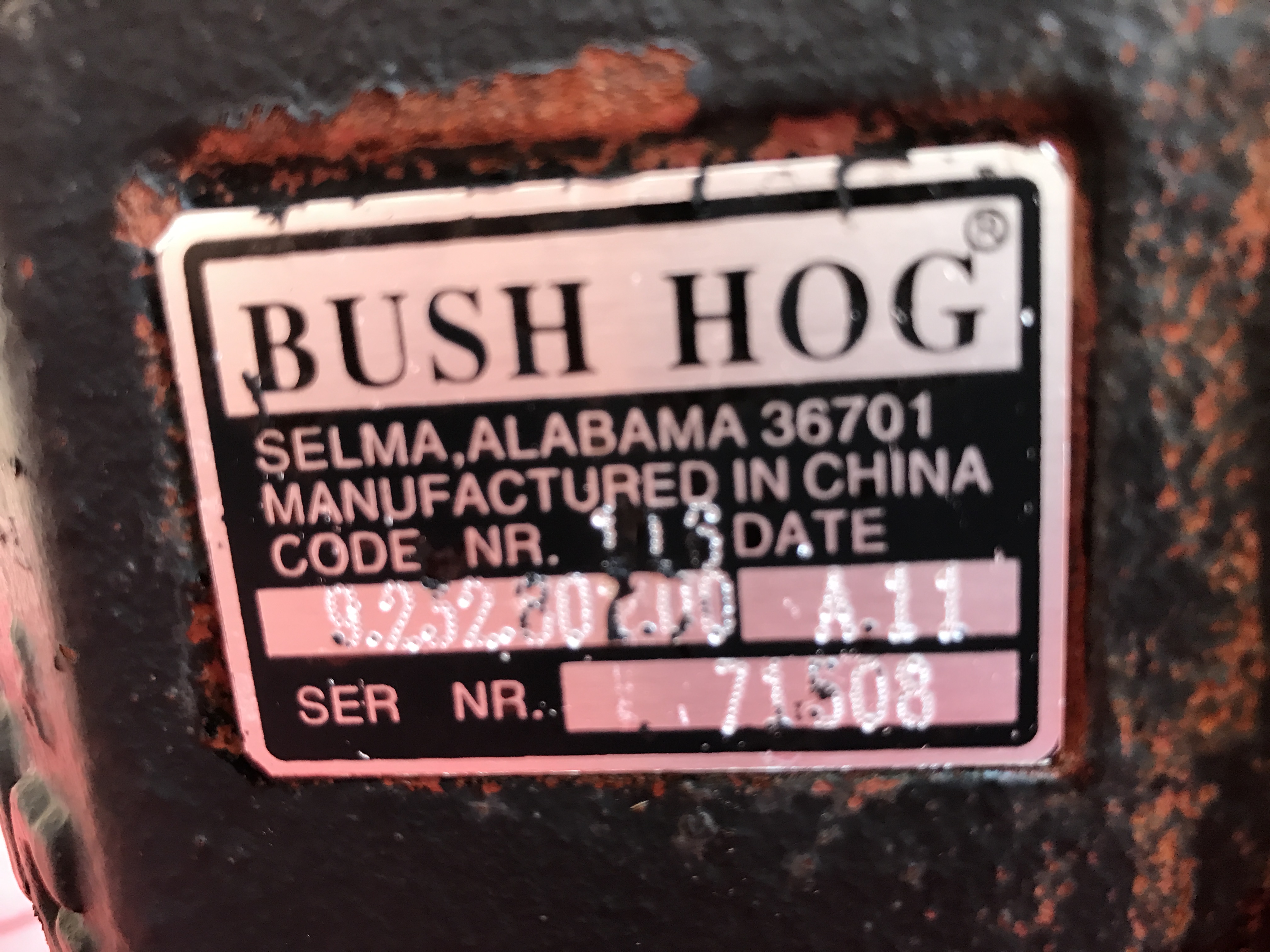

JWR, I know this is an old thread. Just wanted to let you know that my BH296 cutter has failed in the same place and in the same fashion. I own a fab shop so I have already repaired the casting with nickel rods but I can tell you and Bush Hog exactly why it failed...... Although, from the outside, the casting looks very beefy and thick, the lower side wall of the box is less than 1/8" thick in some places. Way to thin for this application!!! As you know, the base mounting flange on the gearbox is about 7/8" thick then it immediately transitions to 1/8" thick up the sides. When welding a crack in cast iron it is standard practice to drill a hole at each end of a crack to help prevent the crack from continuing on after the original crack is repaired. I was expecting the sidewall to be at least a 1/4" to 3/8" thick when drilling but the bit unexpectedly punched right through the side with no trouble. I doubt they will make my gearbox good after 4 years but I bought a Bush Hog brand cutter simply because I expected the best quality from them. The other posters above are correct about these gearboxes being made in China. My gearbox has a Bush Hog ID tag on it that clearly says MADE IN CHINA. I had not really considered contacting them until I read your thread but now I think I will since it is a known problem, especially after getting a quote of $1200 from the dealer for a replacement. Now I wish I had waited about welding up the crack. I'm sure it is just a matter of time before it cracks again somewhere else.

Looking at the photo of the location of the crack, The defect is in the casting thickness at the intersection of the gear box and the mounting flange.
The flange is the member that takes the torque reaction from the transmitted power. It would be interesting to know if the crack appeared on the drive Tension side, or the drive compression side. That might give an idea as to the nature of the load that caused the failure. Shock load or other.
The design weakness is not enough material at that corner. As a sand cast part, it would be easy enough to shave off a little from the mold to add thickness. But since the supplier is "over there", That's going to be like pushing a chain up a hill.
Still, It's good to know that the internals of the gear box can stand the beatings, while the case can not. I have never heard of a reputable maker not standing behind the box that the dear parts are housed in,
Think of it, If you had not noticed the lube weeping out, and run the box dry. Seizing the bearings and burning up the shafts etc. The defect would go unannounced, and you would be buying the replacement box.
Good for you for PAYING ATTENTION! ;-)
eta
I should have read "basicequipment's post. Shame on me.... but it is interesting what one picture will show. ;-)
