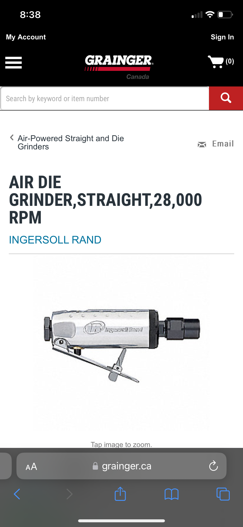

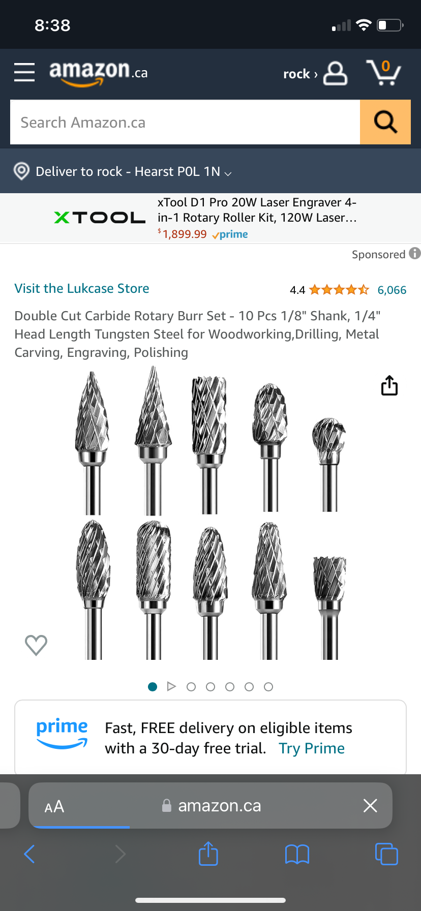

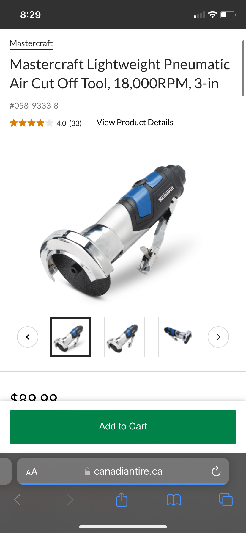

this is what i would used to grind the crack, the zip cut to make a groove down and the straight grinder to V it out.… how good are your welding skills? I hope they are really high to clean the inside of a used stove grind it and weld a plate in position, unless you flip it over but still, it will be a dirty job and hard to execute… but if you pull it of good on ya.
