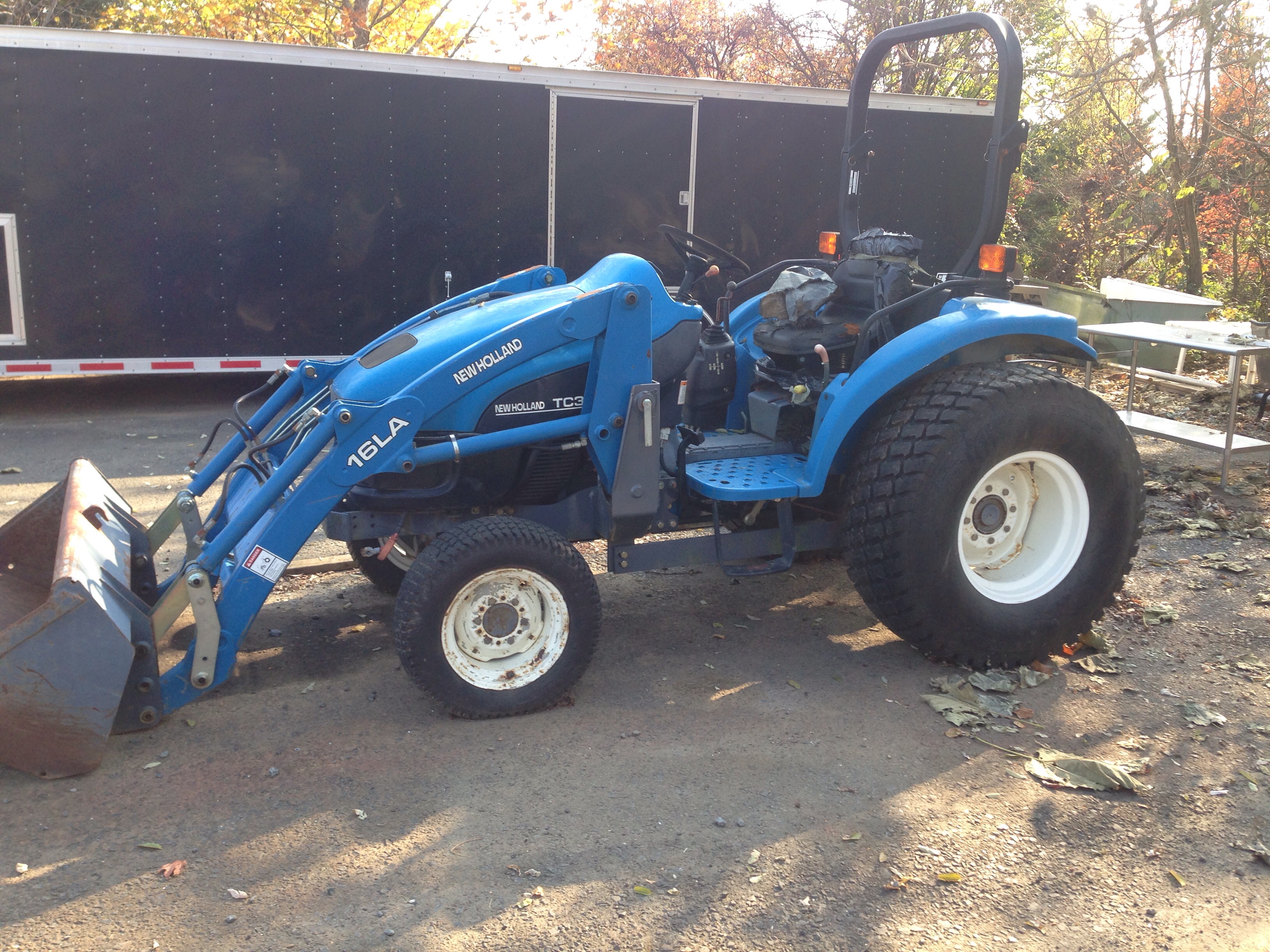

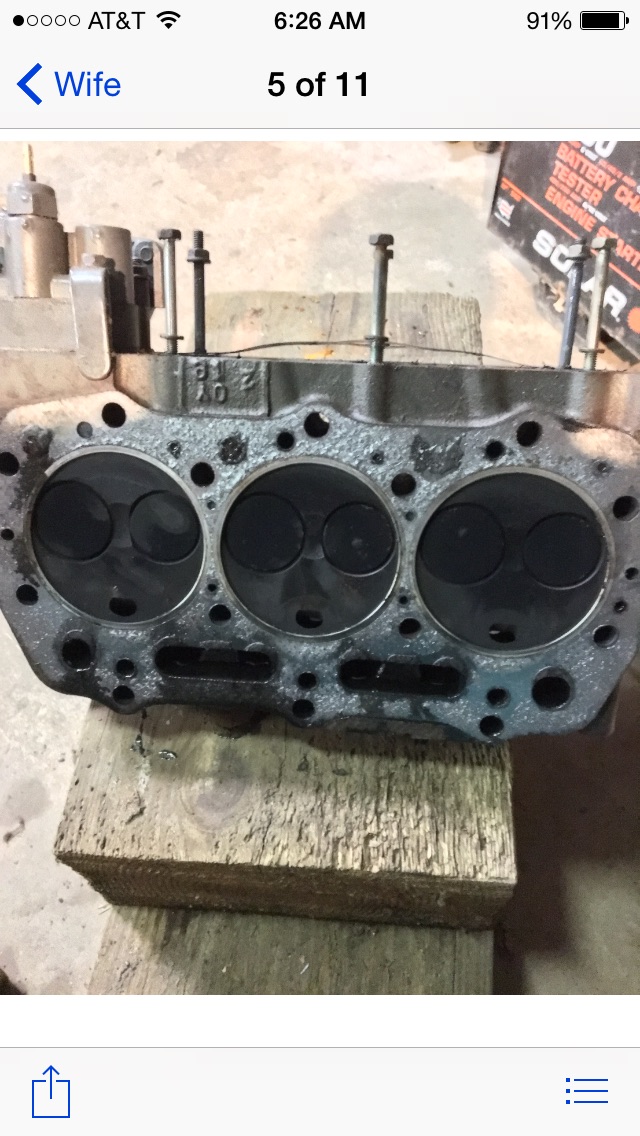

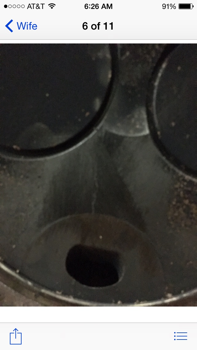

I purchased a 2000 tc35 that someone ran straight water in and let it sit for the winter. Well acourse there was water and the oil something froze and cracked. I bought thinking I would replace the motor. But after inspection I found a pushed out freeze plug in the head and a crack in the head.(which why the oil and water was mixing. My opinion.) I was wondering if a cast head could be welded and actually last or should I buy a new one. I'm trying not to spend a lot of money but I need the tractor to be reliable. I would like others opinions what I should do. image.jpgimage.jpgimage.jpg
   / Cracked head 2000 tc35 #2
Is that the crack running up to the injector hole?
I would at least look for a head used around the country first. A lot of these Shibaura engines
were made and it is old enough to be showing up in some junk yards.

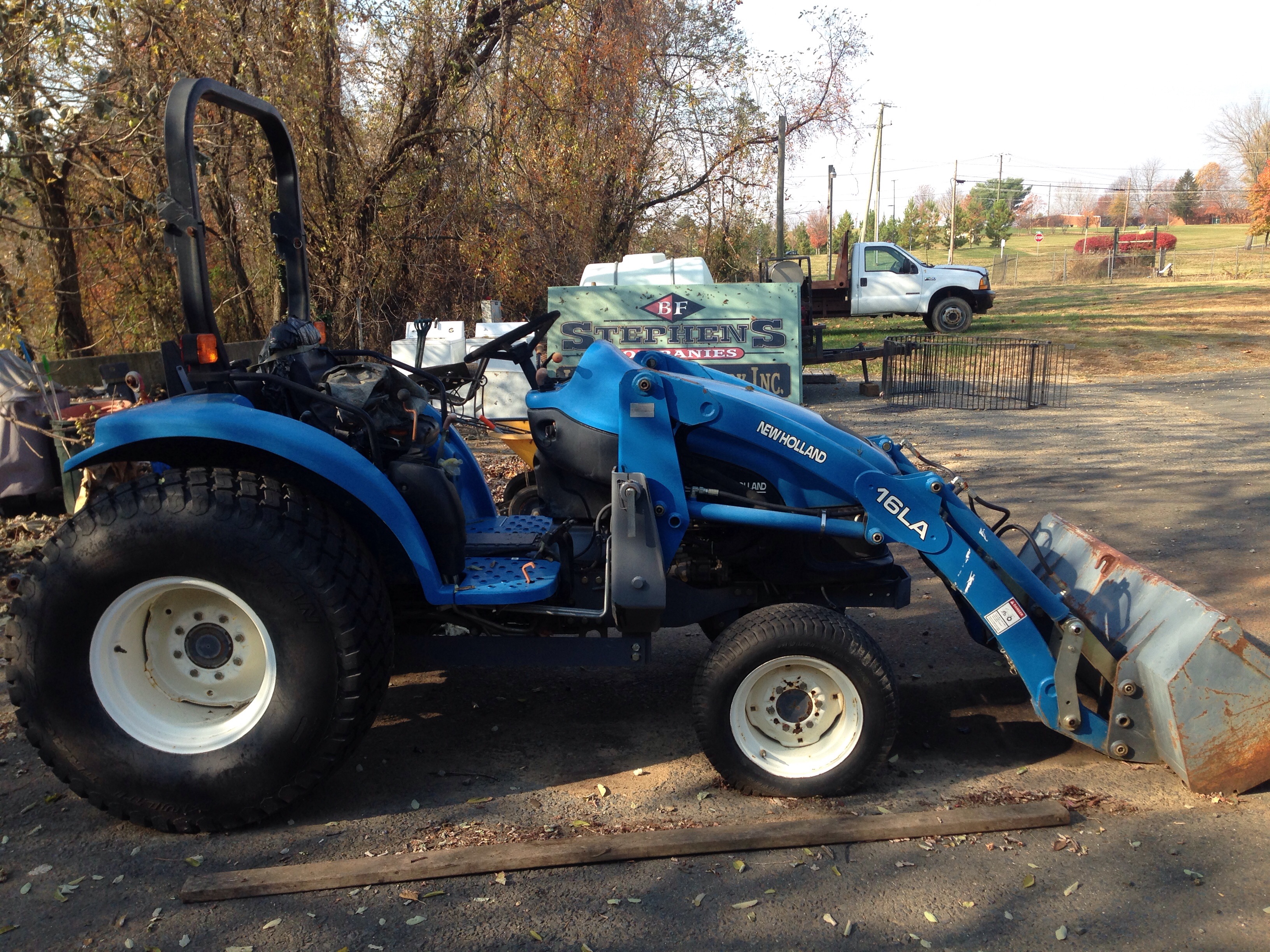

I know it wasn't going to be a cheap repair. But with what I paid for it even if I have to totally buy a new motor (say $6500) I still only have $8000 in a tractor that only has 288hrs that's 4wd with a front loader. image.jpgimage.jpgimage.jpgimage.jpg
   / Cracked head 2000 tc35 #9
Wow, lots of pessimism here. Bring it to someone who can check to see if it's repairable (block & head) and go from there. You don't want to replace the head just to find the block is also cracked. Looking forward to seeing the progress.
   / Cracked head 2000 tc35 #10
Pessimism, or realism? I've been a dealership employee for more than 20 years and am currently a parts manager. I think I have a basic idea of what the OP is in for. I hope he doesn't need to use that tractor right away.
