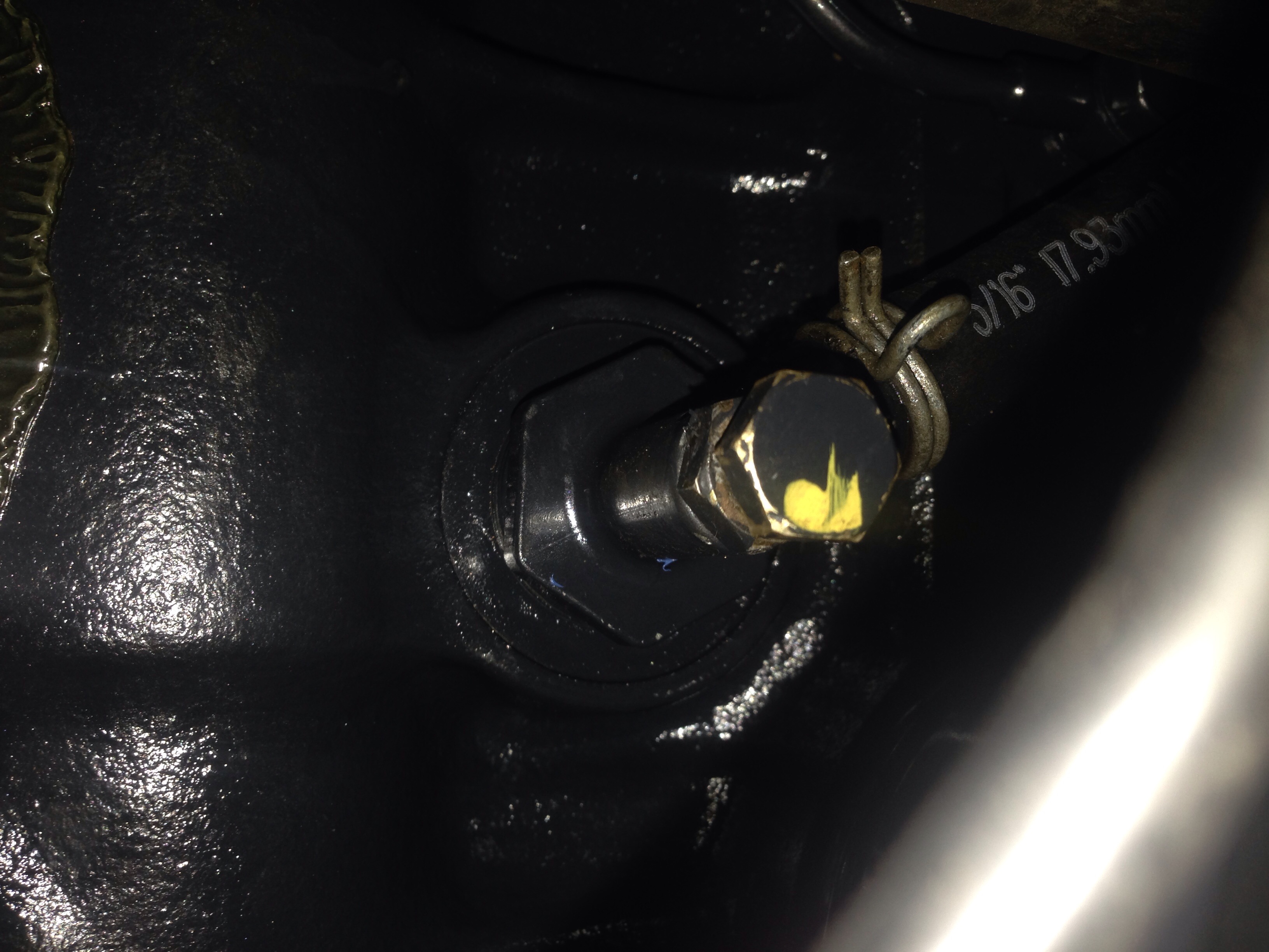

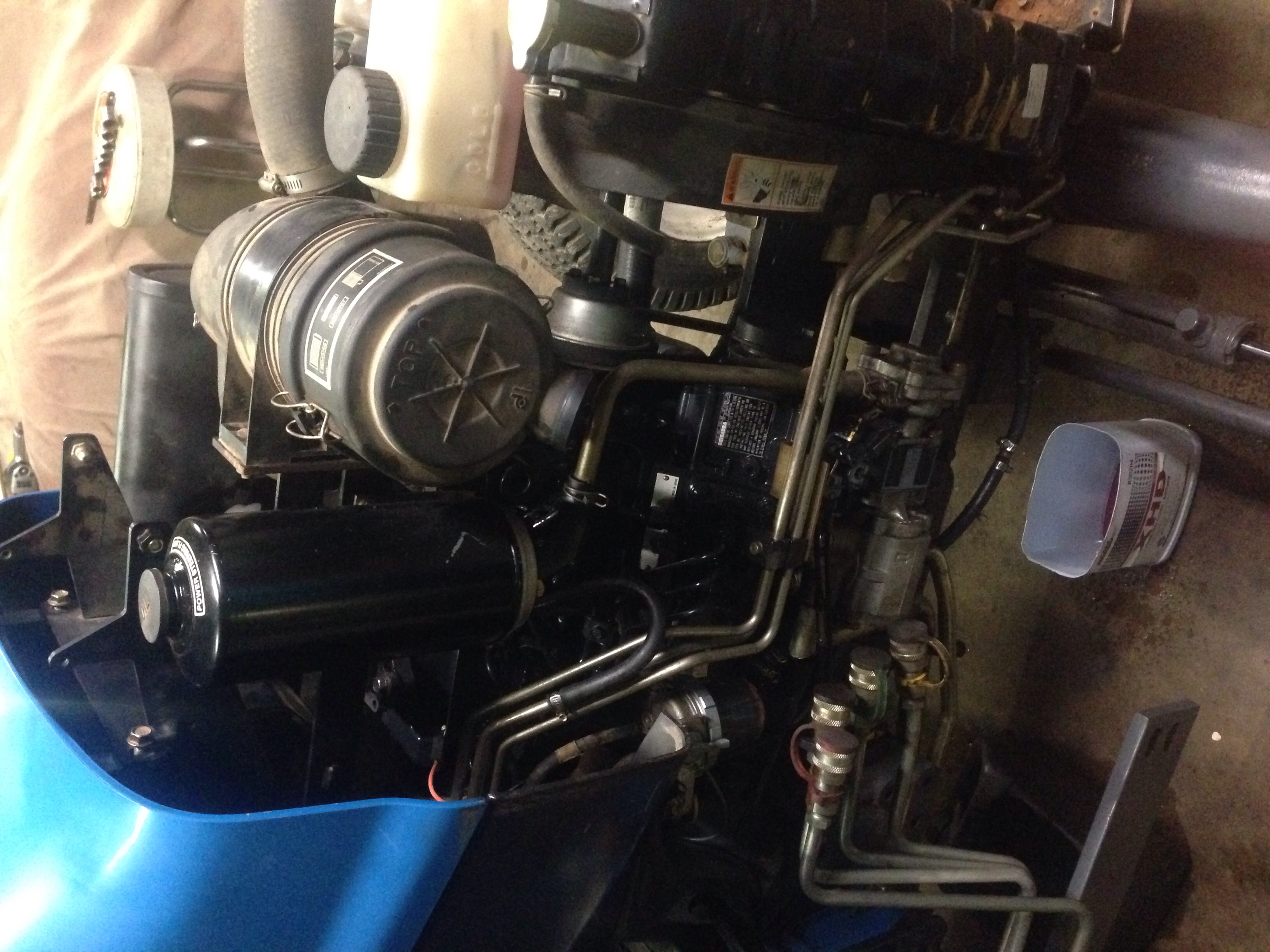

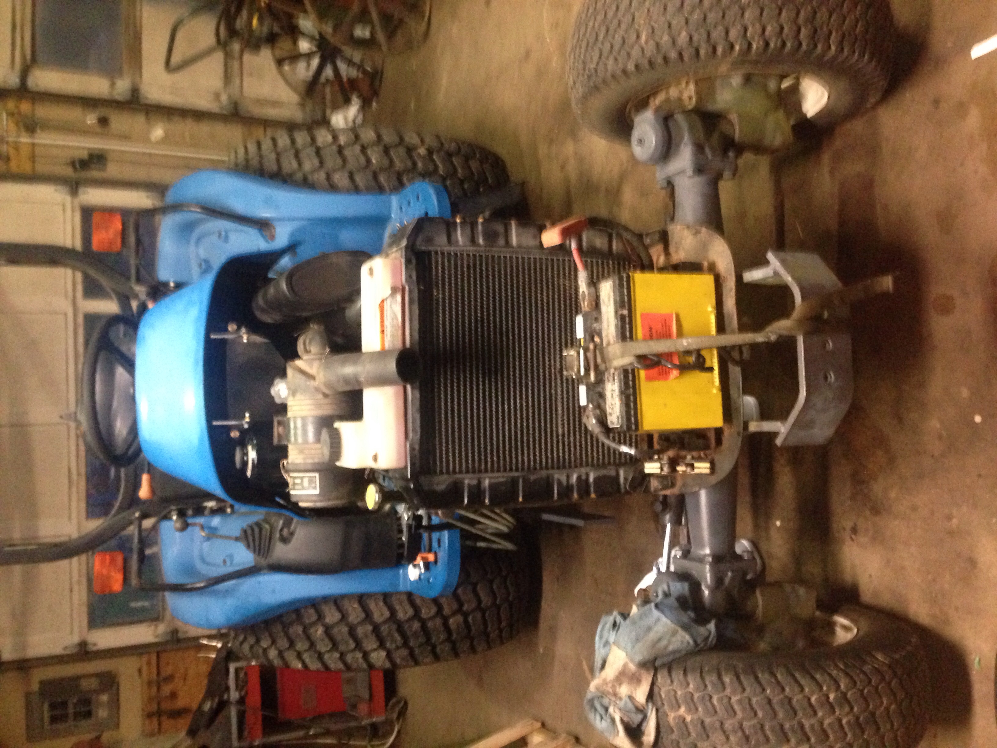

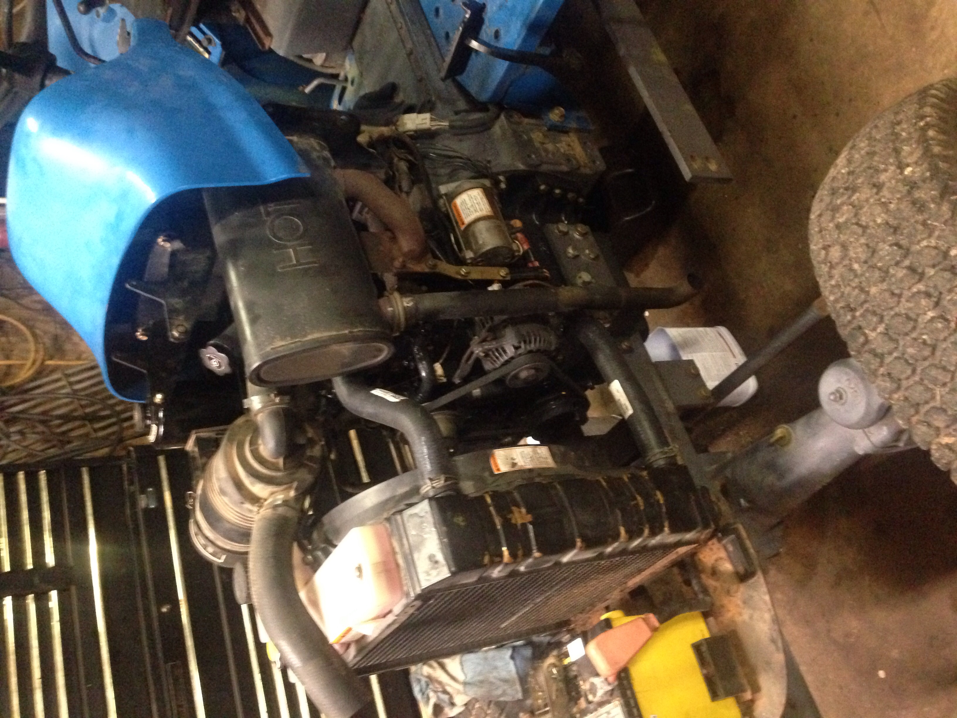

Here are some pictures of the remanufactured motor in. image.jpgimage.jpgimage.jpgimage.jpg The last picture is where the coolant is leaking from (the engine block drain)
