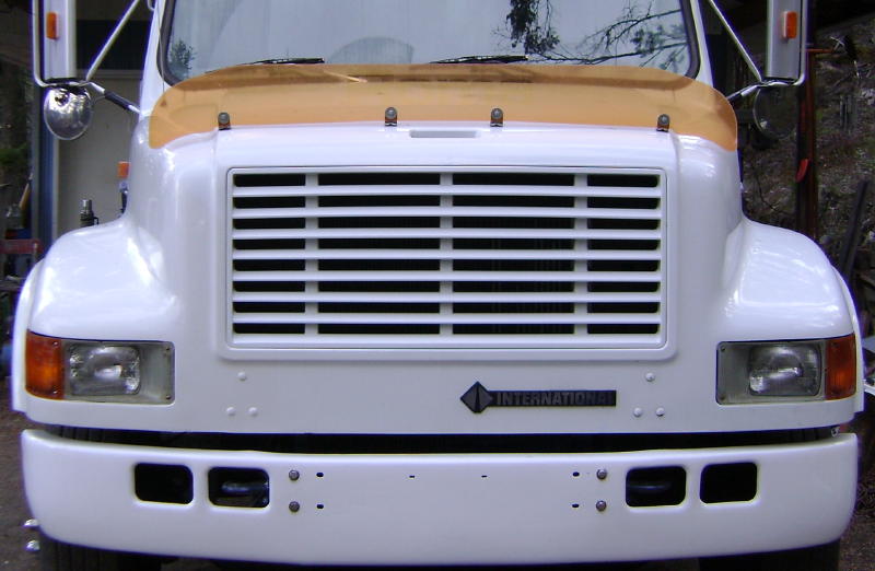

Best results I've had are with fiberglass resin with matting on the back then you can finish the face side with body filler for painting. It will stick just fine to plastic as I did the propane tank cover for our trailer. The hood of my dump truck was all cracked up around the head lights and I did it as well before painting.

There are two basic types of resin (the plastic used with fiberglass cloth), polyester and epoxy. When you buy an inexpensive fiberglass repair kit, it will have polyester resin as that's much less expensive. However, polyester does not bond nearly as well to many materials as does epoxy, nor is it as strong as epoxy.
BTW, "Bondo" is a polyester filler.
Test first to make sure epoxy will bond to the plastic - you can even use 5 minute epoxy glue (or any epoxy resin for this (if JB Weld, an epoxy resin with filler, works, then you're good to go). Sand the area to be repaired on the inside. Clean with a solvent like PrepSol or whatever and apply fiberglass with epoxy resin.
