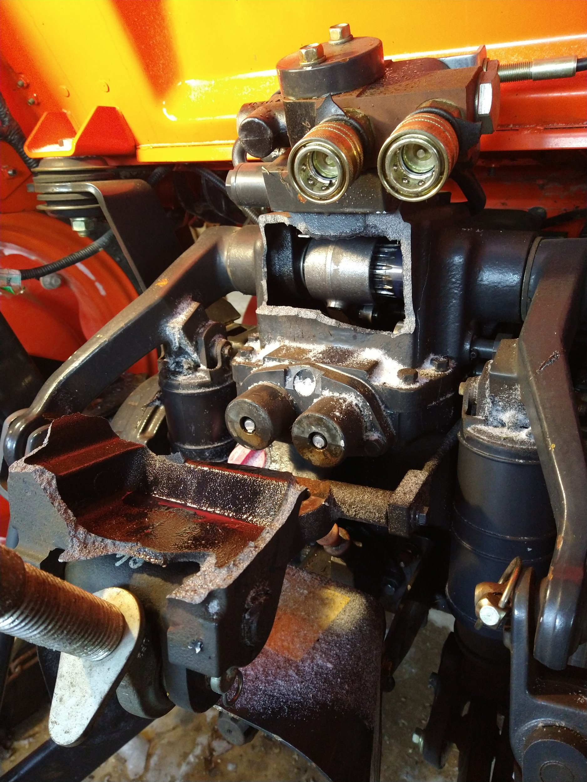

I know this post is old. I've been looking around for anyone who's had a similar issue I just had. Not the same, but sheared of housing where the top link attached. Pushing snow with a box blade. Hit a frozen bank. N4510

   / Cracked Transmission case between bolts attaching backhoe #94
Dang that sucks..do you have warrenty still?
   / Cracked Transmission case between bolts attaching backhoe #95
Nope. But I'm waiting on my insurance company. Not holding my breath. I don't really know what to expect for this kind of claim.

I don't think such a break is common.
@kbforester can you describe what happened with any more detail? That's one hell of a break, I've never seen one quite like it.
Ouch. You need a trip edge on that blade!

Is that available with a box blade?
No. Every proper snowblow has a provision for tripping because immovable stuff gets covered by snow and you cannot see it. Sort of like brush cutting a field with tall grass and the landowner assures you there is nothing in the field—except for that pile of cinder blocks, the old car parts, the old bottom hoe, and so on.
