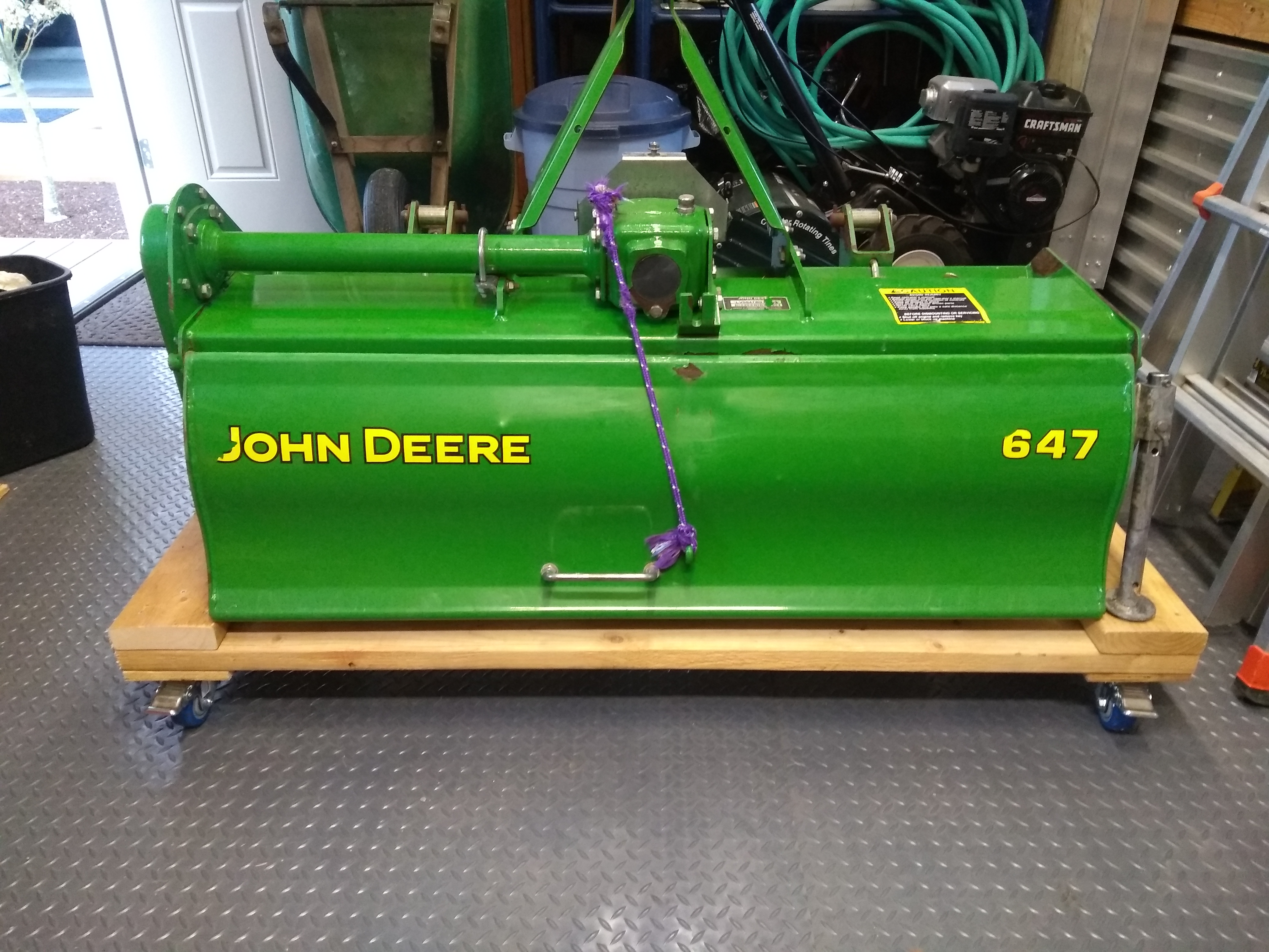

I have my land pride RTR1558 tiller feet adjusted so it will till as deep as it can, and I leave it setup that way. To keep it from rocking or moving around I set the feet on a short 4x4. With the parking stand down, it is a solid 3 point stance.
   / Cradle for tiller storage? #12
I have the same set up. Works well and I cannot buy casters and lumber for less if I built my own. If the OP has a stability issue, one option is to use ratchet straps to hold the tiller onto the dollies...but my JD tiller did not need them. Of course, using dollies means storing the tiller on a cement floor, but attaching it will be a lot easier...negating the need for a quick hitch...which is an added benefit for me.

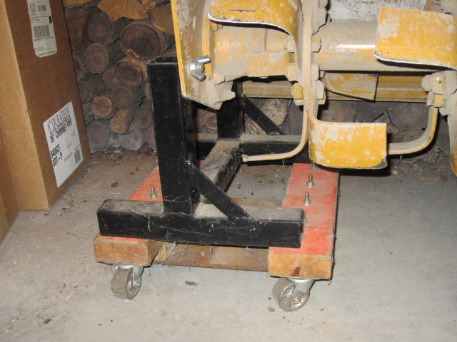

   / Cradle for tiller storage? #15
I made mine up out of 2x6s, plywood and cheapo casters. Built it so the tiller tines aren't touching anything, entire weight rests on the skid shoes and parking stands.
   / Cradle for tiller storage? #16
I never used the skid shoes on the tiller so my stands bolt to those holes. The stands fit on my re-purposed caster pads too.
The tiller tines are clear of hitting anything so they can rotate.
