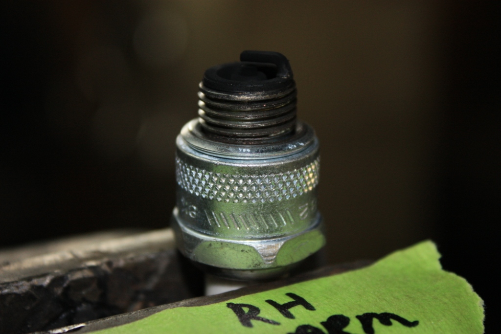

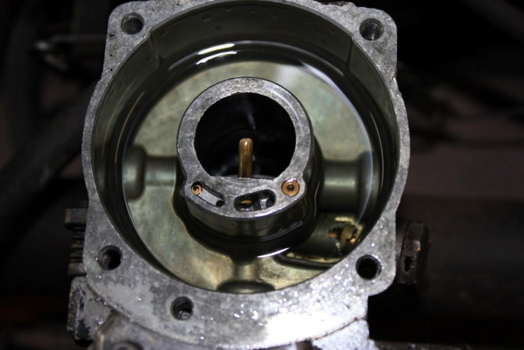

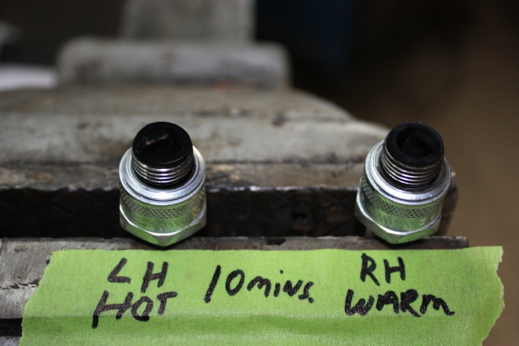

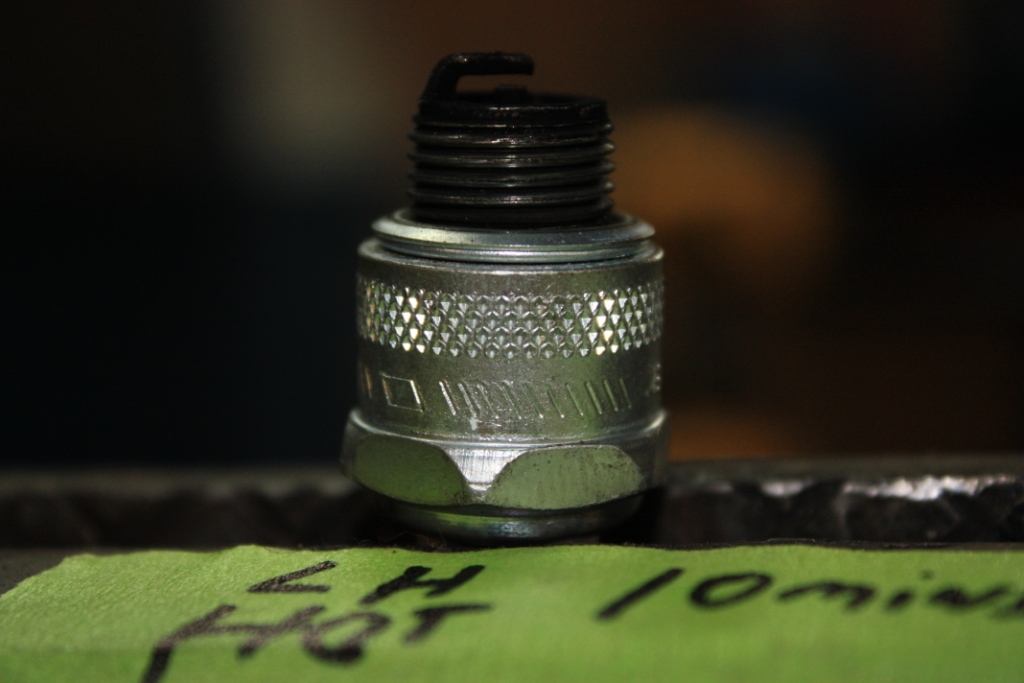

The plugs are still fouling, and theres 1/4" of gas in the bottom of the intake.
THe RH plug is still getting warm and the LH is getting hot. I took some pictures to illustrate the fouling issue. THese were brand new plugs today.
The previous crack in the main jet housing has now turned into a chip missing. I used sealent on the threads, so i doubt theres gas getting by, but it doesnt look pretty.

Sure looks like you are getting way too much gas, if your choke is working properly and air filter clean I would take another look at that chip in the carb. Maybe some JB weld?
   / Craftsman / Briggs 18HP Running on 1 cylinder #25
Have you checked the needle in the carb? It looks like raw gas is being pulled into the intake. If the needle is failing, or misadjusted, the fuel level will be too high and cause a rich condition. A plugged atmospheric vent will also cause fuel to keep running into the carb.

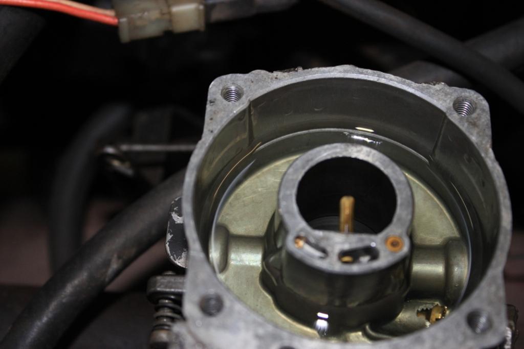

There was a new needle put in. The float was adjusted paralel to the carb. The fuel level in the last pic was the level when i pulled the top off the carb.
Ill have a look for a plugged vent.
Attached pic of fuel level.

I was looking at your first picture of the carb bowl, you can see where the bolt head that holds in the jet. It looks like the bolt has a hole or something in the side of the hex head, is it a hole that could leak air or just cosmetic? I can't really tell.
#28
The hex on the outside of the bowl is a bit chewed up but theres no leaks. Is that what your talking about? Or are we talking about the area behind the main jet?
