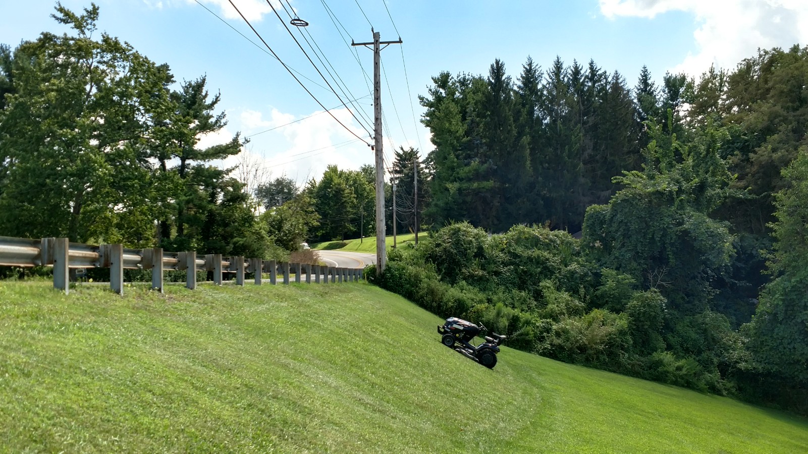

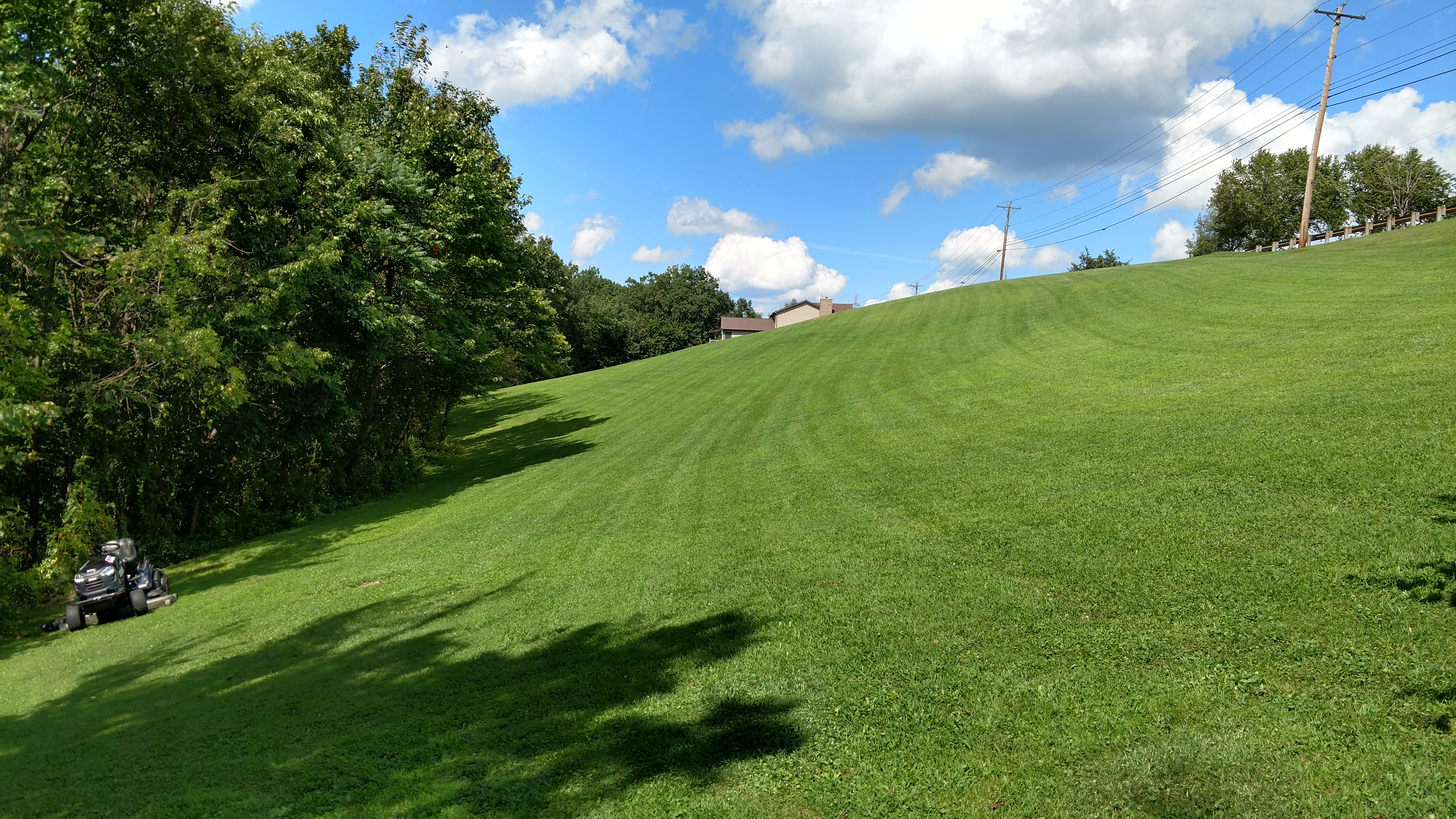

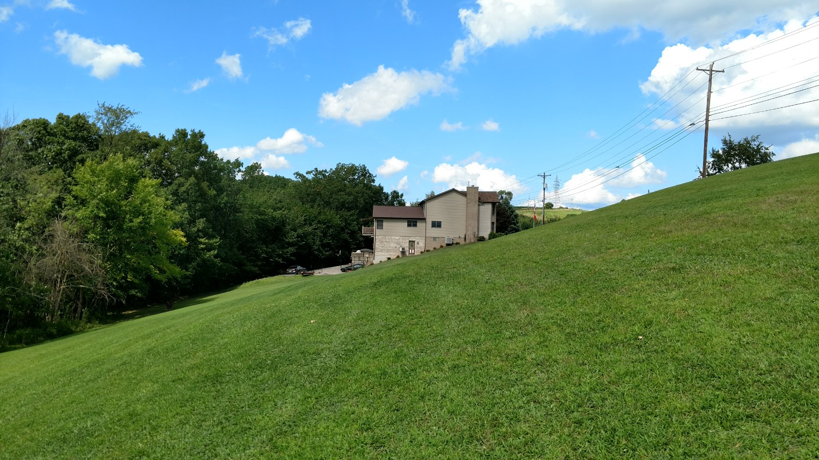

Just tossing it out there, but I also have a G730 transaxle with a Kohler Courage on a Craftsman GT Excellerator that now has just a shade under 600 hours on it. I mow all hills with it, run weights and chains, and it is a beast.
In 7 years and 600 hours it has had 1 battery, 1 set of deck and hydro drive belts, a few pulley pedestals and a few ant-scalp wheels. I've changed the oil/filter in the hydro unit 3 times, 200 hours to get Amsoil in it, 400 hours with Amsoil again, and I just did it last month at 550 hours with Amsoil. I also adjust the valves every oil change. She still looks and runs almost like new, but the hydro unit is starting to weaken. I've never had a Craftsman/Husqvarna garden tractor hydro unit last like this, this thing really is a beast! It has been the most powerful, most reliable, best cutting garden tractor I've used. I hate the frame flex.... but love everything else about this beastly machine.
I expect to get another 100-200 hours out of it before the hydro pump gets too worn to push the 32 degree bank... at least I hope to get that.
