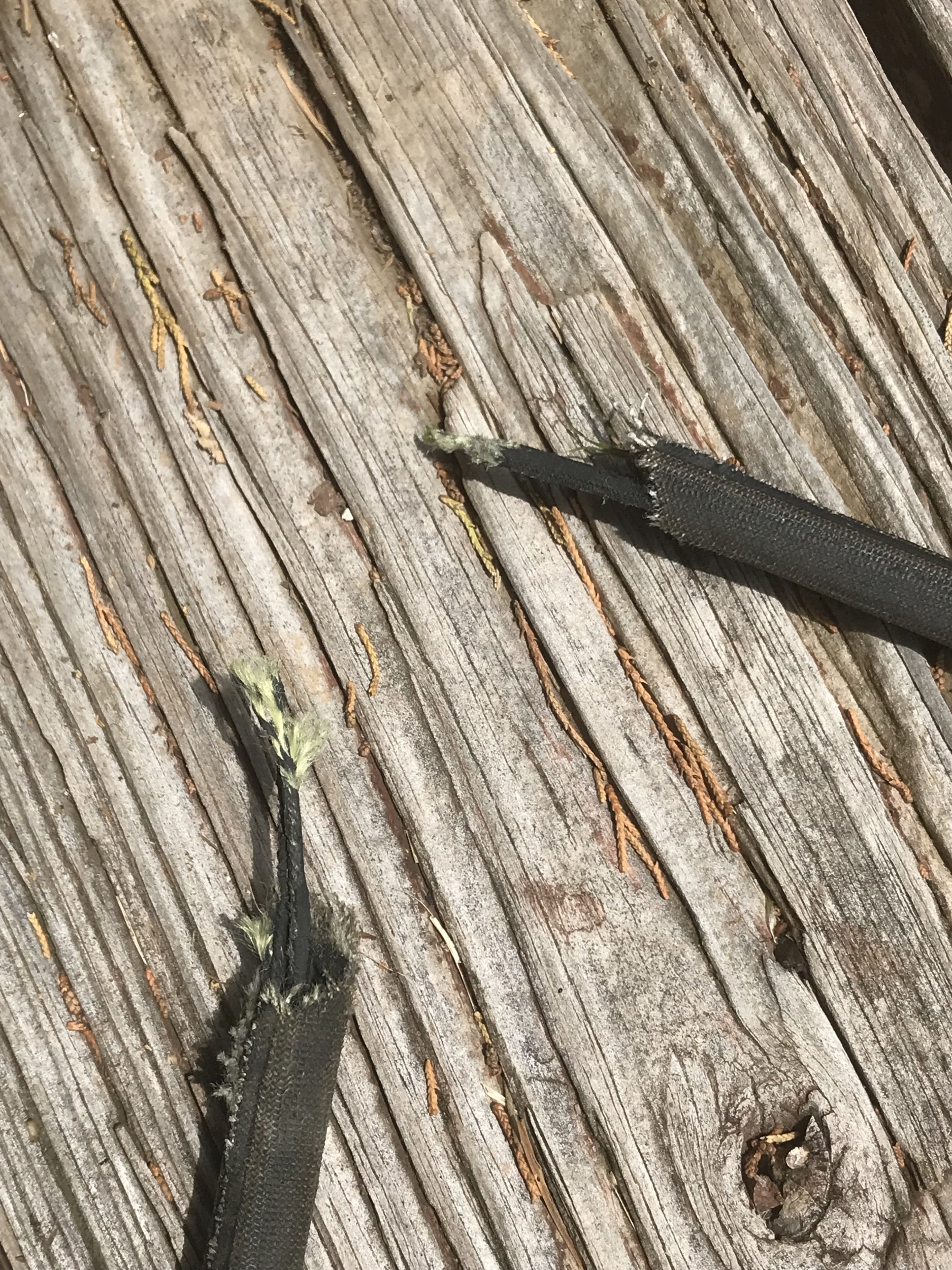

Hi All,
I have a Craftsman PYT9000 with a 26hp B&S and a 50" cutting deck. I bought it used 5 or 6 years ago and have had trouble with the deck belt breaking (average once per year). Doesn't seem to be any problem with the pulleys or spindles, they all spin free and doesn't appear to have any bearing issues.
Belt seems to break when I'm mowing tall heavy grass/weeds. So I'm wondering if the engine hp vs the load of the tall grass is just too much for the belt causing it to break. Maybe I'm buy crappy belts??
So, if there is no obvious problem I should check on the deck, is there a good brand of belt I can buy, that might last longer? I usually buy the kevlar reinforced belts.
Thanks,
Jeff
Oh BTW, its the MTD version, not the Husqvarna version.

Can you show us a photo of your broken belt ?
Here is a photo of the belt. Hope it is useful and tells you something.
Thanks,
Jeff

I've had that happen on an old craftsman 42" deck. A couple things I found to watch for YMMV ... TSC Blue belts seemed to hold up better than the cheaper ones found @ Home Depot. Also, check the spindles closely, I've had the mounting ears crack & you couldn't tell until a load caused the spindle to tilt which threw the belt & shredded it. Check the idler pully for parallel as they age, they can get out of line with the other pulleys & throw belts. Finally, check the spring tension on your idler. My spring was worn/weak over time, so slippage at start & under load would heat up the belt & then it would get worse & worse, then throw or shred.
