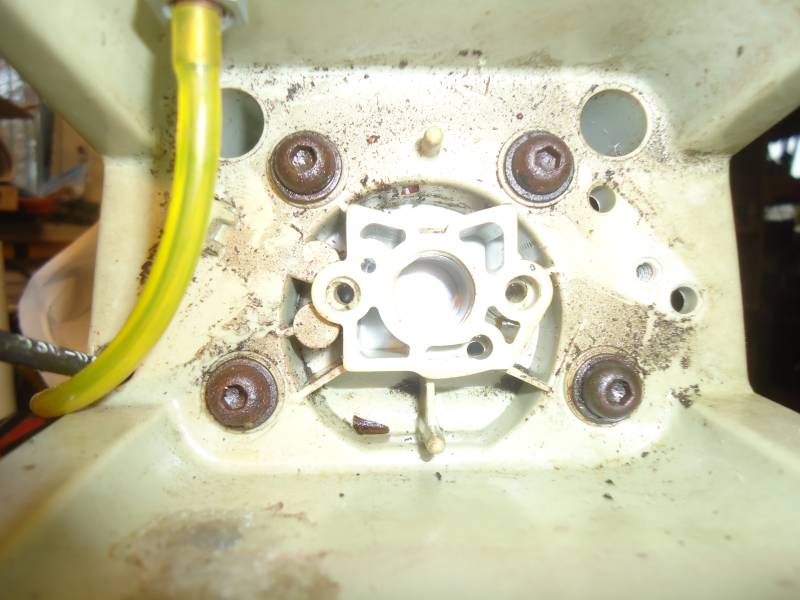

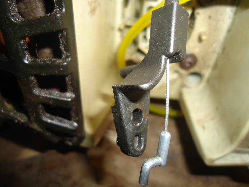

Can anyone provide a pic that shows where the black plastic fitting on the carb end of the throttle cable goes? It's a 32cc, 18" weed eater. I know shudda taken a pic.
Cheers
Joebob

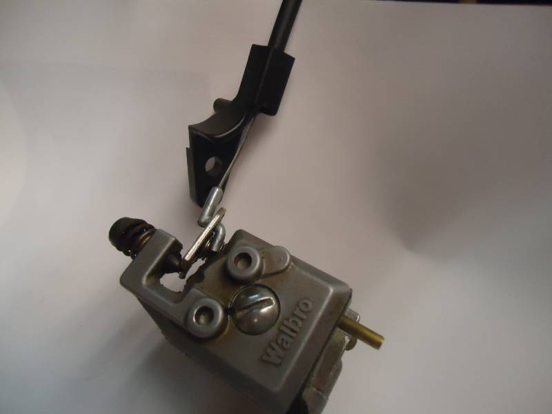

The black plastic fitting on the carb end of the throttle is to keep the cable sheath from moving. W/o it anchored to anything, the sheath just moves back & forth when working the trigger. It has to be anchored to something, or it won't work. The mystery continues.

Could you move the throttle cable out of the way and the fuel line and take a clear picture of the trimmer where the carb mounts. Your cable mounts to the back wall area behind where the cable is hanging in your first picture but isn't clear enough to tell you where the locator pins go or the mounting screw that holds it in place.

Many thanks for your reply, Randy, after what you said, & taking another pic, I think I see where it goes. Looks like it would fit in about the 1:0
0 o'clock position. Two holes for the pins & one for the screw that secures it. I just can't believe I didn't see this before, duh! Boy, don't ever get old.
Thanks again for your help
Cheers
Joebob
You can even see the dirt outline of where it connect at the 1 o'clock position like you said.
