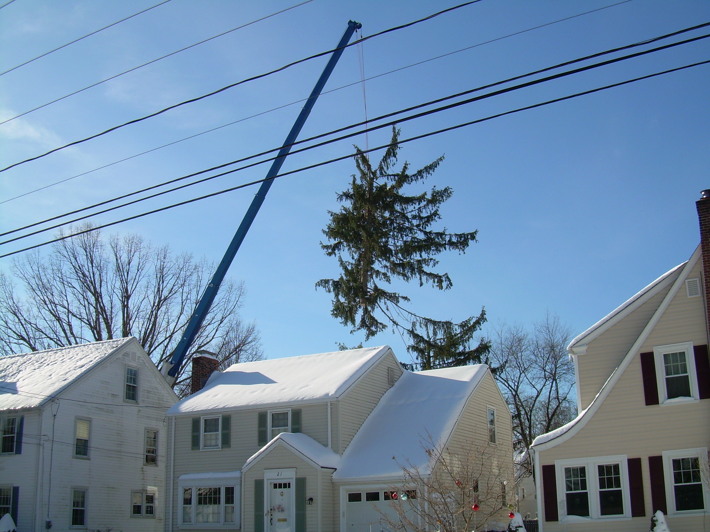

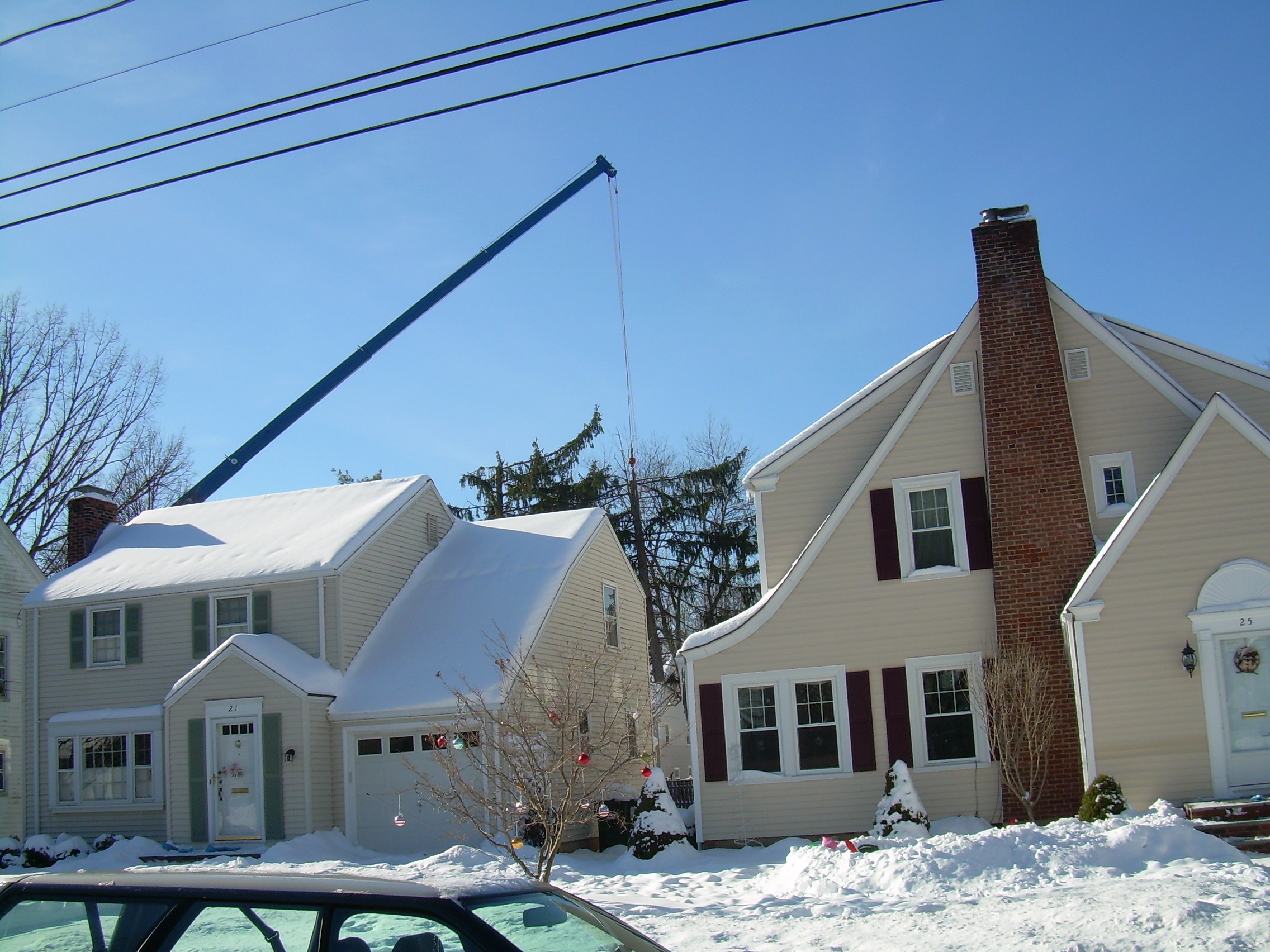

In hindsight it's easy to say , but it just shouldn't of happened.
I don't see that huge of a tree, but it looks like from the pics the section they cut was to big, like they got a little greedy.
gpflepsen, by the looks of the 3rd pic in your post, it seems the outrigger simply sunk in soft ground.
That's quite the recovery effort there but at least it only damaged the house where the work was being done. I saw these guys hoisting cut trees over the neighbors houses 3 doors down.
JB.
If you look closely at the pump, the front outrigger foot and pad are on the street. The jacking cylinder is broke/bent with the end close to the pad.
On the tree of the subject post, the crane could have been lifting (letting down) the upper portion to the ground, hinged on the tree. If the hinge came free, the pendulum swing out could easily pull the crane over. The crane doesn't look to be counterbalanced very much, I don't know if it is provisioned as such. What does catch my eye is the hoist angle of the boom with the truck. The boom was positioned at a fairly good angle with the ground. I'd like to hear the whys and hows to the cause.
Yeah I see the pad on the street now but that's kinda odd that would of put the truck way out in the middle of the road had to move a long way, but I guess as it was leaning way up in the air when the leg broke it would put it right about there.
About the OP if they were hinging the tree and expecting mother nature to cooperate then that would not be very swift. I still think they got greedy and took to big a bite.
Easy to say now, but after going through all the work setting up a crane with a jib and then trying to take it all in one shot...
   / Crane_vs_House: Crane Wins! #27
As for that chunk of oak that toppled the crane - they estimated 6,000 lbs and the crane's rated limit was only 1,900 lbs greater. Isn't there some Safe Working Load margin between the rated maximum and what topples the crane?
Oak is heavy. It seems to me the chunk may have weighed far more, so they were overloaded even before the shock load.
   / Crane_vs_House: Crane Wins! #28
The crane was relatively new, so it should have had a load computer.
The computer would have kept him from overloading, but the bad rigging job, and sudden shift in the load was what caused the accident.
If they were within 1900 lbs of max capacity, then they were cutting it pretty close, as seen in the result. Usually when your that close, extra precautions are taken , and the lift is well thought out. Not the case here.
