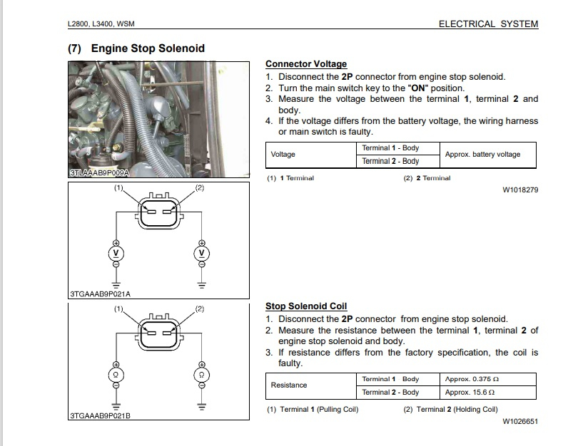

Beezfun, I have checked the two wire female connecter for the fuel solenoid and both connections are getting power when the ignition is switched on. The solenoid works and tractor runs when jumped straight from the battery but does not run when connector is used. So I am stumped. Any suggestions?
Excellent job narrowing down the problem. Can you post a picture of the solenoid and explain how you connect the jumpers that work. Depending on how you're connecting the jumpers that work, it sounds like you may have it narrowed down to the male connector/wire on the solenoid itself.
   / Cranks but does not start #13
Do the two tests shown on this page from the WSM.
Do them carefully!!!!!!!
Once you have done both, report back especially the two resistance values.
Dave M7040
