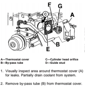

I'm managing to drag this repair out pretty long. To remove a defective cold start advance sensor you need to remove the bypass tube from the thermostat cover, a procedure briefly mentioned in the workshop manual for the JD 3029 engine. The attached diagram is the important part. My question is: What kind of fitting attaches the bypass tube to the thermostat cover (location B)? Is it just a press fit? I've loosened the hose clamps at the other end and removed the hold-down screw. I've applied modest pulling force, but so far the bypass tube won't budge. I'd like a little reassurance that this is the right approach before I figure out how to get more leverage.

Finally put this one to bed. I had a guy come over with a skinnier closed-end wrench and a willingness to apply more force to squeeze the wrench between the by-pass tube and the sensor. After that he was able to remove the sensor without removing the by-pass tube. Back in business at last.
