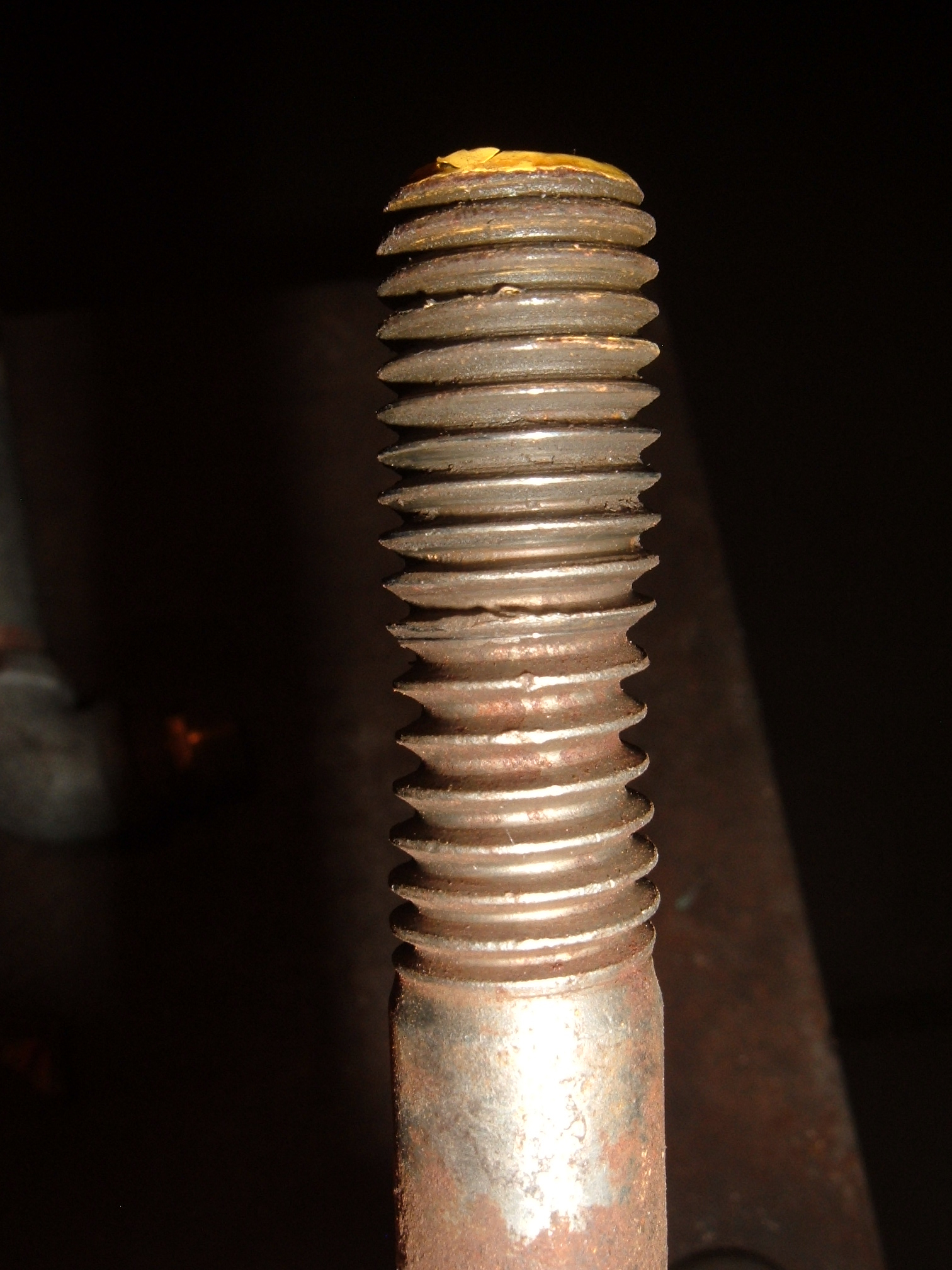

Get all red in the face if you want but I am always curious when others seem to have problems I don't have using the same basic stuff. Ones I use thousands of.
Seems like we woud see a picture or 2 at least since this is such a regular occurance? Same for the broken tools and skinned knuckles. Since its such a problem on such a scale should be easy to come up with something every day?
I will start, I dont recall what we were doing.

Where did you get the bolts?
Are you talking to me? When a bolted joint matters I usually order them from McMaster-Carr. Or sometimes I talk to the local machine shop or his buyer.
Or I simply over-design the bolted joint so that a lower quality bolt won't be a problem. That's the easy way.
