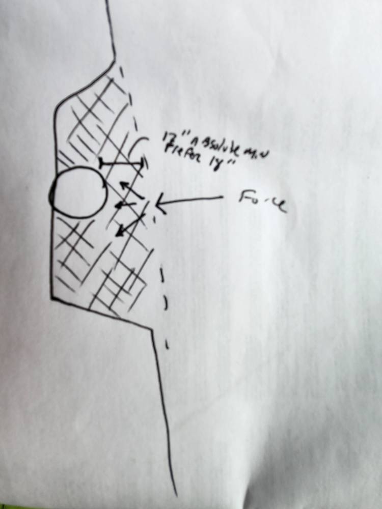

So, I went back and double checked, and didn't see an answer; but what are we driver across it? You said wheel ruts, so its a vehicle; but are we talking 4 trips per day of passenger vehicles; heavy equipment; delivery vehicles; a compact utility tractor; an ATV/SxS? It's not gonna be an answer you like; but I'll just tell you what I would do; money is tight, 100% understand, and based on the 1st post, you have another longer way to get to the other side of the creek; I would either A: wait till you have the spare cash to do it right; or B: try your barrels; your not out any money if it fails. If you really bed them right, compact material, and have sufficient coverage; they might last 5 years. Anything you do to distribute the load will help; force acts downward and also at angles outward, reducing the point load (we are not applying 2000 pounds to the pipe from our point load, it's probably more like 1000 pounds with 6" cover; 500 pounds at 12" cover; and 250 # at 18" cover as the force goes outward as we move further away). I 'Think' if the barrels survive the back fill process (dirt is Heavy, roughly 100-120#/cf) it will last until corrosion eats the barrel. The substandard pipe material makes proper installation much more important, as you don't have the margine of error.
Practicing Engineers in the group, please don't beat my numbers up too much, I pulled them completely out of my butt.View attachment 826437
Thanks for the reply. Brings a good perspective...
It is a seldom used path, the heaviest being about 2600#, my tractor. Only ruts are made from washout. Closer observation is that sometimes pipe gets semi blocked with debris. I tried at one point to create a funnel at entrance, to guide water in. It works until it gets partially clogged, then the rutting gets ugly. Can't drive lawnmower across. The other path, is actually more convenient in most cases.
