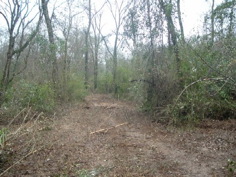

Looking on my topo map, I figured I had a good place to build a lake. The dam will be pretty long and I need to clear quite a bit of brush and trees, but that's all part of the fun.
I pointed the dozer in the right direction and just ran over everything in my way until I ran into this. I had no idea it was there and came real close to another stuck dozer situation!!!

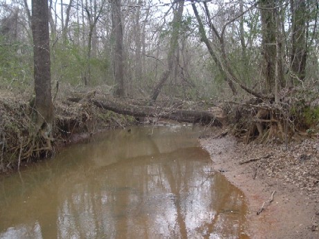

My property line is the middle of this creek. It flows year round, but since I only own half of it, I can't dam it.

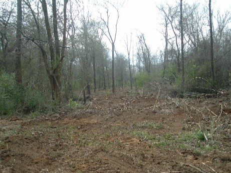

This is where the dam will go. The trees on the left will remain to provide a nice hiking trail along the creek. Everything else will come out.

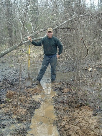

Once dug, the water started to flow.

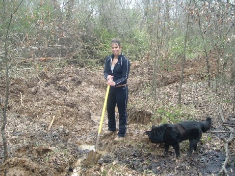

This is my girlfriend. She'd much rather be welding and grinding. The swamp drained down to the trench, but needed some more encouragement.

   / Creating a Lake
#9
Here I am after cleaning up the drainage. It's flowing pretty good now!!!

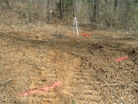

Knowing where the dam is going was the easy part. Figureing out where it begins and ends is turning out to be harder then I expected.
I started clearing an area I wanted it to go, but need it to tie into the existing slope in a spot that will also tie into my plat and road system.
The swamp is six inches deep on this side. I measured from the surface of it and went up six feet with my lazer level.
Then I marked the shoreline in orange paint.
With this little bit of information, I can cut my roads and follow the shorline to the end of the dam.
