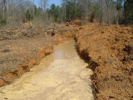

#49
The swamp is going to be an issue. Too much water.
I dug the core trench, or key way, from the farthest I was able to get the backho. Then I followed my marks that I made laying out the shoreline and elevation changes.
The shallower I got, the less I dug. The minimum is 2 feet by 2 feet. I'm 6 feet by six feet at my deepest.
The water came rushing in all along the trench. In places it was coming in so fast it caused ripples and was moving dirt.

/ Creating a Lake
#50
The water will only be about a foot deep in the photo, so it's the smaller part of the keyway.
This is a good photo of how it works to lock in the water and keep the dike, or a dam, from sliding or leaking.
