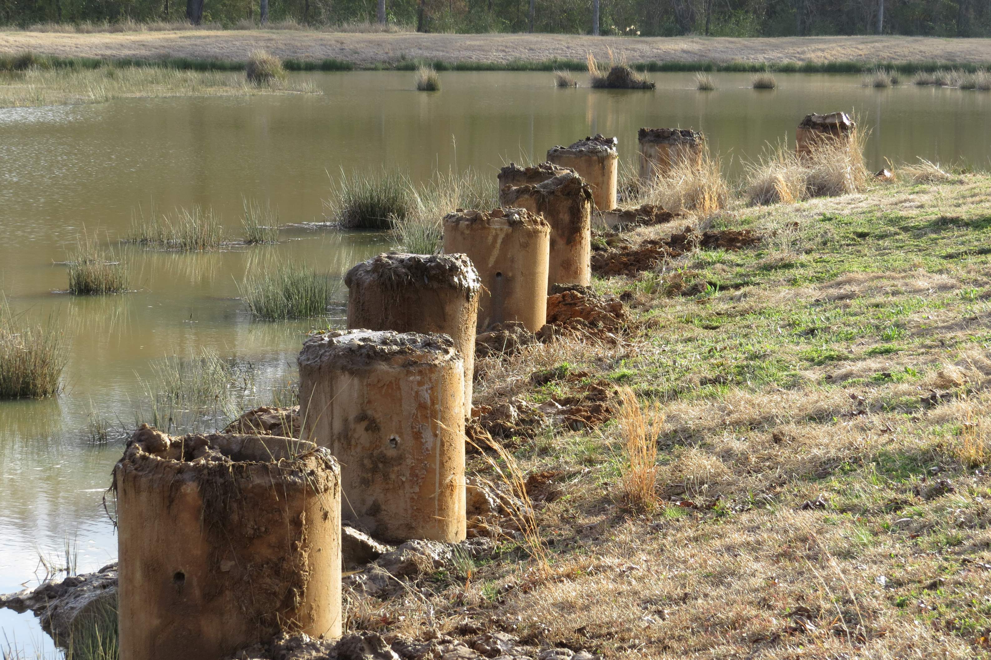

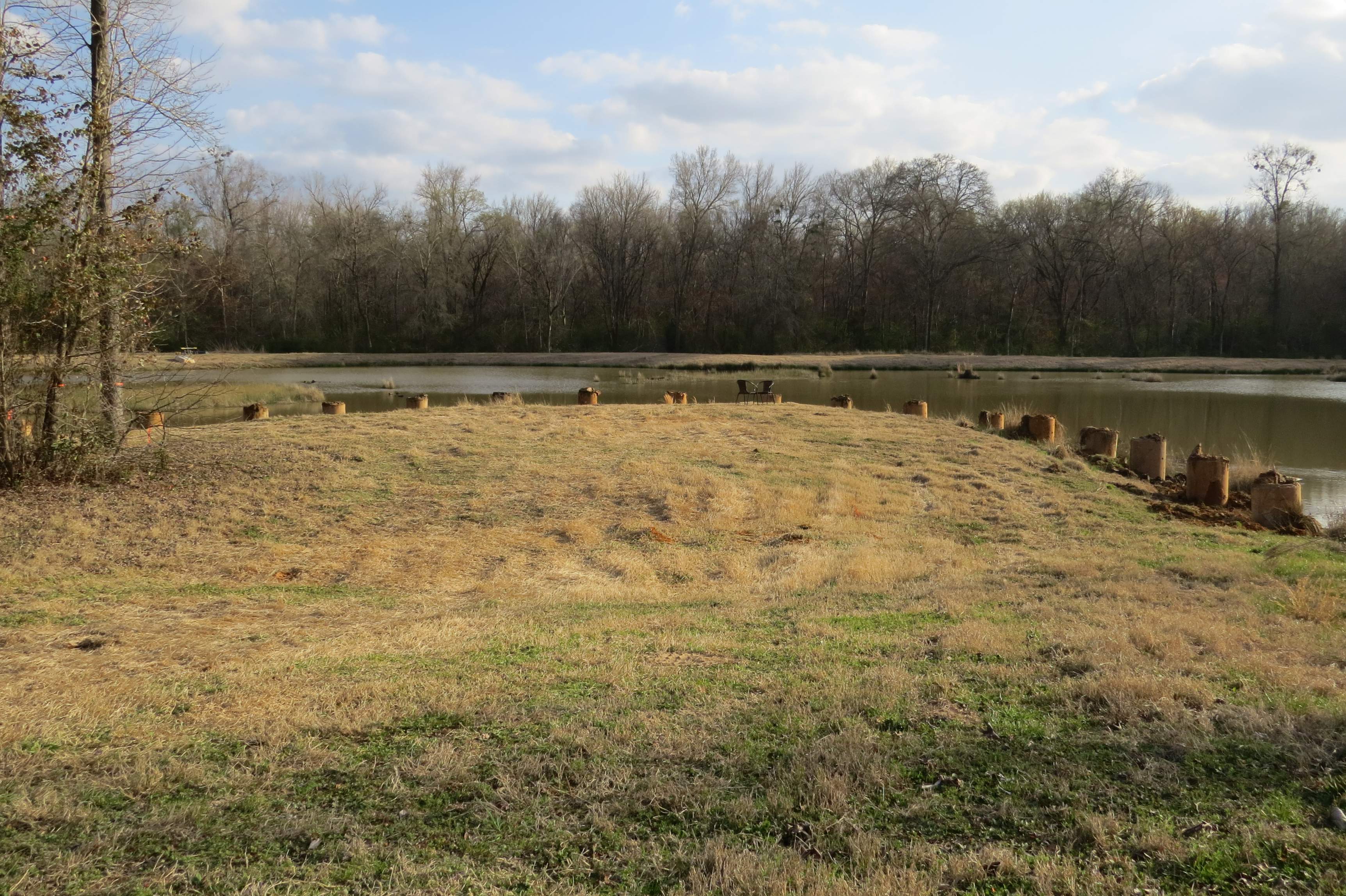

Got ten pipes in the yesterday and the other ten in today. I filled them up with mud out of the pond and let it overflow to help build up the base of the pipes. I don't know if it will matter or not. My thinking is that the dirt inside the pipe will bond with the ground below it and create suction to lock it into place. We are going to wait a few weeks and then Karen is going to start planting flowers.

Interesting idea. I wonder if your native wildlife will commandeer the planters as nests? Ducks, geese...Snakes - eek!

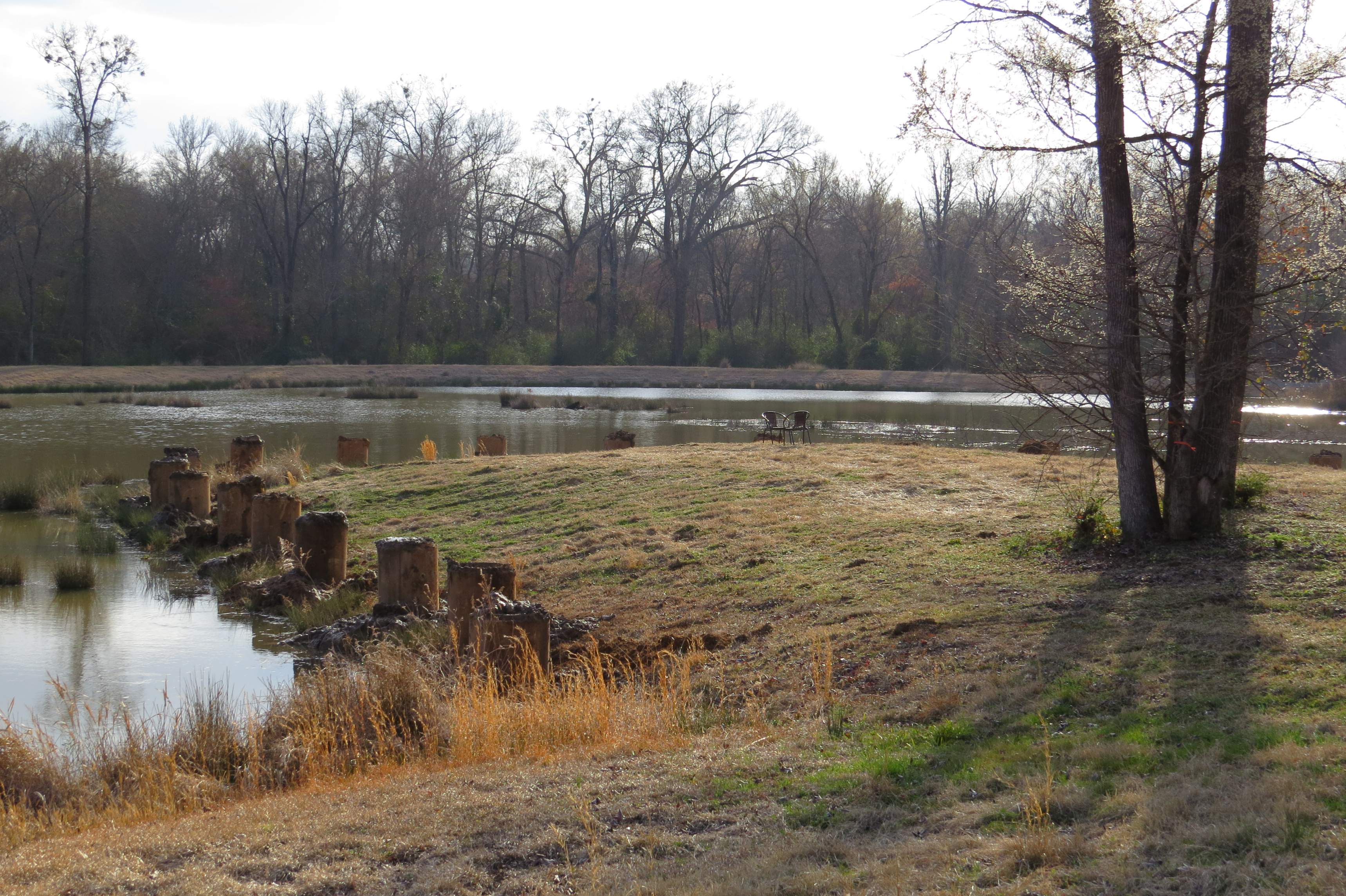

It's begun. First thing we did was have a friend come over and take a few pics of us where the wedding is going to be. When I built the pond, I created a peninsula for a gazebo. I've been wanting to build this from the very beginning, but kept putting it off for other projects. Now that we have decided to get married there, it's become a big priority to get it done. The before pics.

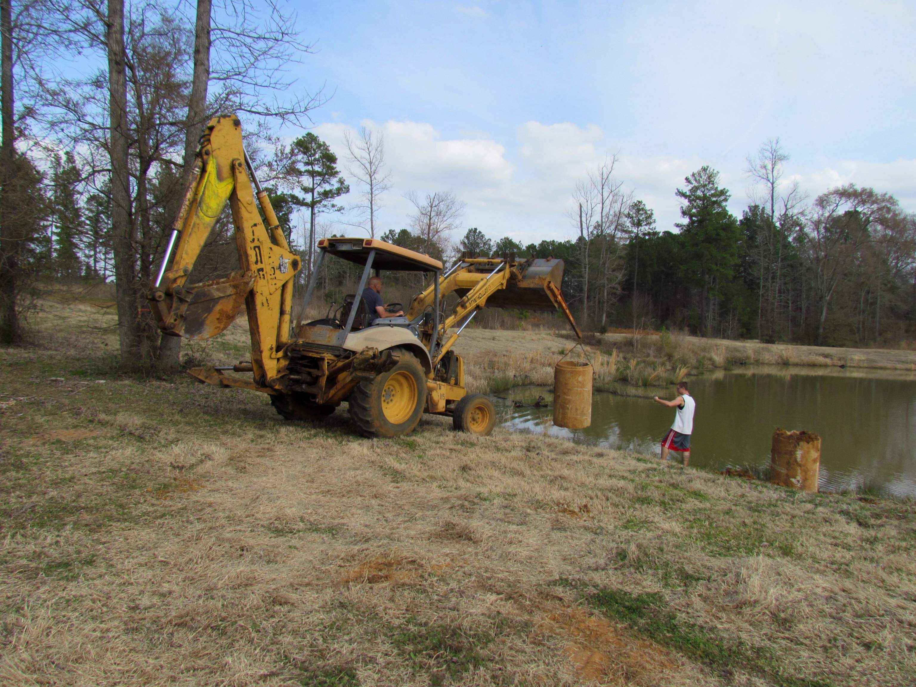

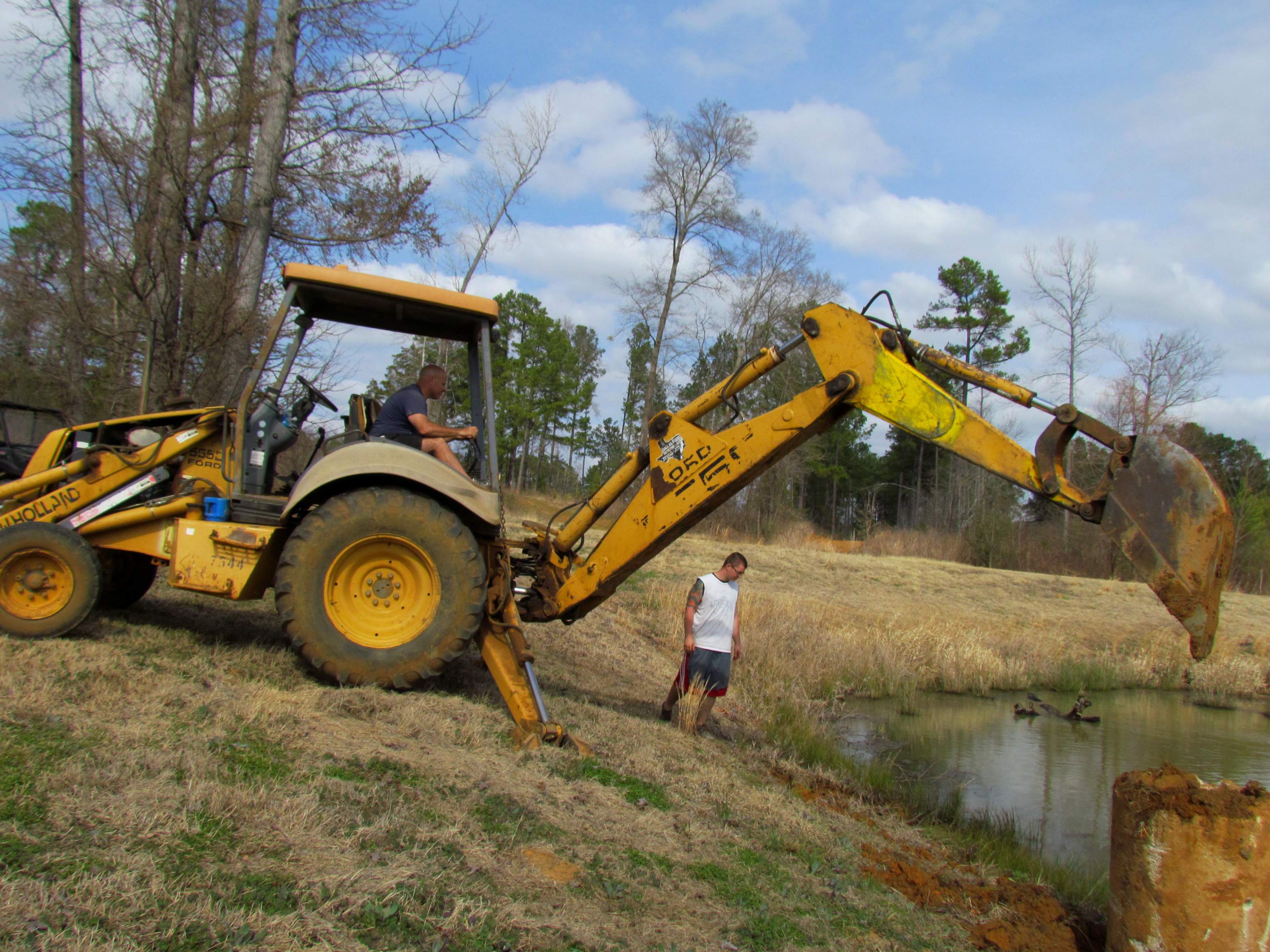

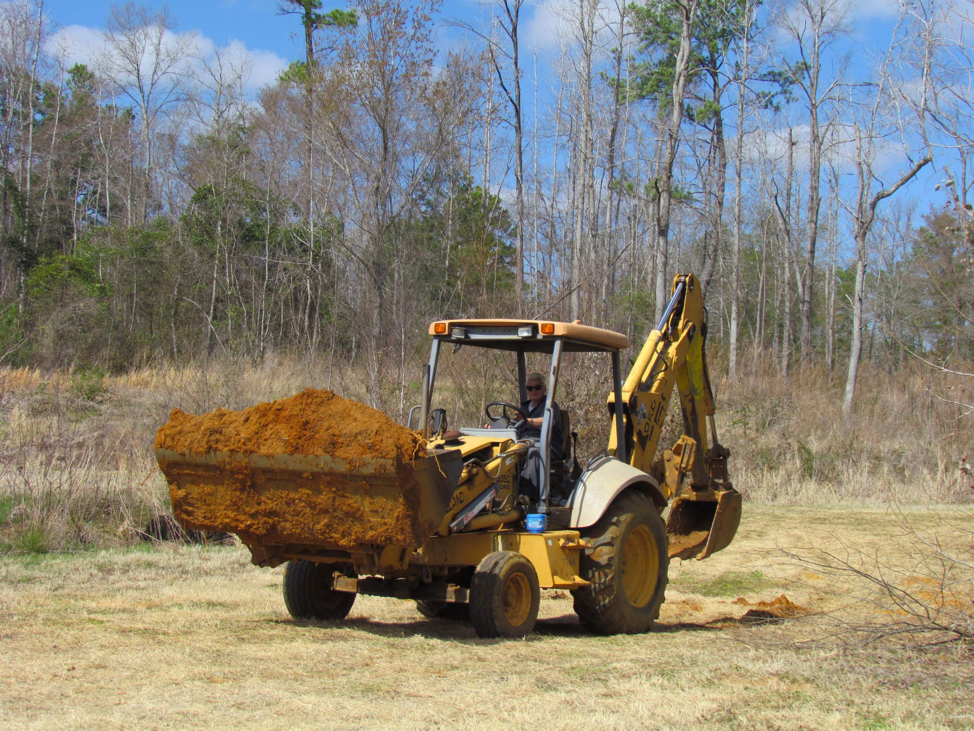

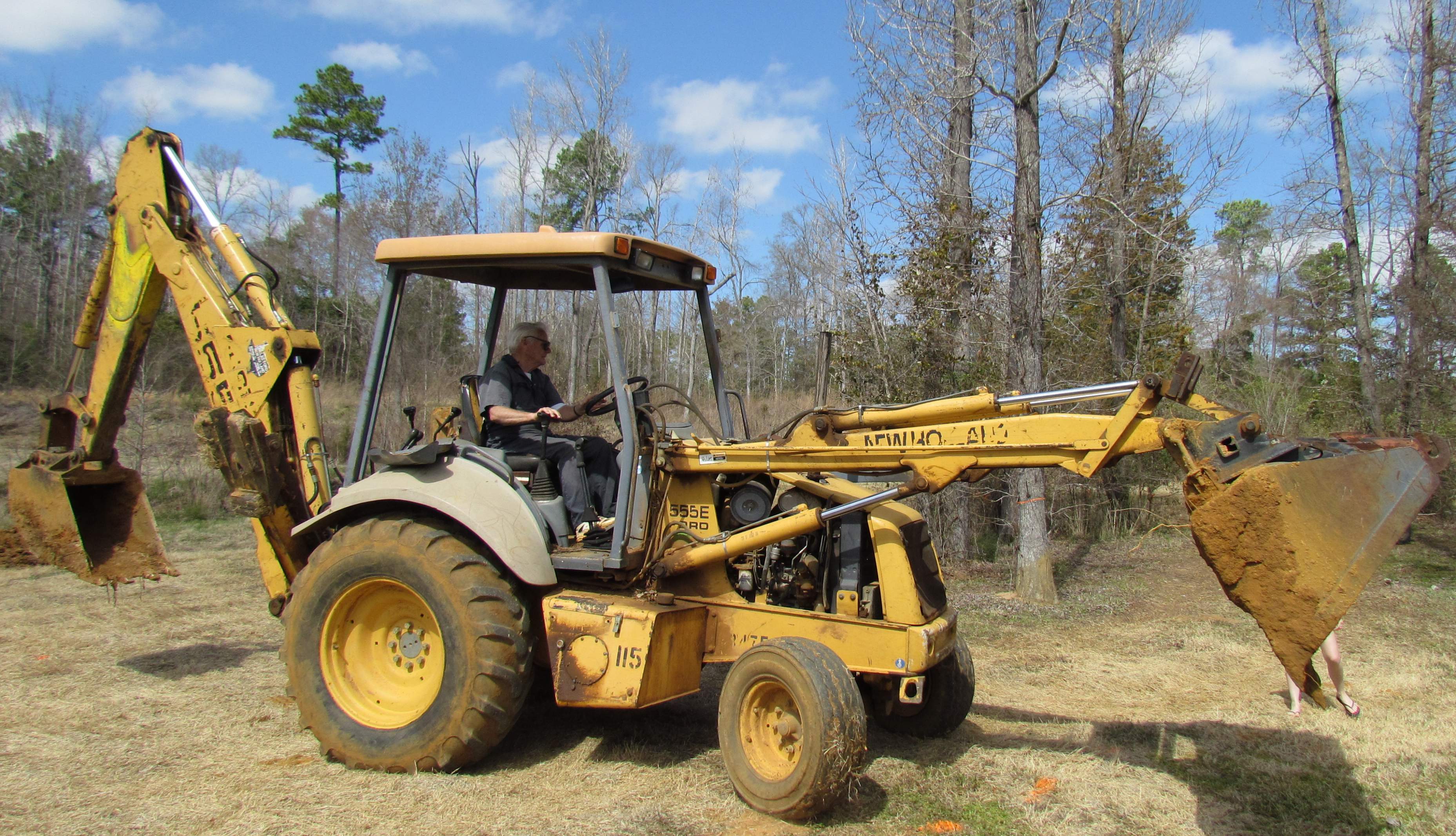

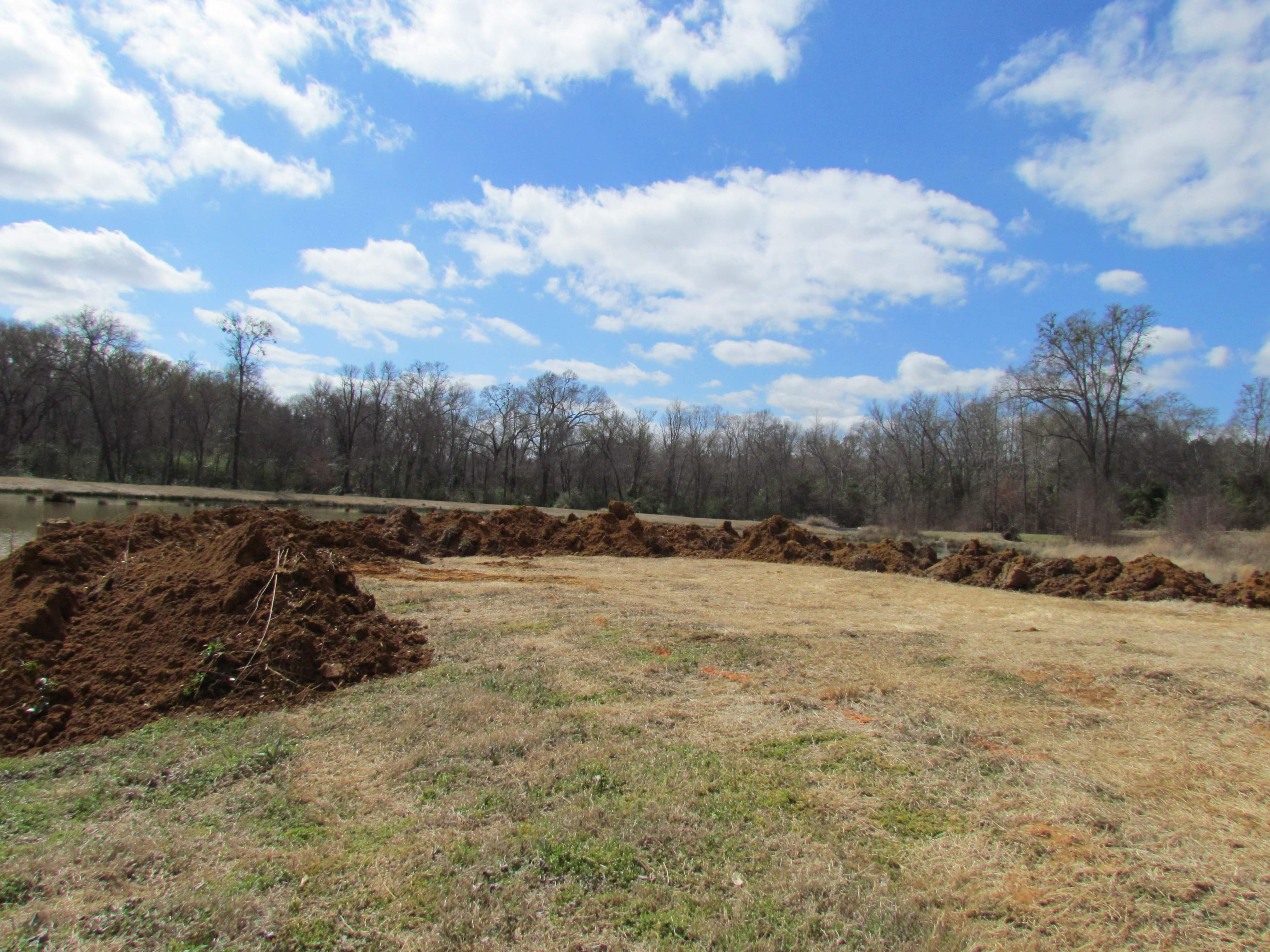

Saturday was beautiful here. Temps hit 80 and we where very productive. One of the consequences to raising the water level 2ft with the concrete dam is that the peninsula will lose a lot of land when full. To make up for this, I got out the laser level and figured where the water line is going to be, and where I wanted the pad to be above the water line for the gazebo. Then I set my dad to work bringing dirt from the ditches I've dug to get more water into the lake when it rains. He figures he has hauled over a hundred yards of dirt so far.
Eddie

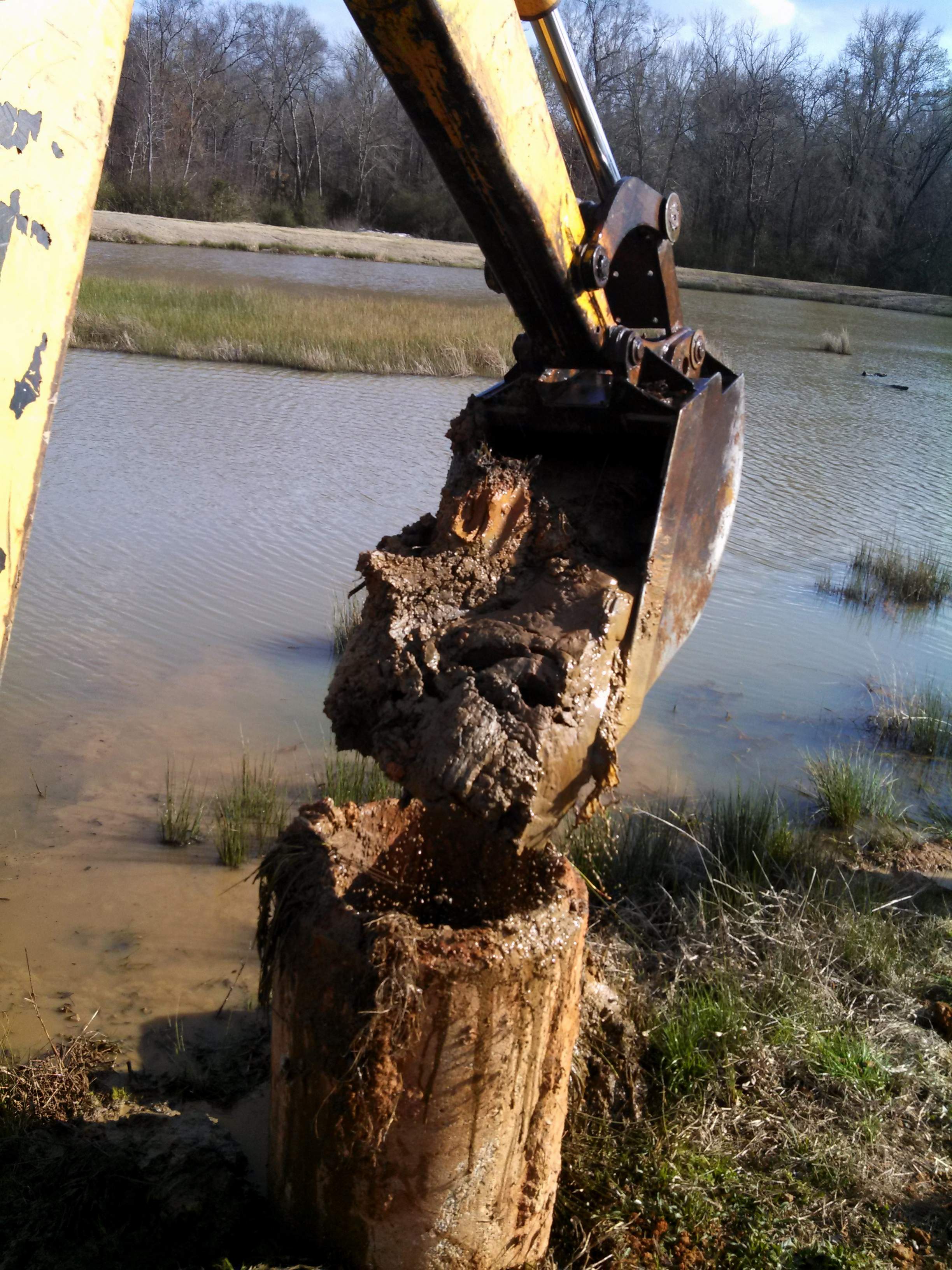

Who is he dumping out of the bucket in that middle picture? ;)

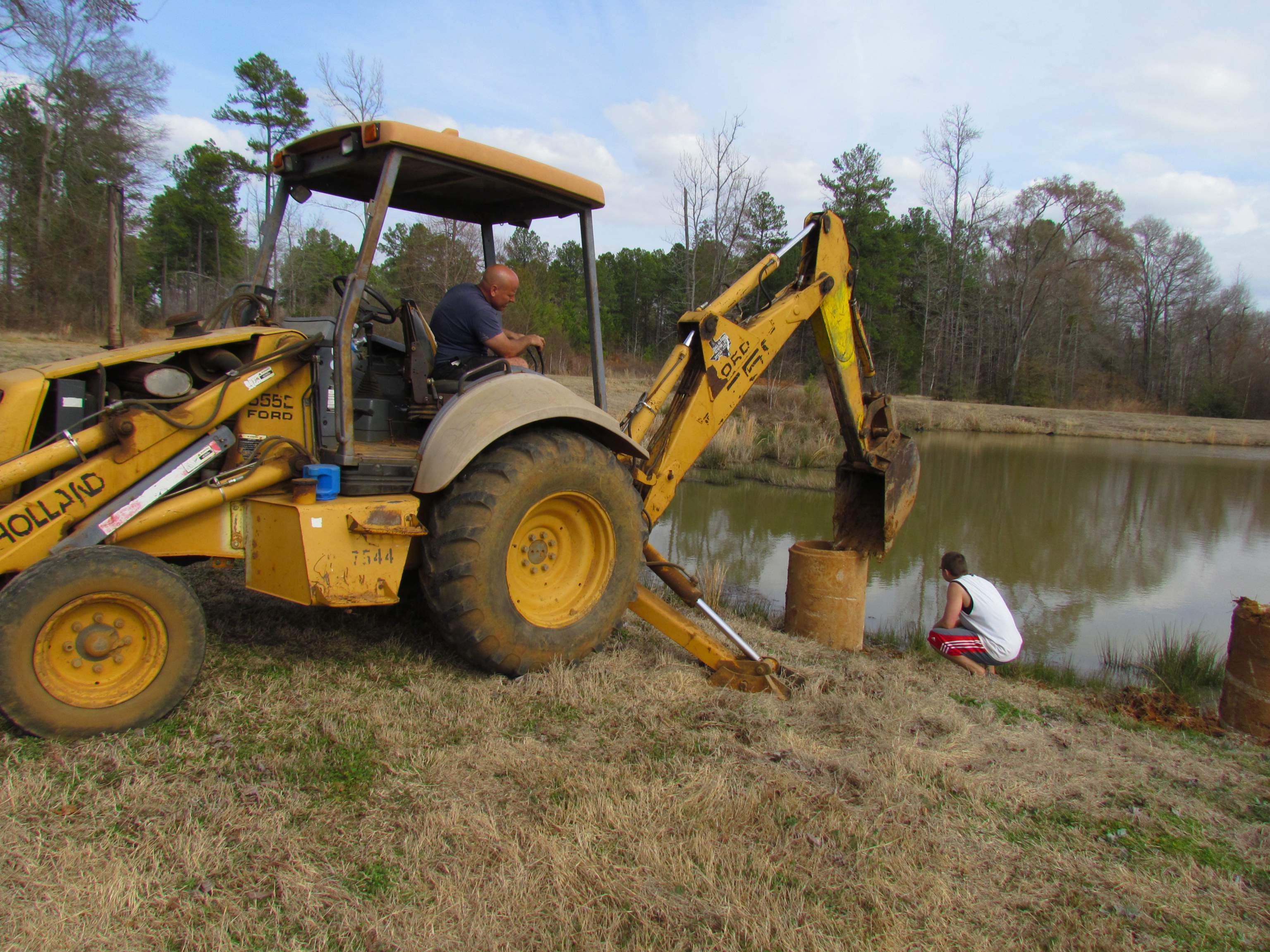

Weather has slowed things down a bit. Dad continued to add dirt to the peninsula when he could, but it was slow going. It's not really dry enough to work like I want, but the forecast is for thunderstorms on Saturday. I got off early today and spent a few hours on the dozer trying to get the shape where I want it. I'm going to take the day off tomorrow and get the footings poured before the storm hits, otherwise there is no telling how long it will be. I can frame in the mud, but I can't move dirt when it's all sloppy.

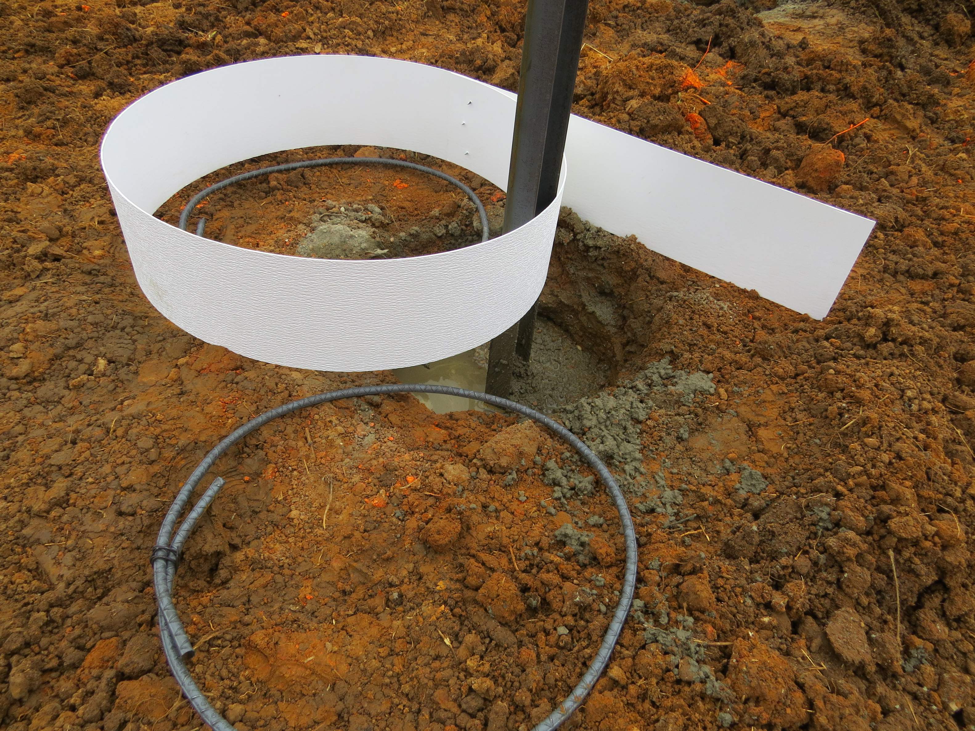

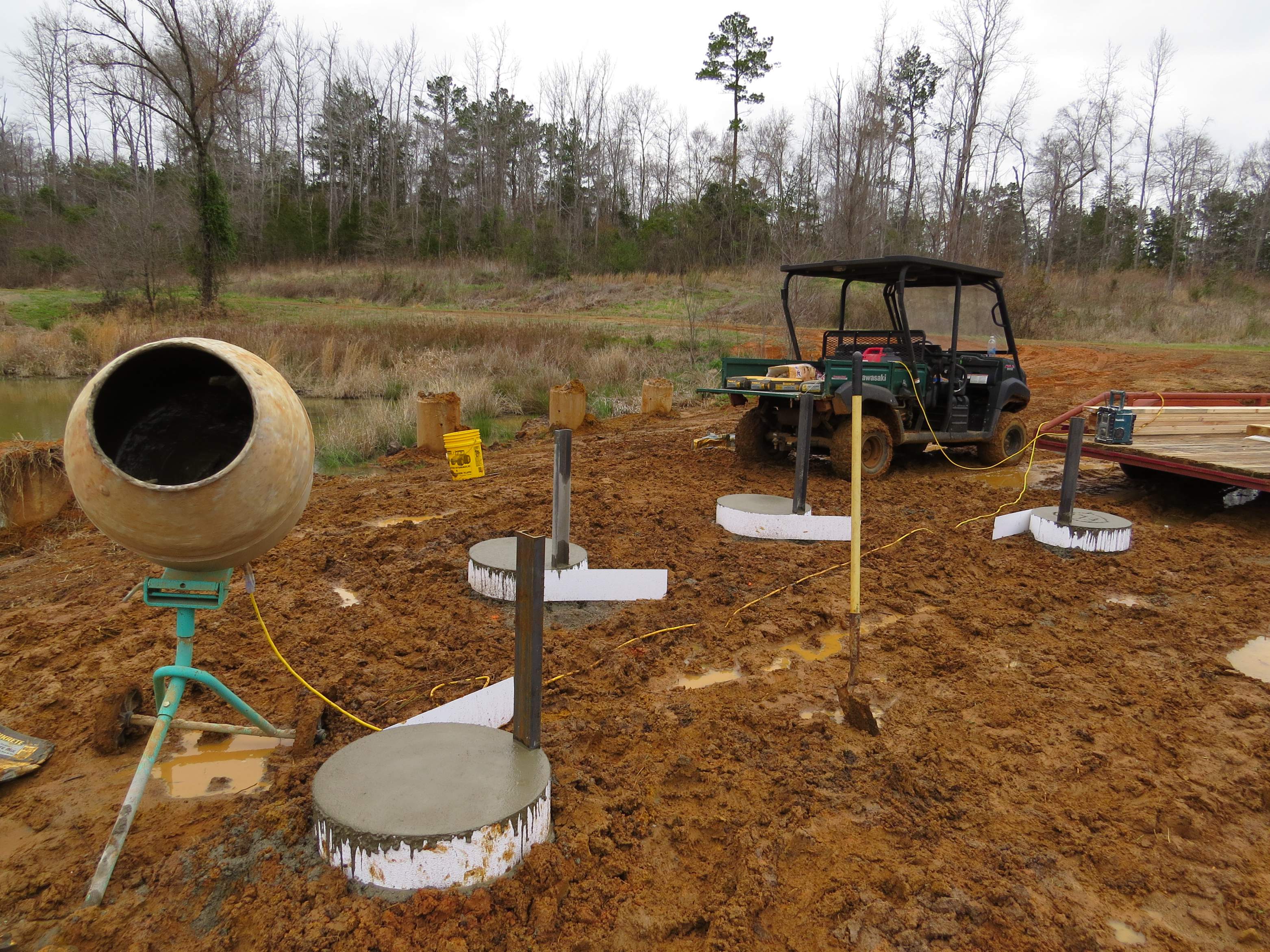

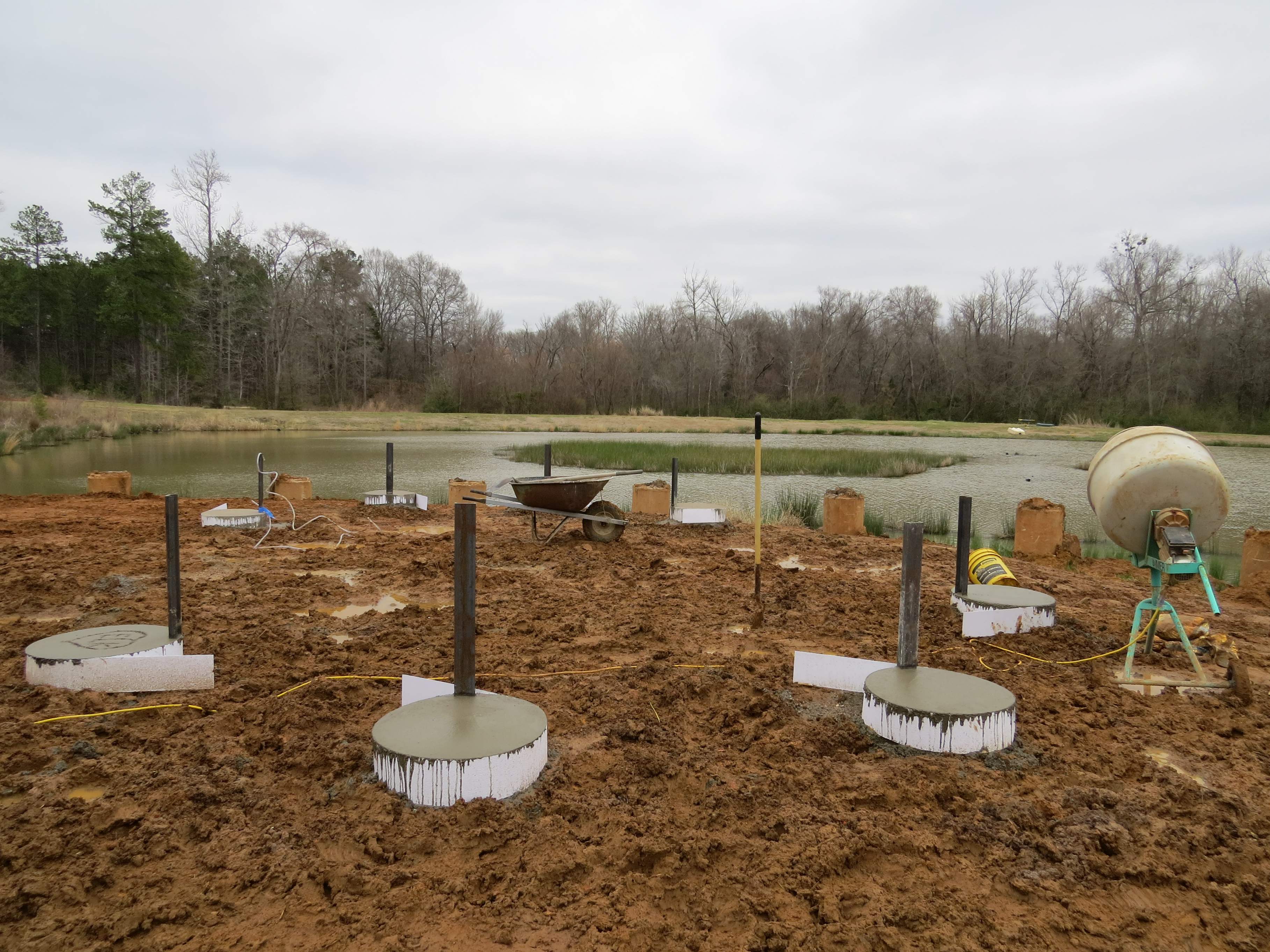

I went to Lowes last night and picked up a pallet of 60 pound sacks of concrete for the footings. I drilled the holes and set the C channel in them with four sacks of concrete, then set the forms and got four of them poured before the rains hit. I also used up every sack of concrete, so I need to get some more tomorrow to finish off the footings for the logs to rest on.
Each hole is 12 inches wide and 3ft deep. The C channel is 3 inches wide and five feet long. The forms are made from some plastic paneling type stuff that they use in mobile home showers and tub areas. Supposed to be water proof, but all I care is it bends real easy. I ripped it to 6 inches so I could get 8 forms out of one sheet. I then used some half inch wood screws to hold it together. Each footing gets 2 pieces of rebar that are five feet long and bent into a kind of circle. One goes in after a layer of concrete is poured, then the other goes in a few inches from the top.

If you got any of the rains like we did yesterday evening, it is probably a muddy mess there today! Is that an electric mixer? back saver for sure.

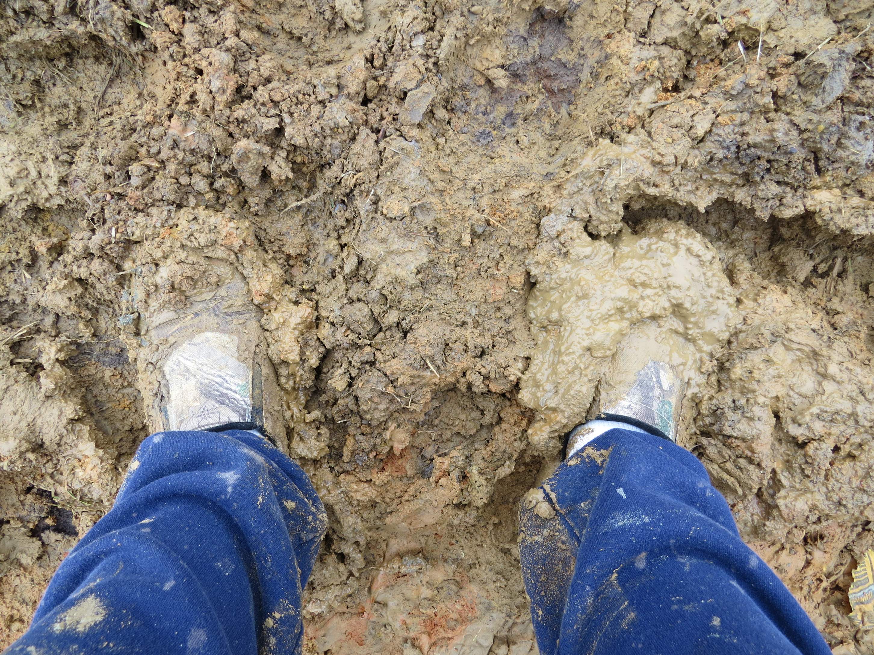

We received half an inch during the night, which is just enough to make a mess of everything. I used up a full pallet of 60 pounds sacks of concrete Saturday, and bought another 20 for today. I used 17 of them for a total of 74 sixty pounds sacks, or 4,440 pounds of concrete!!
The mud made it miserable. Temps where about 60 degrees with a cold wind blowing, but it was all about slipping and sliding in the mud. Probably one of the most painful days I've had in awhile. At least it's done and now I can start working on the logs. I'll deal with the dirt once it dries out.

Eddie - You are a better man then me. I couldn't work in mud like that no matter how important it was to do the deed.:thumbdown:
