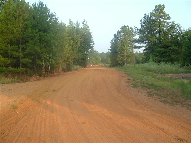

This is the road I'll be using to get in and out on. I've been building it up over the last two years. It's up four feet right down the middle with hundreds and hundreds of yards of clean red clay.
There are red flags going up and down it ten feet apart for the rock driver to lay his trail of material exactly where I want it.

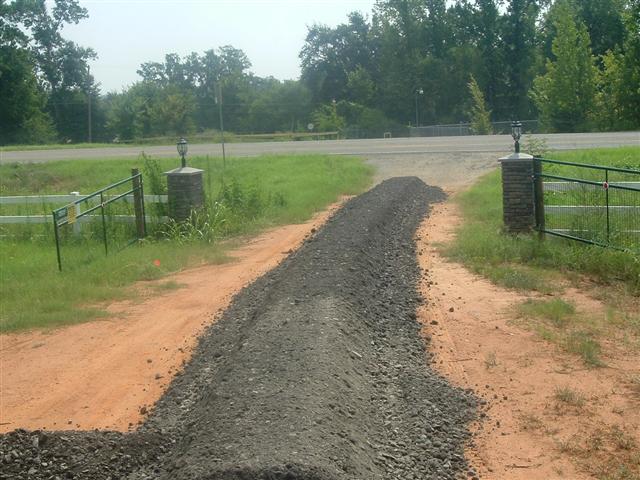

We started right at the bigining with the first load. Each load is in the mid 24 1/2 tons range and good for just over 100 feet long by ten feet wide and four inches thick.
This material is quite a bit darker than what I'm used to, which I expected since it's from a quary that I've never used before. A guy I know told me how to find it and who the owner was. Nice guy, another California transplant!!!

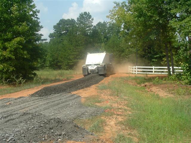

I'm paying $13.75 per ton delivered for this. The other main quarry is in Will Point, which is about midway between Tyler and Dallas. It's also about an hour each way, but that quarry is about a buck a ton cheaper for material, but over $2 more expensive for delivery. Some companies are even more proud of their service than that and want $20 a ton for the same material from the same quary.
These belly dumps really are the way to go for this type of application. After he's gone, it just takes a few minutes to spread it out and make it pretty.
