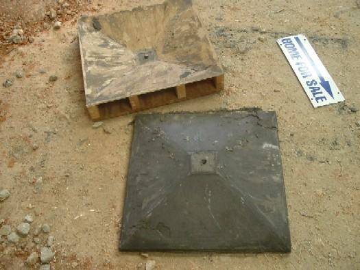

The first cap is out and it's a failure. Several problems. First I should never have used silicone. It is glue for the morter. I had to take off the sides of the form and slide a thin piece of metal throught o break it free. During the process, I broke off a corner of the cap.
The shape is good, and I'm on the right track, just need to make a few changes.
The next one will go in with no silicone and I'll just grind off the edges an sand it smooth. Or at least that's my plan. I will also make the edges thicker by 3/4 of an inch. This will take more morter, but it's so cheap that's not a concern.

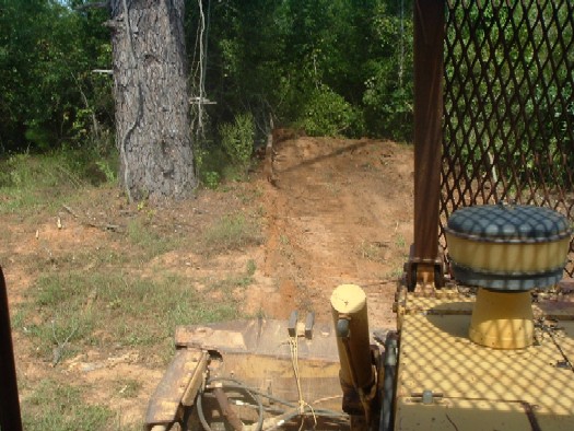

While the new cap is in the mold, I decided to take out my dying pine. It's bigger than any tree I've ever taken out, and I'm a little intimidated by the damage it could cause if it fell on me. It's right out in front and will fall in time if I don't address it now.

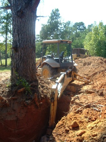

The bigger the tree, the deeper and bigger the hole around it. They really don't want to fall over and it takes some encouragment on my part. This photo is the back side of the tree and I ended up going around 10 feet deep.

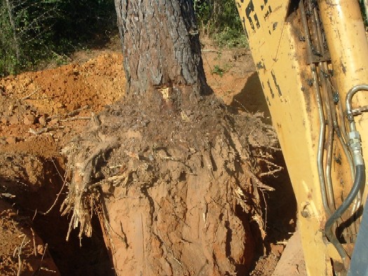

Once I got a good trench around the tree, it's just a matter of pushing it over. Of course, the wind started blowing in the wrong direction while I was almost done digging. It makes me real nervous being on the downwind side of it. Once enough dirt is out, it will just lay down where I push it.

Eddie, I've wondered whether wax paper would work; never heard of it being used and there may be a good reason, but it just seems to me that it would work. Or butcher's paper. /forums/images/graemlins/confused.gif

Nope, the best is to use nothing. For a wooden form, watering down first doesn't hurt, but nothing else will help. I built a few and had to learn the hard way also.
