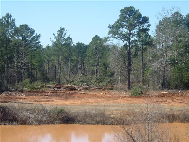

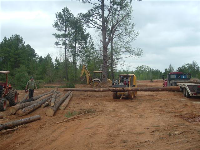

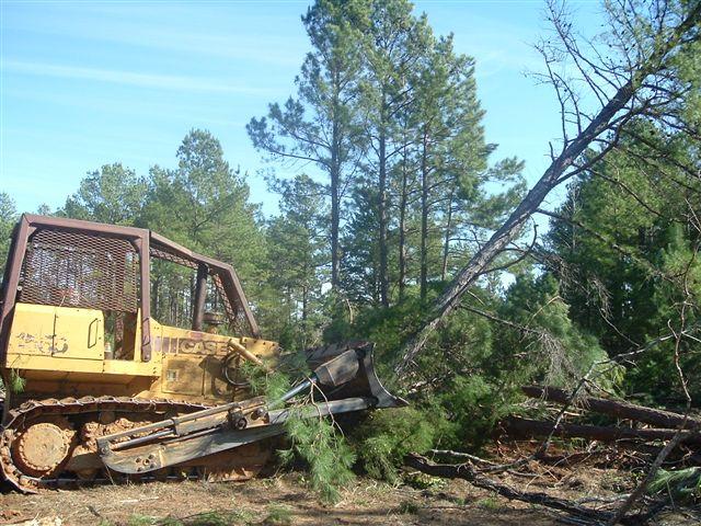

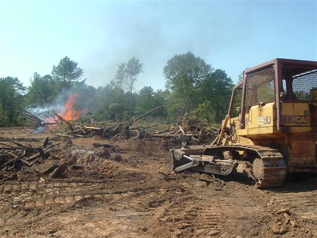

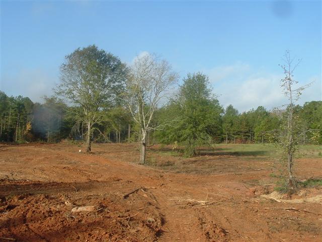

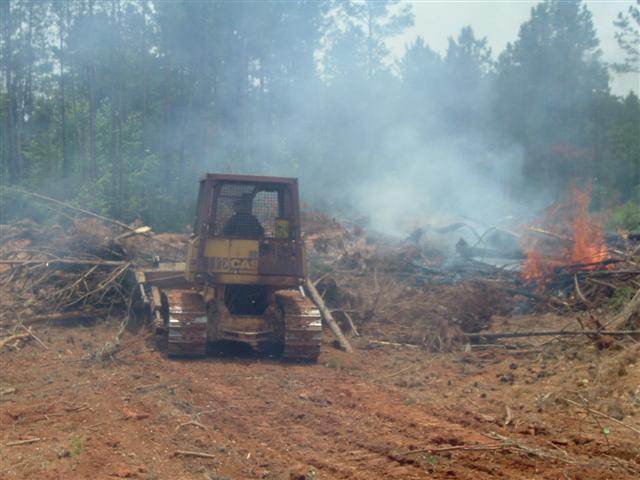

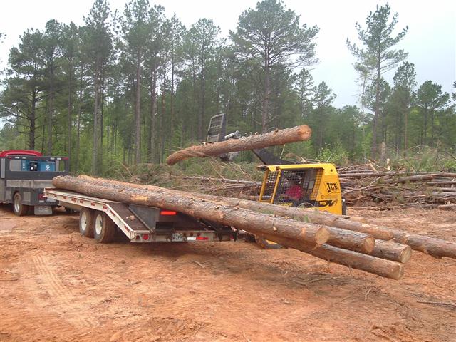

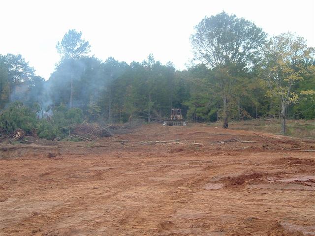

This is something that I've been working on for over five years and think that I might actually accomplish in the next few months. For those of you unfamiliar with East Texas, it's heavily wooded with pines and hardwoods. My place was extremly thick and almost impossible to walk through.
I pretty much started at the begining and cut openings into the timber with my dozer and backhoe. Then I made those opening bigger and bigger until I had an open area.
I tried to sell the trees, but nobody was interested. I talked to several dozen logging companies with all sorts of replies. Some said they were not interested, others said they would be there on a certain date. None ever showed up. I had a thread going on this back then and found out that Harvey had a friend who wanted some logs. I gave him all he would take!!! Luckily, Harvey was able to come over and help load them up for him.

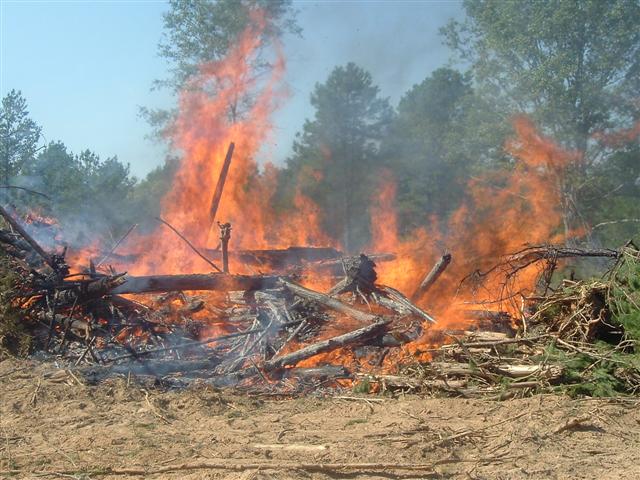

After that, I started to burn!!!!

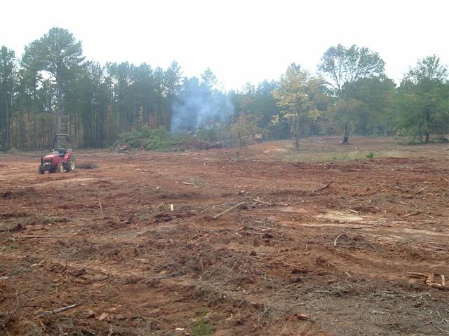

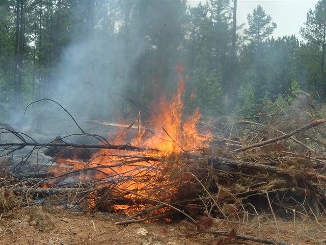

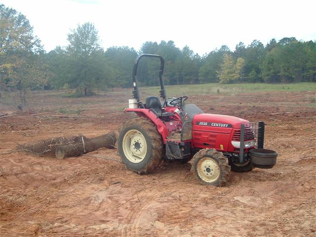

I've been burning trees for years now. It seems to be never ending, but looking at these old pictures, it's also kind of amazing to see the changes. Some of the trees that I took out were massive and I was hesitant to remove them. Now I find it dificult to remember them and there isn't a one of them that I miss.

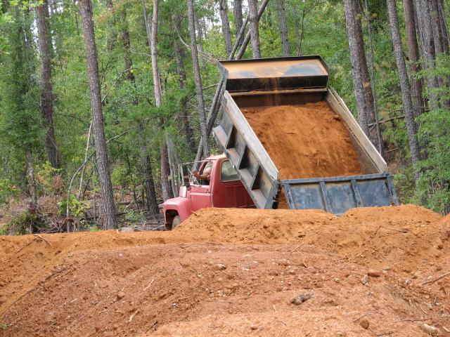

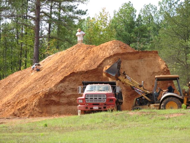

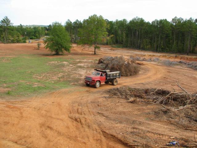

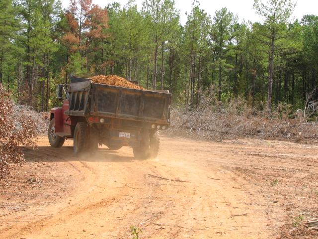

I got sidetracked by other projects like building my house and digging my lake, but never forgot about clearing my pasture. In 2006, I started moving dirt and piling it up for use in other areas of my land. This turned out to be a pretty big mountain of dirt, that I'm still working on today.

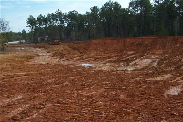

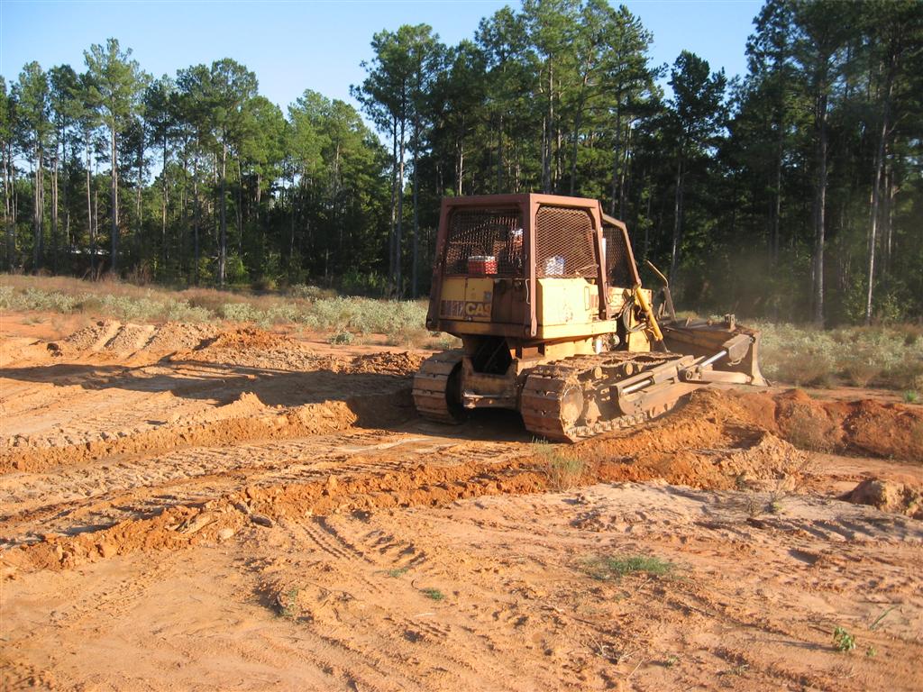

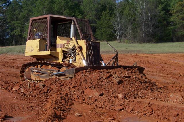

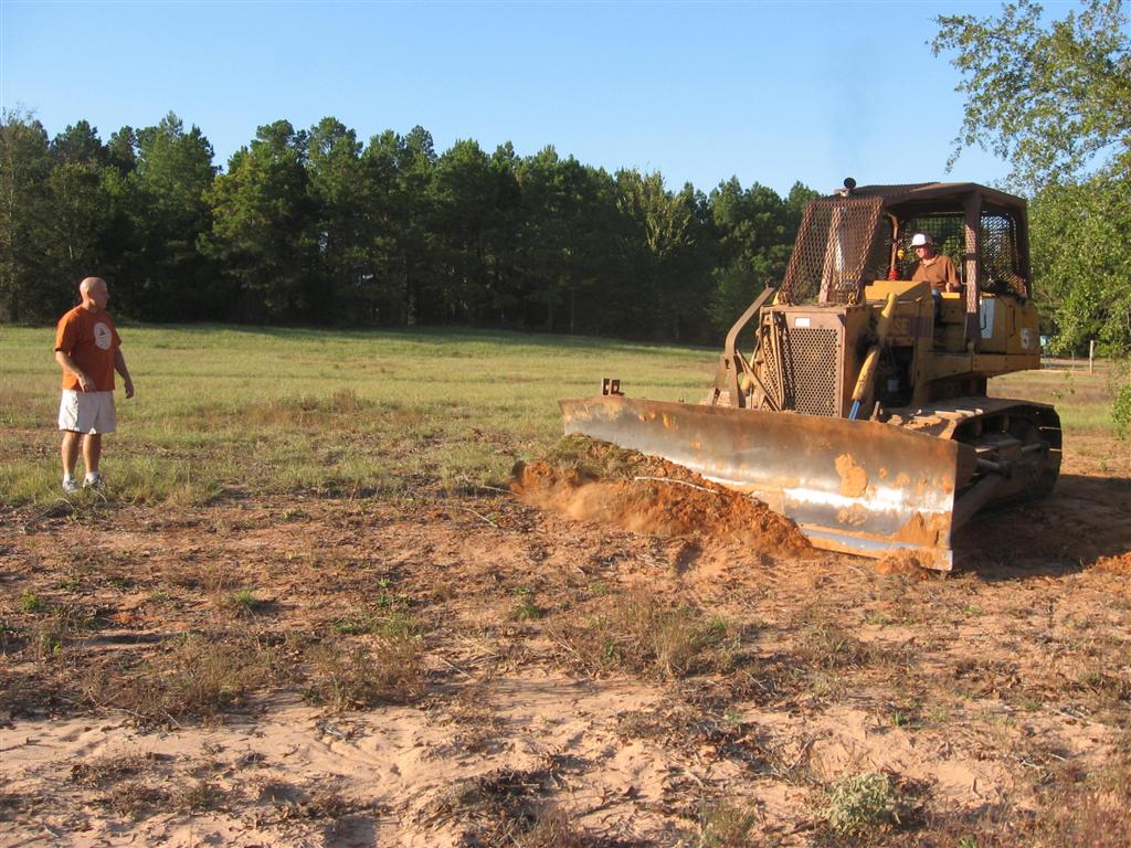

This past October, Steph and I hosted a TBN get-together here. Rob and Don both wanted to drive my dozer, so I let them start on digging my trench through my pasture. The lay of the land is such that when it rains, half, if not more, of the water that lands in my pasture doesn't make it to my lake. I dug a trench with my backhoe through the high spot of land and was able to increase my watershed by a significant amount. Instead of leaving the tranch there, I want it to look like a natural area that cuves with gentle slopes.
To do this, I need to move allot of dirt. The dozer is perfect for this. It moves it short distances very quickly. Rob and Don got it started, I've been working on getting it finished.

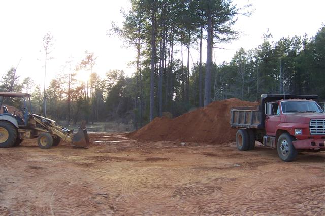

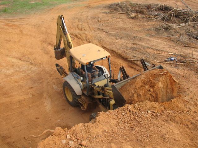

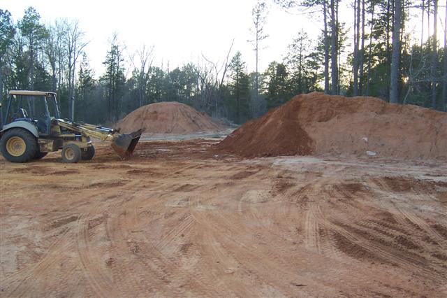

I went to bed last night thinking how much dirt I was going to move today. Then a client called this morning, and I didn't get started on moving dirt until this afternoon.
Once I get the first few loads dumped, I get into a rythem and it becomes allot of fun!!!
Here's a couple pics that I took today.

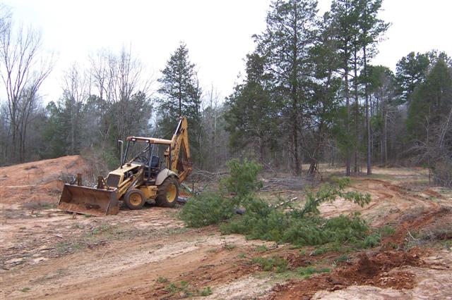

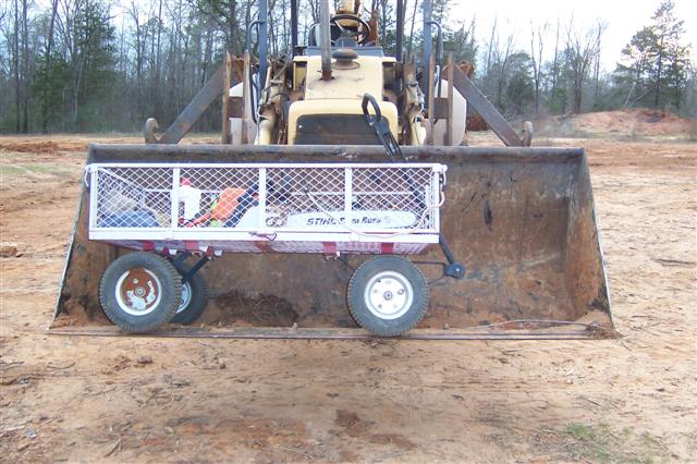

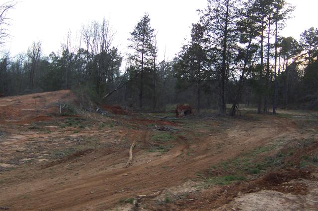

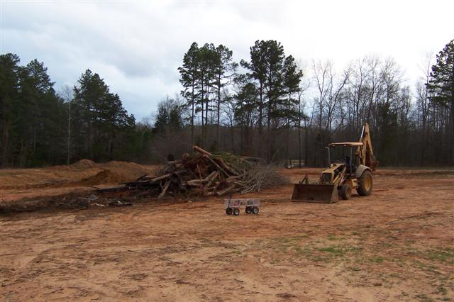

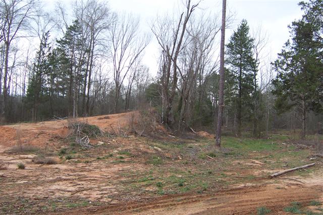

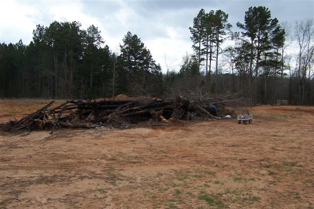

I figured it would take me two days to haul off the rest of the big dirt hill. Like always when estimating how long it will take to move dirt, I was wrong. Three very long days to get it done!!!!
There are two more dirt piles to move, but I'm tired of moving dirt, so I thought I'd work on my burn pile. The forecast is for a big storm to come through, so I like to burn just before it hits to cut down on the potential for a forest fire. The only other time that I feel safe is right after it rains. The winds were really kicking up, so I decided to pass on the burning, but still work on my burn pile.
Trees are very hard to burn when full length. Cut them into a few pices and they burn right up. My pile had about 20 full length trees in it, plus twice that many saplings. I've been burning it off and on for the last few months, but not realy getting anywhere with those full sized trees. Today, I pulled the pile apart and cut the trees into shorter lengths, then piles them back up again. As you can see in the picture, the burn pile is half as long as it used to be.
The trees along the third dirt pile have to come out. It's what's left of where teh targets were located for Rifle Range #4. My land was part of Camp Fanin, a World War 2 Army Base. The bullets flew over the dirt and the soldiers hid behind the dirt piles. After shooting, they pulled the targets, marked them, and put them back up again. All that's left is some comcrete and a few pieces of creosoted 8x8's. The trees have had since the base closed in 1945 to grow. Some of them on top were absolutely huge. These are pretty small and came out real easy.

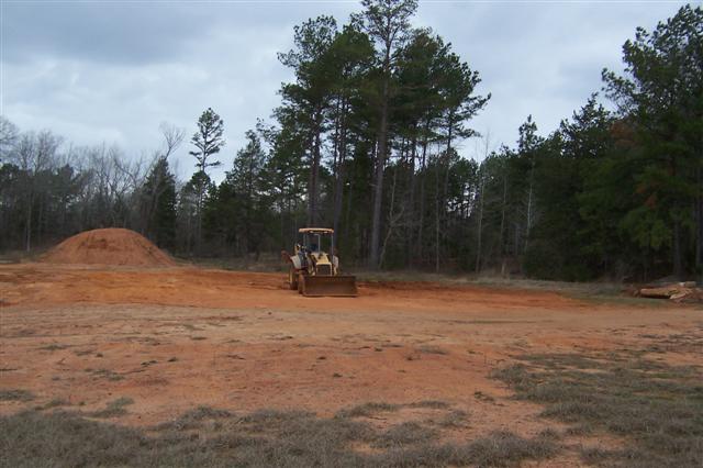

I'm still moving dirt. But I've finally found the fastest way to do it. I'm parking the dumptruck next to my backhoe, and then loading the dirt with the hoe bucket. It's allot smaller then the front loader bucket, but since I have to use the backhoe bucket to dig up the ground, the time lost by loading with the small bucket far exceeds the amount of time that it takes to dig it, dump it, and then come back later and use the front bucket to load the dirt into the dump truck.
When I'm done digging with the backhoe, I come back through with the front bucket and scoop up the loose material that I missed with the backhoe bucket. It's amazing how much more material I can move this way!!!!
I also got to the point where I ran out of room for more dirt, so I spread out what I'd dumped on my road. My road had alow area that I'm fillng in. I need it to be wide enough for two way traffic as well as pedestrian traffic. 30 feet at least. Then it has to rise the length of the road so that when I put a sewer line under it, I can maintain my grade and still have 4 ft of dirt above the sewer line.
The dirt piles hold all sorts of water when it rains, so the longer they sit, the harder they are to work. The dirt that I just dumped worked great. Perfect moisture content. The dirt that I dumped last week and earlier was misserable. It was as bad as being totally impossible to work, to just being too wet and not able to compact. Because of the moisture issues, I shaped the road with more angle to it then I wanted, but this will help shed water, so the clay will dry out faster. I still need another layer of dirt, or close to 600 yards.
