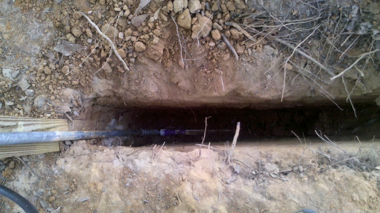

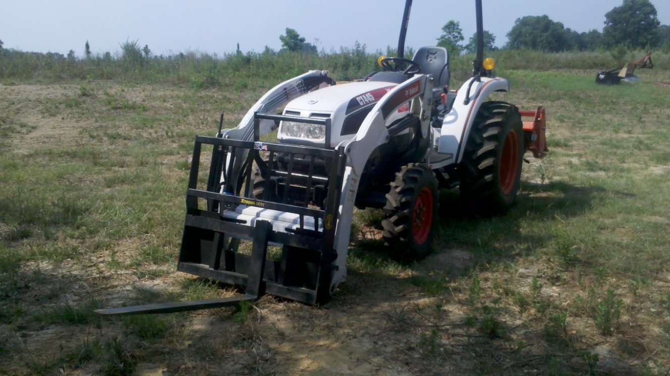

I had a underground leak at my farm near a water faucet and since I knew it was about 30" down in rock hard Alabama red clay I wasn't relishing the idea of digging it up - particularly since it is so dry right now. Really didn't want to use the bucket and root up a large area.
Had an idea. Removed one fork from my pallet fork attachment and used the single fork for 90% of the work. Used a skinny trench shovel to finish the last few inches. Worked great. :thumbsup:

That is a clever idea, and hope I will remember it when I need that idea. Your fork must come off easier than mine, as I'd have to dismantle a bit to get one off. But for a neat trench in clay, that just might be worth the extra effort.

That is certainly a cool idea, and from the pictures one that seemed to work pretty well for you.
   / Creative use of pallet fork
It did work far better than I expected - likely due to the clay being very dry and hard. You can tell from the pic there wasn't any issue with the trench caving in on itself.
Beenthere, yep, the forks remove easily. Slide them to the middle, tilt the heel away from the frame (there is an associated cutout in the frame) and lift the fork up and away. No tools and takes less than a minute. These are made by Construction Attachments.
