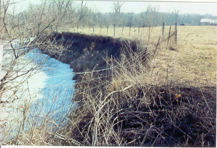

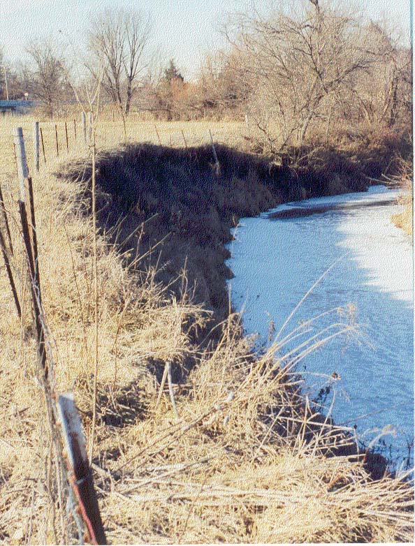

I wanted to give everyone an update on this project. The fisheries biologist came out today and took a look at the creek. I was impressed with her friendliness and professionalism, which I haven't always appreciated in other state employees.
She suggested that the "ultimate" way to fix the problem is also the most expensive, to the tune of up to $50,000. Ouch. That's the bad news. The way to do this is to construct several rock(big riprap) jettys out into the creek anchored or "keyed" back in trenches along the bank. She said this approach can actually build back the bank with the water collecting silt etc. along the jetties over time. The jetties have to be put in properly and downstream enough that the current doesn't cut back and do the same thing as before, just downstream a little.
The good news is that she thinks the bank might be stabilizing. It has probably worsened over the past 10 years by a channelization project for the bridge just upstream plus development upstream too. She was very sympathetic about my not having that kind of money to spend and suggested monitoring it with stakes or t-posts driven near the edge and planting a bunch of native willows or cottonwoods along the top bank and the bank that has slid down. She gave me some good ideas about stabilizing gullies too. The trees won't hold the bank if it really decides to cut loose through there but it's worth trying while I watch it to see how much it's going to stabilize. I can plant a whole lot of seedlings at 25 for 4 bucks. By the way, the jetty project requires an engineer to design and 3 permits. One is a type of flood permit for the engineer to verify that your project won't convert someone else downstream from a 100 yr flood plain to a 5 yr flood plain or something similar.

I seem to have read something somewhere where during low water that some people have buried stumps upside down in the banks, sometimes with cables and cement blocks attached to hold them until mother nature takes over. This has more of an ability to catch silt and promote fish habitat and then some old erosion methods of "armoring" the sides with cement etc., which is probably now illegal anyway.

I don't know the answer to the trees and roots loosening up the bank in a windstorm. I guess it's possible but usually what you see at least around here is the creek itself does the damage because of higher water volumes cutting it deeper and faster and it loses it's natural ability to flood. They recommend at least a 50 foot buffer zone of trees and vegetation on a creek like this.
I didn't ask her about the straightening idea but I get the feeling it would probably require a permit too. I would need the cooperation of my across creek neighbor to straighten that one bend and I doubt I could get it. I think I'd also have to pour in a lot of rock to do that, the way the creek is configured. If I went farther upstream near the bridge and straightened like Richard did on his creek, making a bypass of this entire loop, I'd have to cut a big trench and would sacrifice too much land. This configuration would also make the water run through there like a log ride at an amusement park. There are definite tradeoffs in all these approachs. I'll content myself to plant some trees, monitor it and see if I can find somone who could do put in the jetties for a reasonable price if I need to go that way in the future. I just remembered yesterday that I know some people who have had a lot of similar experience fixing levees along the Grand river in central Missouri so I'm going to see if they might want to travel over here and do some work in the future. This would be a small job compared with the stuff they usually do shoring up along the wild Grand.
