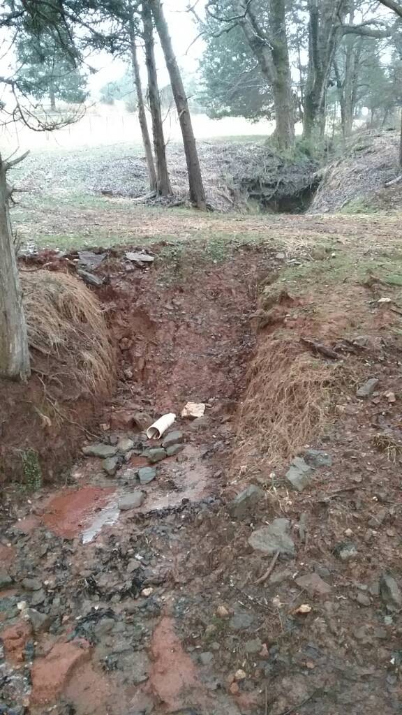

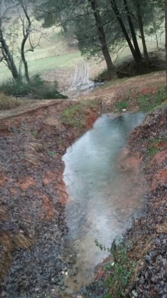

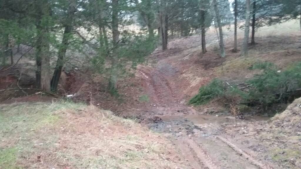

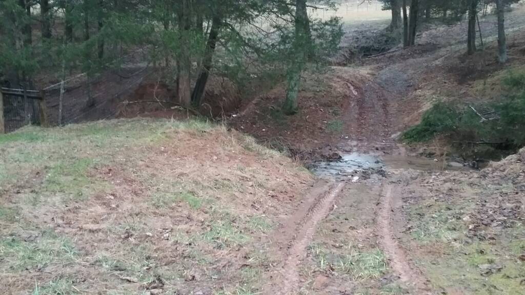

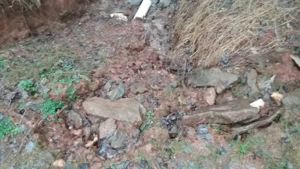

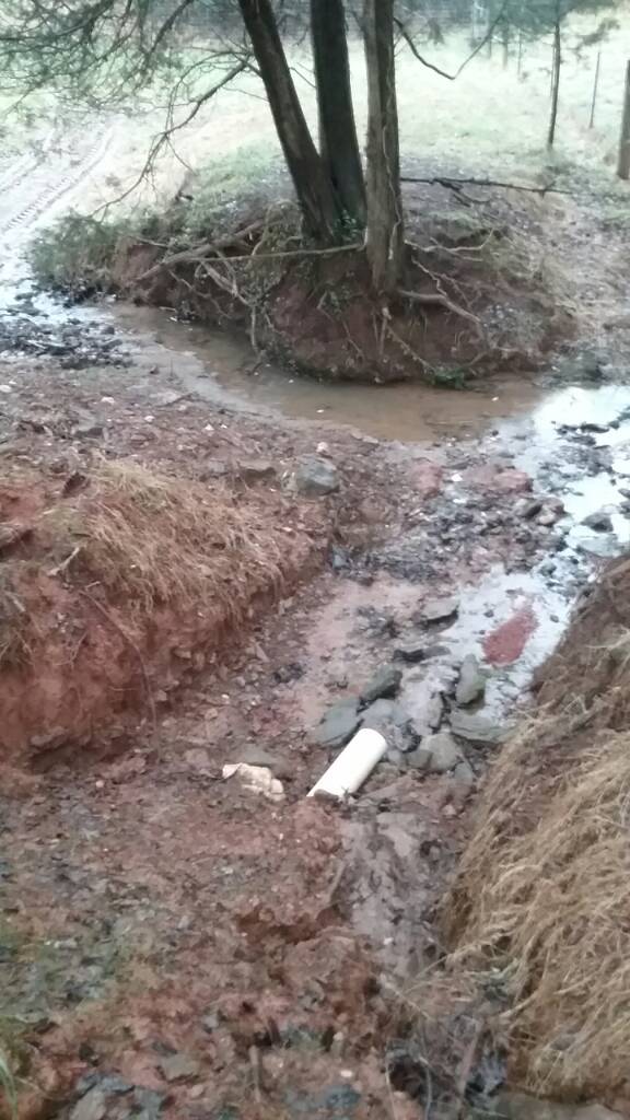

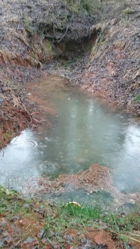

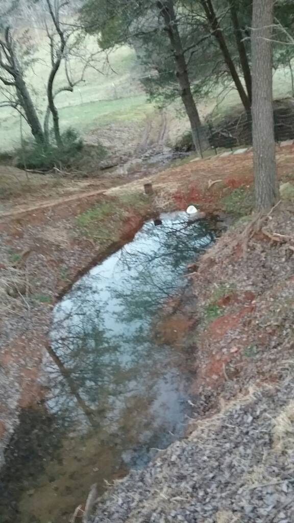

On my place I have a nice spring that empties into a spring fed creek. Creek starts about 2000ft. upstream from spring.
Last Fall I put in a crossing at spring so now it's not so steep driving over that then crossing creek. Also, we put in about 50ft. of 8" PVC pipe, so about 10ft. down to a Y at spring, 40ft. under new road.
Yesterday I capped off the Y and spring filled up overnight. There's about 3ft. red clay packed over pipe for road.
Problem is the one side has erosion...not real bad (yet). We've had loads of rain...when it dries out I want 1-2 tandem loads of rip rap delivered for there and creek crossing. (Creek crossing 2-3ft. then crusher run on top).
My thought is new road-spring crossing is using steel T posts 3-4 ft in ground about 3ft spaced, wire fence strip (so 2-3ft) along them then stone.
Sorry for the long rambling post, hoping pictures will explain. Any advice, changes, thoughts appreciated.
First two pictures show start of and other end of spring. Next 3 are outlet of overflow PVC and erosion. Last two is where it fords creek near spring.

Until it dries out I wouldn't worry much. Rock is what you need for the overtopping period. Hay would just wash away. There is a product with straw weaved into it with line similar to a fishing net. We use it on steep slopes where we repaired a wash until grass can become established. The straw weave has big metal u shaped staples that hold it in place so the wind doesn't get under it. It's wonderful stuff but not good for a road with traffic on it.
We use rolls that are 8 foot wide and probably 75 feet long. It's not heavy one person can carry it and it can be cut easily and rolled overlapping the last run.
I'd start with one tandem truck of rip rap, it covers quicker than you think.. I'd cover the top also with rip rap (90 pound) and use rail road rock (4inch) on top of that. Everybody calls the rock different names. 90 pound rock is a little bigger than a foot ball on average, and up to a basketball.
That 4inch stuff is great for roads, we have even used it on primitive boat ramps, once it's packed down it's there, even wave action doesn't bother it to bad. But it is ruff at first and can be like marbles on slopes if it's laid deeper/thicker than 5-6 inches, but it will settle down too after some time and traffic.
Good luck..
/ Creek/spring/erosion thoughts? #3
It looks like you could use an outlet structure and some rock armoring. Don't bother with the t posts and the fencing. That sounds like a sure way to make a mess. An outlet structure would give you a controlled release rate as the area fills up.
Maybe I am getting ahead of myself, what are you actually trying to accomolish? I get the part about fixing the erosion, but impounding the water and not giving it an outlet is going to possibly keep giving you problems.

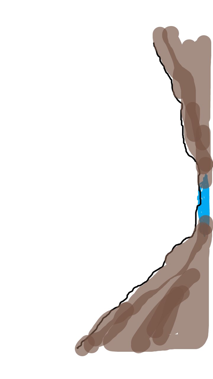

Maybe pictures and drawings will explain better. The way it was is I had to drive down a steep pasture then cross creek then go uphill about 10-15 feet up to another pasture that's fairly level.
Driving down the steep pasture when I got within maybe 100 ft. from creek there was a spring to my right...very deep over time, two HUGE maple trees at start then down 20 feet or so to a rock bottom, spring flowed into creek in a ditch about 5-10ft wide, about 15ft deep.
First drawing is areal view of how it was. A dirt road...creek shown as blue.road1.jpeg

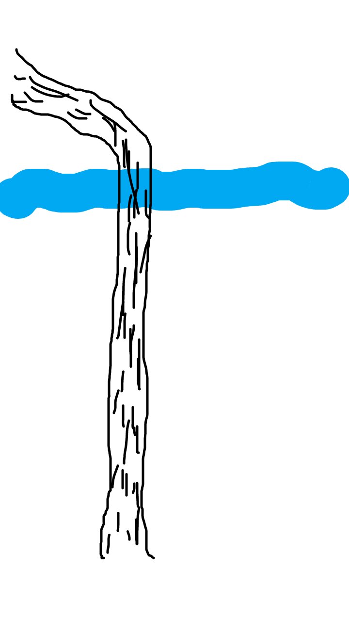

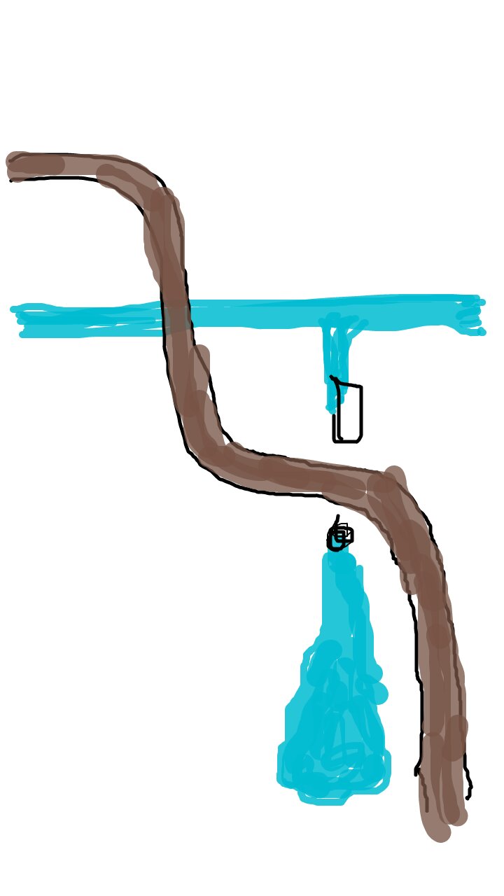

Now again...top "areal" view of how it is now. Drive the other side of spring isn't so steep, turn left going across dam, then right to cross creek. Dam makes it less steep driving as well as a reservoir for the spring. Spring has an overflow going under dam. Dam is about 12 ft wide, 5 tandem loads of red clay fill.road3.jpeg

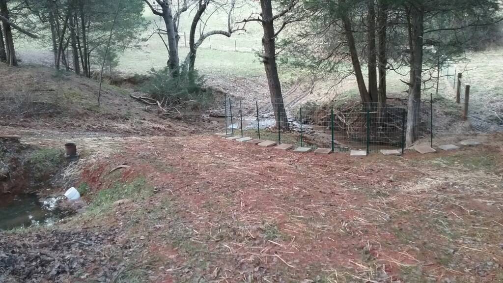

Now pictures. Yesterday I drove T posts every 2 feet as you see, about 3 feet into ground. Then I took wire fence and bent a foot out at 90 degrees, put over posts, 12x12 concrete blocks placed on wire.
Now I want to put rip rap when it dries out on dam...one layer, then downhill and a lot in the creek. My idea of fence, wire, posts is stop erosion? Water will slow down coming down hill I'm hoping.
How far should it be from overflow to top of road on dam? Right now it's well packed, and about 18" water to road top.20190106_171028.jpeg20190106_154641.jpeg
