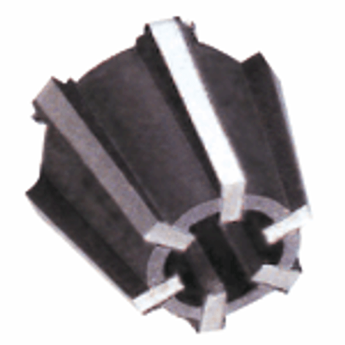

etpm: if you're looking to fab up a crimper, I wonder if something like a Jacobs type rubber flex collet would work forced into a mating taper?
Not sure you would get enough travel or if they would hold up but they are hardened, rated to exert substantial pressure, and are readily available in many sizes. You even could do staged crimping moving to progressively smaller collets with the same number of teeth
