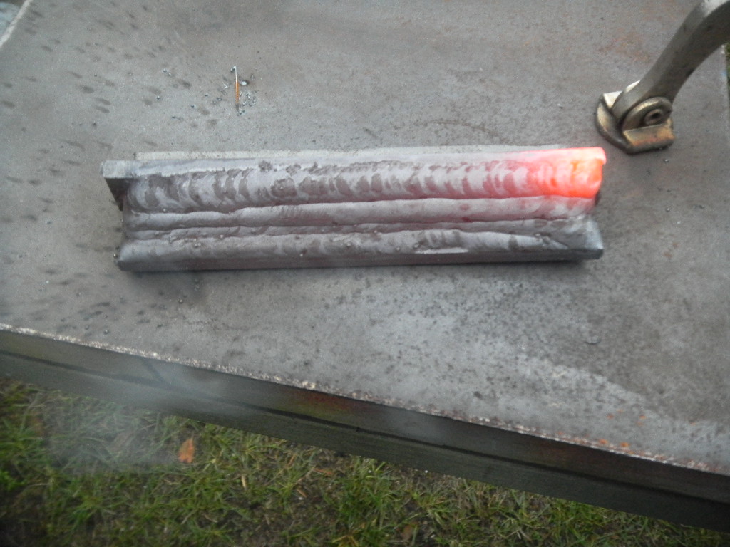

Like everyone else said, grind it out some, and shove a 3/32 stick down deep with the current turned up. Make multiple passes chipping out the slag and perhaps cleaning with the disc if needed. Perhaps use 1/8 on subsequent passes, cook it hot! 5/8 is thick.

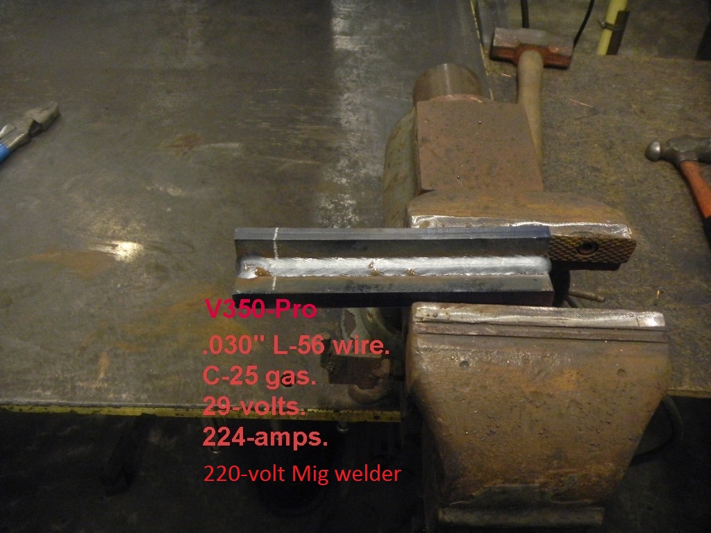

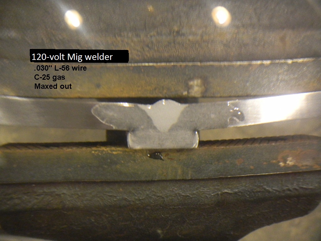

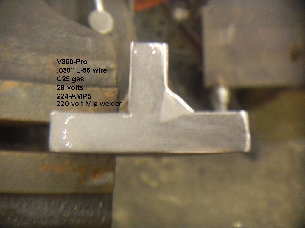

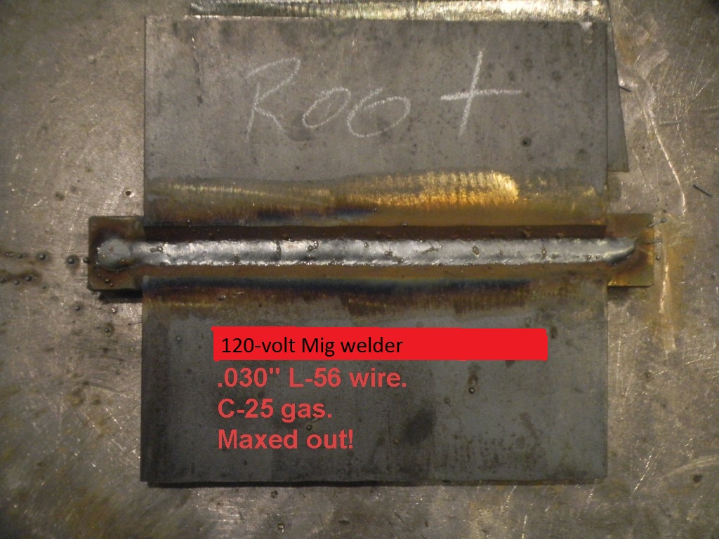

Evan03 I did some etching of Mig welds. First two pictures are of what a 120-volt Mig welder can do. The third and fourth pictures is what a 220-volt Mig welder can do.
