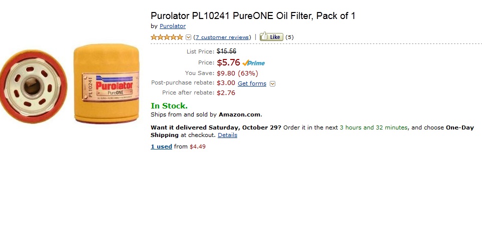

Guys,
I have cross referenced the filters for my Boomer 3040. These are the filters I am looking to get for the tractor.
New Holland Part SBA340500920 (Hydraulic filter) = WIX 51536
New Holland Part 87415600 (Oil filter) = PUROLATOR PureOne PL10241
New Holland Part 87300178 (Outer Air filter) = K&N E-4961
Question 1 - Does anyone make a good hydrostatic filter?
Question 2 - Has anyone used these types of oil filters and is there any issues I need to be aware of, such as oil flow restrictions?
My neighbor owns an auto store and has been using Fram oil filters for the last eights years on his TC40D.
Thanks for the time!

Eagle, of all the filters on your machine, the HST filter is the only one I would never suggest getting from a 3rd party supplier. The HST filter can experience pressures over 250 psi due to cold fluid and the charge pump having to send fluid up through the cooler and then back to the main HST internal pump. Because of this, that filter is heavier. Even New Holland has a normal and ruggedized filter for areas with very cold winters. These filters have a high pressure seal and are installed very tightly (more than the 3/4 turn after contact is made). Therefore, I recommend you stick with the NH brand for the best HST filter performance.

Yeah, the HST filter was my biggest concern. I had our Buffalo Tractor dealer tell me that some of the HST filters had problems on the NH tractors during the winter time. I cannot remember if it was the SBA340500990 or SBA340500890 filter that had the issue. Since NH replaced the two filters with the SBA340501030, I was just wondering if anyone had a direct replace; it seems like a very specialized filter.
As for the other filters, I got them and will give them a try. The only another filter that concerns me is the Purolator PureOne PL10241 oil filter. The filter has a lot of filtration so I hope it does not restrict oil flow. However, I guess if there was a problem with the filter, Purolator would have pulled the filter a long time ago. If anyone has used the Purolator PureOne PL10241 oil filter, please let me know.

Not sure if you were trying to buy any filters from WIX directly. I just go to Amazon, go to the automotive section and type the filter number in, or you can just query the filter number on Google.
