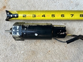

I am no mechanic, however, I am somewhat mechanically inclined. My layman's opinion leads me to believe this tractor will not run due to lack of fuel. With that being said, I removed the confusing, FIVE (5) WIRE 'fuel shutoff solenoid' - (see attached picture). Once removed, and still connected to the electrical system, when power is applied via the ignition key being turned-on the solenoid retracts (pulls-in); however, it releases in approx 2-3 seconds. It seems to me that the solenoid should remain retracted (pulled-in), thereby allowing fuel to flow. The failure of the solenoid to remain "retracted" leads me to believe that the "hold" part of the solenoid is not working? - (very possible I am wrong). Maybe the solenoid is good, but the signal to keep it retracted (pulled-in) is malfunctioning. I considered applying a jump-wire to the solenoid to see if it would remain in the "hold" (pulled-in) position. However, I have not done that yet because I am fearful of damaging the solenoid! I was SHOCKED to learn that the solenoid cost ~ $1800....ouch!!! - (shame on New Holland!).
For testing purposes, does anyone know how this five (5) wire solenoid functions? - [there are 3 wires in one cluster (black, red, yellow), and then 2 wires in the second cluster (both black) - see attached photo. From my on-the-tractor testing I learned that when the solenoid is energised via the ignition switch, it is the two (2) black wires that activates (pulls-in) the solenoid.

Hopefully others will reply. Your description of the fuel solenoid does lead to some concern. However, I have head of solenoids the use a circuit to initially pull the plunger back and another circuit to hold so that might be what yours is with its multiple wire.

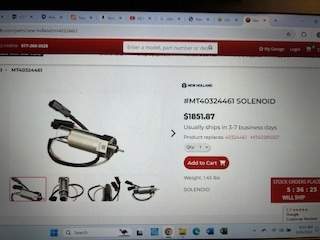

Williy - Thank you! Yes, I also saw solenoids priced online for a lot less. Unfortunately, I saw no after market 5-wire solenoids that would work on this New Holland - (my layman's opinion). On YouTube I saw mechanics buying OEM solenoids for John Deere, Bobcat, and Massey Ferguson for less than $300 each, unfortunately not New Holland. See attached photo, from Messicks tractor parts, $1,851.87. Thank you. GBL

   / New Holland (Boomer 37) - will not start #8
That price on the solenoid is insane!
I'd really like to know why New Holland chose to use something like this when for decades, themselves as well as other manufactures have used a similar functioning part for a fraction of the cost.

If the solenoid unscrews, remove it but leave it hooked up incase the ecm reads its position..
I’ve never seen a 5 wire s/o solenoid.. I’m wondering if it’s not a “rack actuator” that varies the voltage to move the fueling mechanism to control fuel/rpm.??

thepumpguysc - Yes, I did that. I unscrewed the solenoid and left it electrically connected to the tractor's wiring harness. When the ignition key was turned to the "on" position the soleonoid would pull-in (retract), however, it would not "hold", it would release and the solenoid pin would pop out in ~ 1-2 seconds. This leads me to believe the solenoid is bad, or more likely, and hopefully so, the solenoid is just not receiving a "hold" signal to keep the pin retracted. Thank you. GBL
   / New Holland (Boomer 37) - will not start #11
I don’t think it’s made to “hold” without the engine running..
I take it from your test, u only turned the key “on”.??
   / New Holland (Boomer 37) - will not start #12
If it does the same thing with the engine starting ..
I believe there’s a relay that the power switch’s thru..
Or it could be a safety switch/sensor that’s telling the solenoid to shut’r down.??
