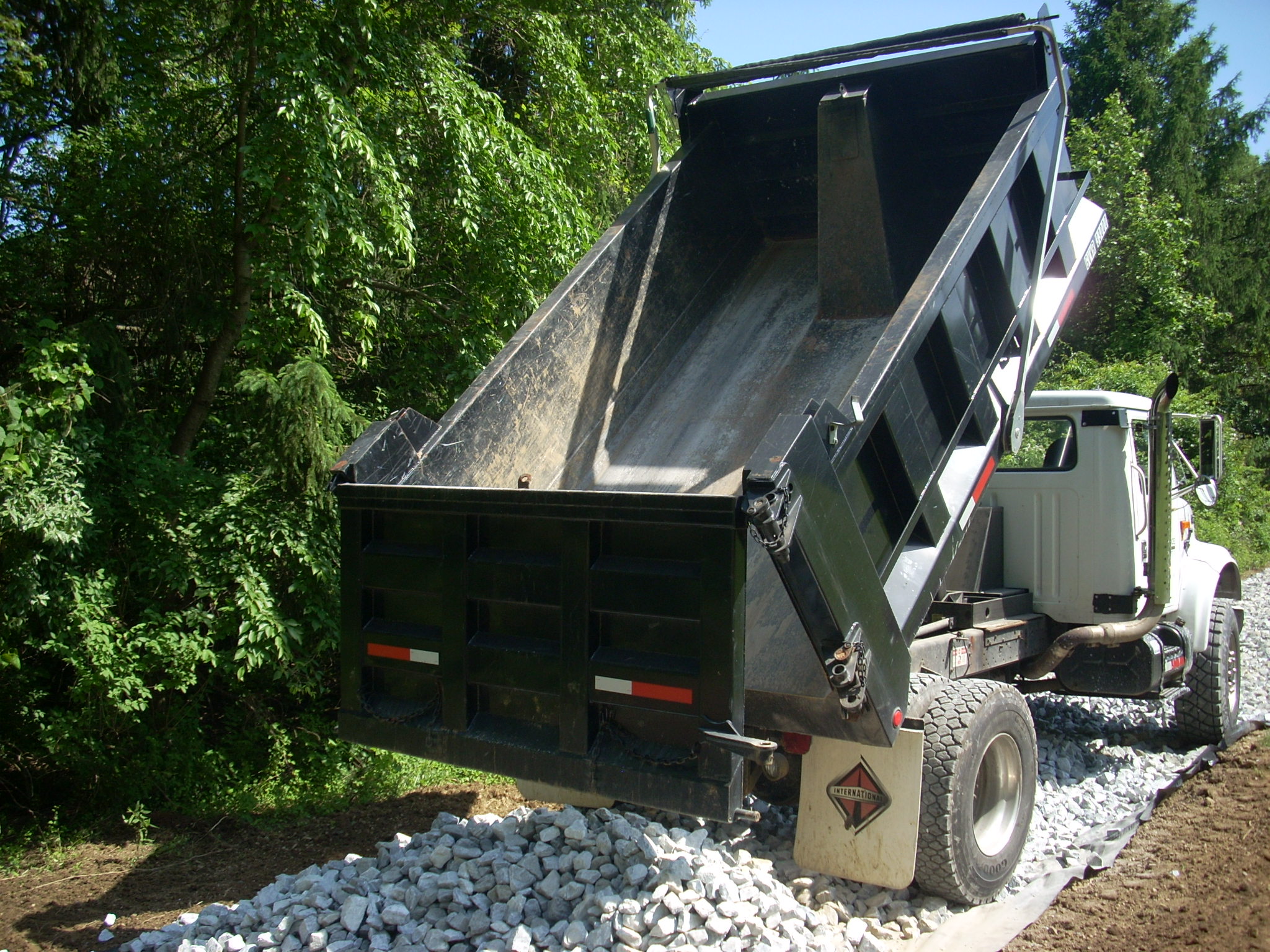

I'll be starting with 100-150 yards of wood chips after 4th July weekend and the 100 tons stone thereafter.
Hopefully the stone can go through the right of way instead of over the bridge. I have a 4WD dumptruck perfectly suited for the task.

Now that is something I don't see every day. OK, I have never seen a 4wd dump truck like that. That is cool.
