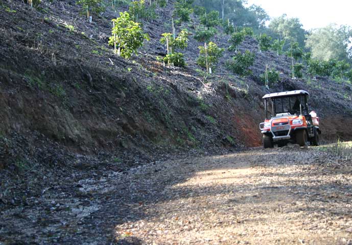

You can see from this picture what is happening. During rains, the slopes gradually deposit dirt at the bottom which pushes the water towards the center of the road. This particular road is graded toward the inside slope. The dirt builds up more than I can tilt my box blade as my tires ride up on it. The same thing happens when I try to use the FEL. The problem is that I don't have an implement wider than the tires.
I took all the great advice everyone expressed and pretty much convinced myself that I need a heavy 6' blade that offsets so I can get it out past the tires and bring the dirt back to the center where I can deal with it.
Local dealer suggested a Gearmore GB60. Gearmore PDF and priced it at $885 plus tax (ouch). What do you think... should this do the trick?

That blades looks like it might do the trick, it weights 360 pounds which is good and up to 50hp tractor. Does that blade pivot at that center pin so it will stand up at 45 degree angle? I guess it does, it says it does anyhow. I would look for a good used blade myself and if I didnt find one I would get the new one. I love my Bushhog model 60-06, I bought it used for $450 and love it! Wonder if it has greese fittings for the pins? If not just keep oil poured on the pins and slides so it will spin easy when you adjust it.
