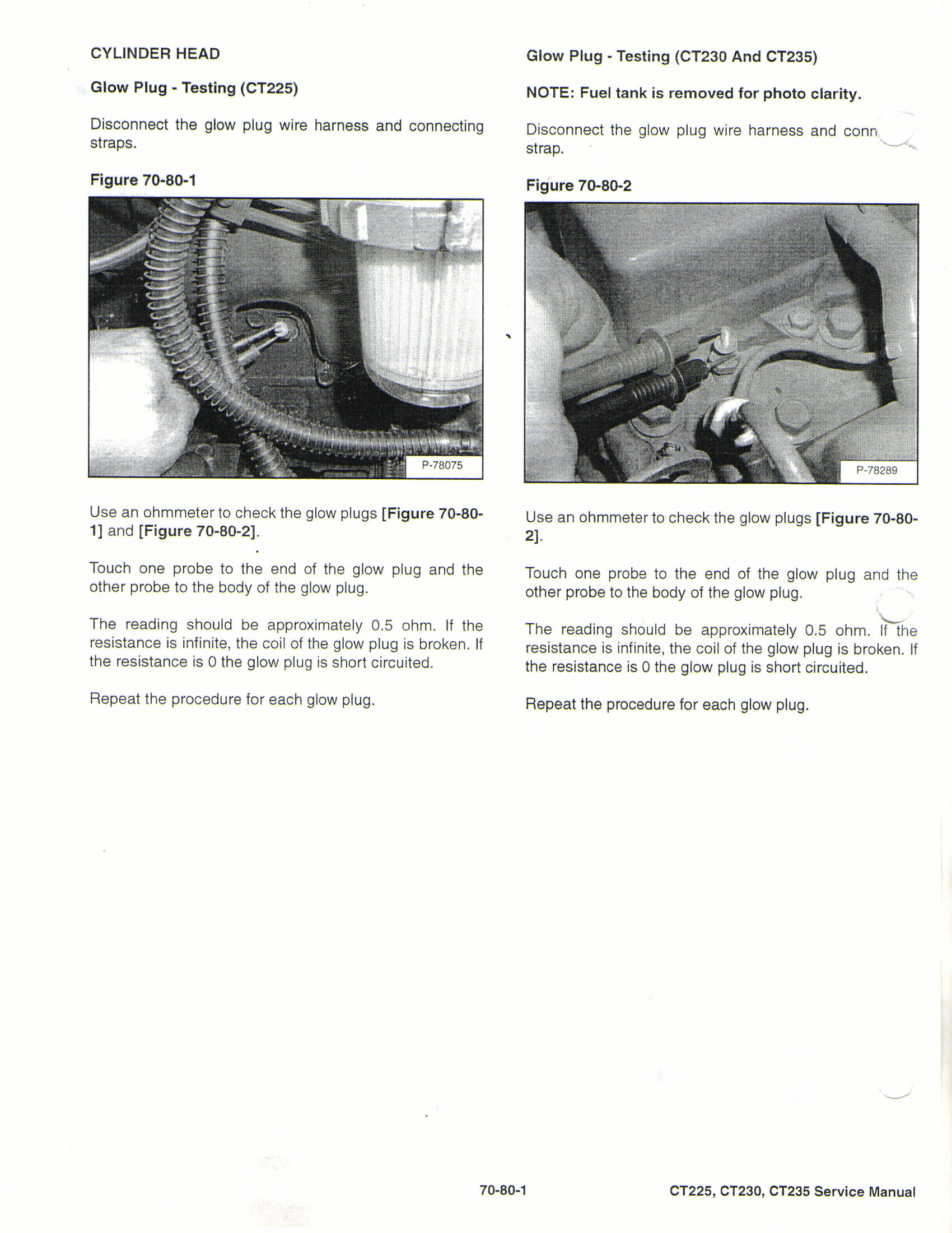

It is about 32f here at 4:40am, just went out and activated glow plugs, light stayed on about 13 seconds. Mine is a 2008.
Thank you for the manual instructions.
I worked at my City's Municipality.
We had alot of diesel machines.
I guess that's where I got the 5-10 seconds on the glow plugs.
I'll head out today to check mine.
Thank you again!

My glow plug lite on the dash does not go out.
I held it for almost 50-60 secs.
Then tried to start the tractor.
It still did not want to start.
Finally did.
   / CT 225 Getting Worse trying to start in winter. #16
time to check your glow plug circuitry.

JUST wanted to UPDATE!
Finally got my glow plugs!
Installed yesterday, my 1st time!
Replaced all 3.
Went out and turned the key, light goes on, lite goes off! FIRED like she was supposed to!
Thanks very much for your input!
Great forum here!
