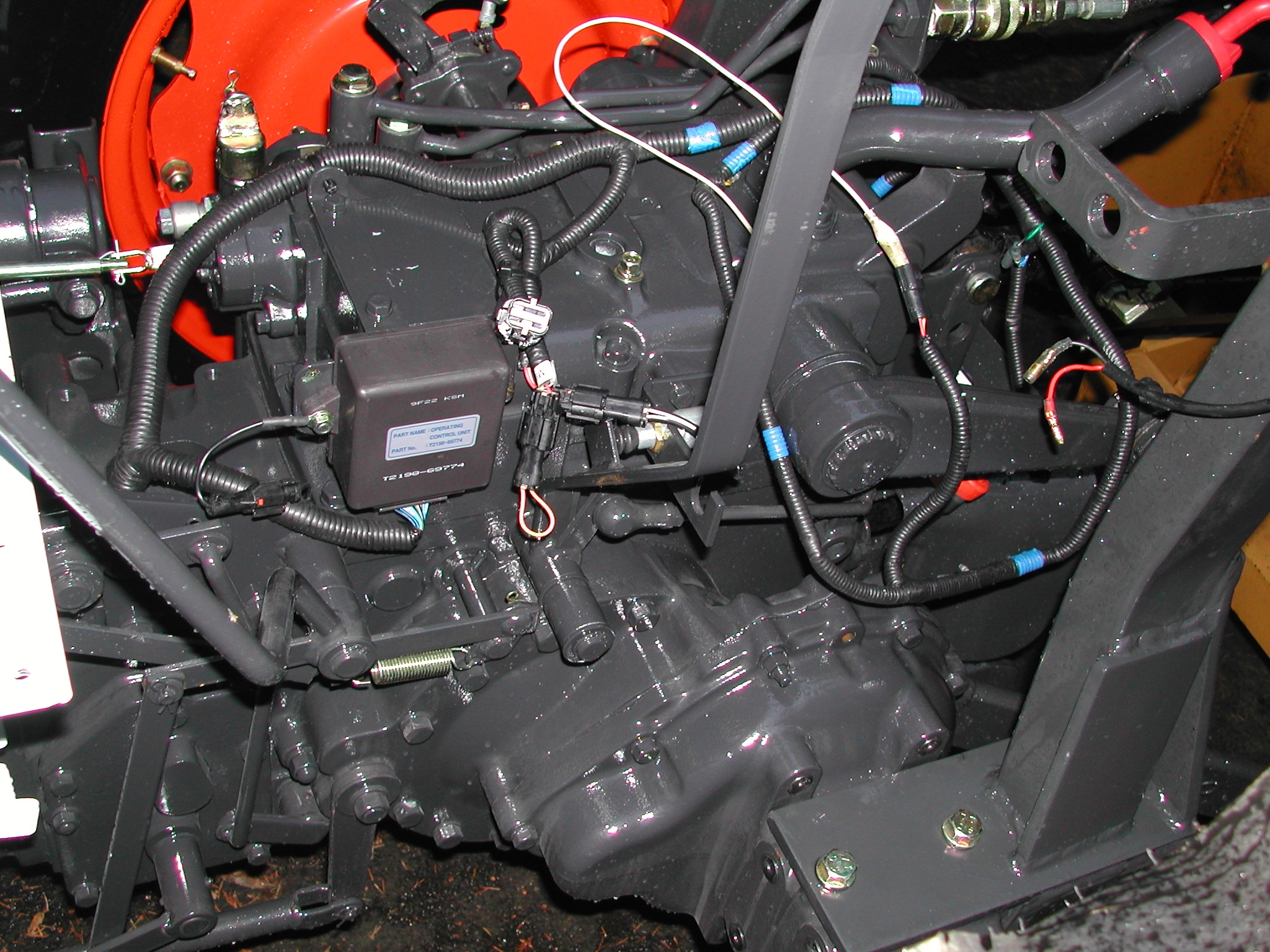

Ok, so you are not getting voltage to the solenoid when this happens until you turn the key off and then back on again. That would almost indicate the ignition switch could be at fault. Or operation control unit.
   / Ct 230 won't stay running #14
This is the "Interlock Control Unit", which is specific to Bobcat, not Kioti, I believe. Photo is from my CT230 that I bought new in 2010.
What does the service manual say?
